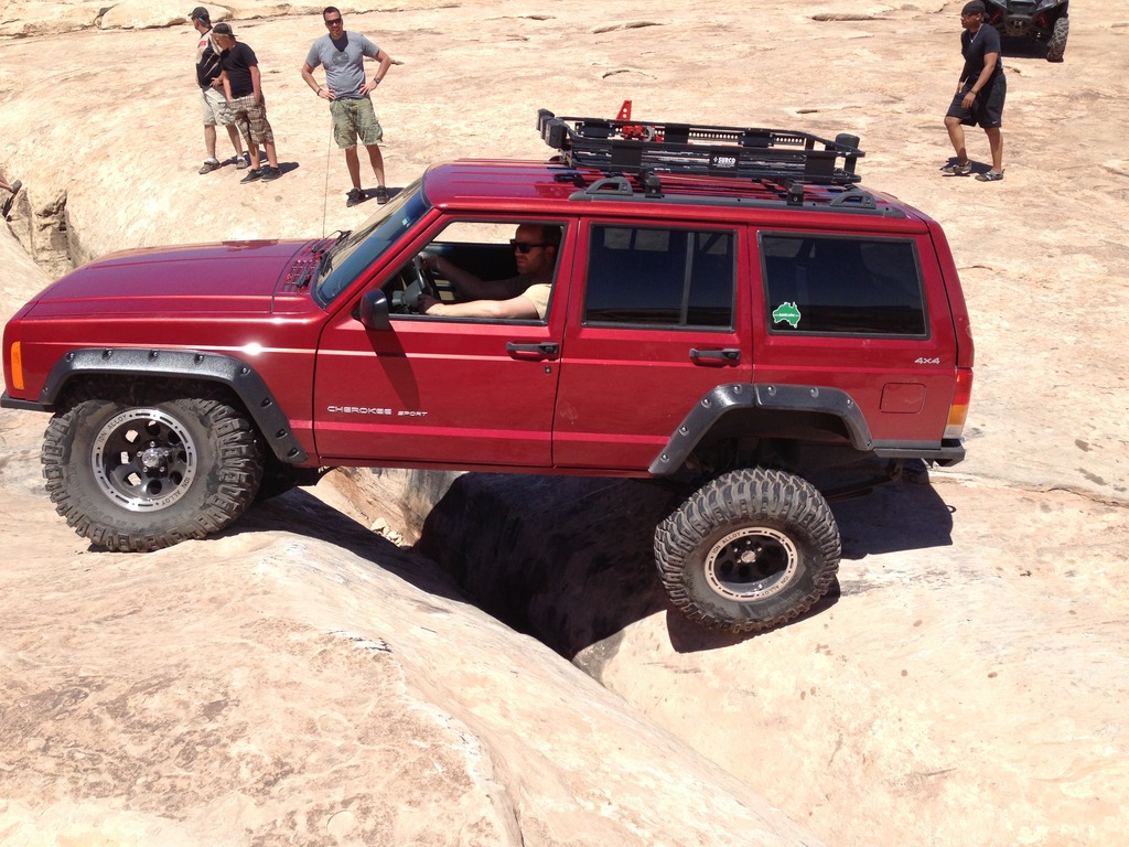

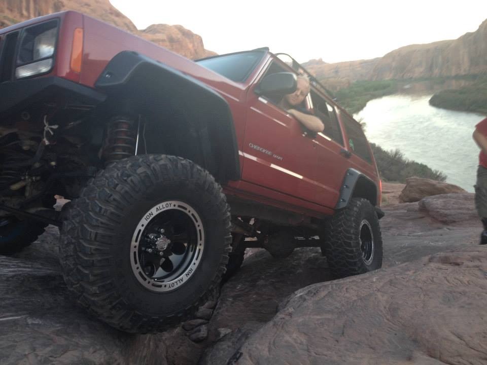

After 3 seasons of great wheeling and mild building on my 99 XJ, I had the chance to score on a deal I could not refuse on a 2004 TJ Unlimited. I bought it with high miles, but it runs great now, and with he price I got it, I could replace the motor and still be WAY ahead. I loved the Cherokee's low center of gravity and great flex. Our family frequents Moab about 4 times a year. Now that my oldest son has an XJ of his own, it's finally practical for me to use a 4-seater rig for my wife, 2 other kids and me. A JK is just too far over my budget. The XJ was very practical and cheap to work on and fix-up, but I kept tweaking the unibody so bad it was starting to get pretty tough to open up the hatch or any of the doors. Plus I have always dreamed of a CJ 6, and ever since the LJ came out - that was my true wish for a reliable wheeler with a great wheelbase. I got a good offer for the XJ so I took it.

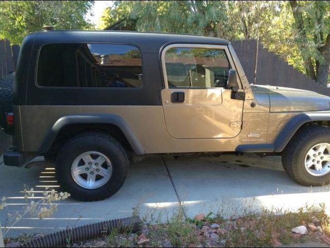

Here's the LJ when I bought it. I should take some interior photos. That's where she really shines.

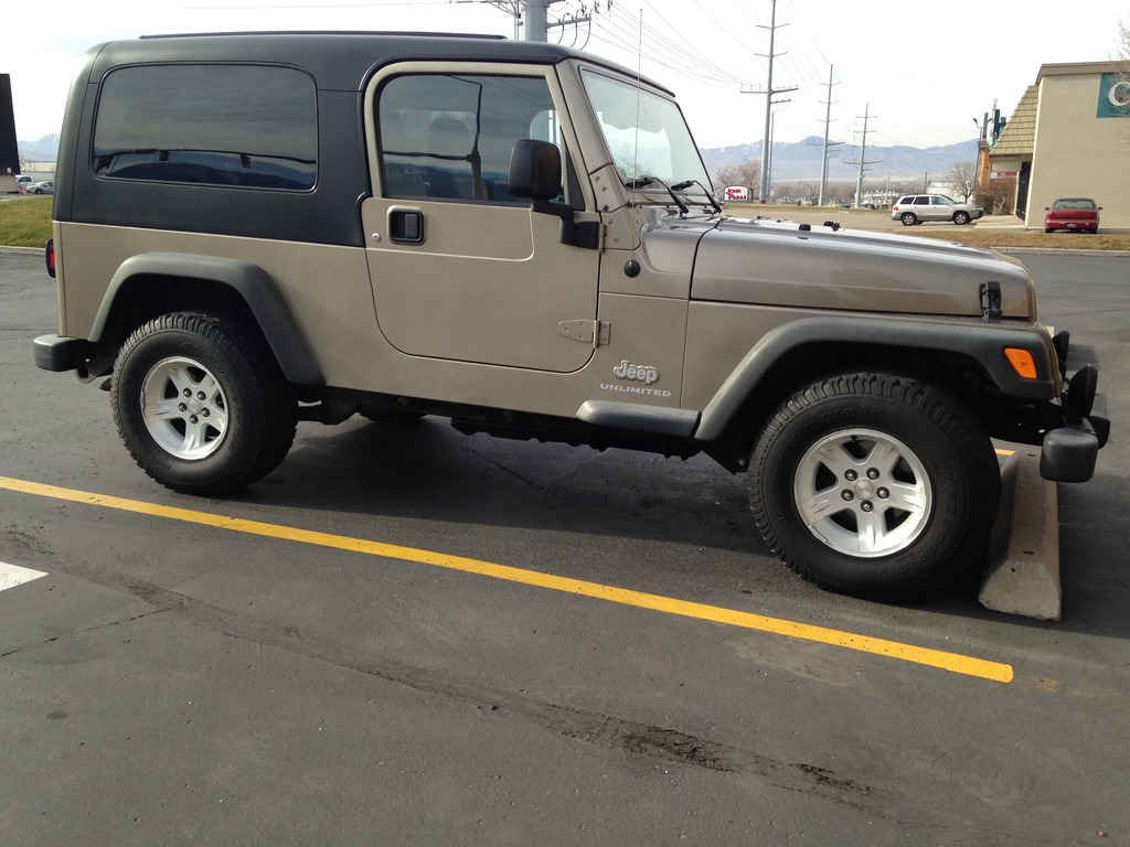

At least they aren't sticking out so far, but I had to do something because I was sitting so low, I would rub pulling in my driveway, so I added some pucks up front to get me by.

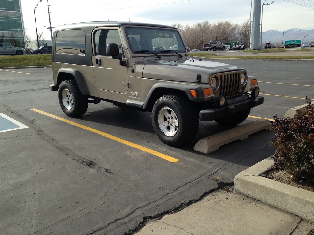

Next set of budget modifications was to trim the front bumpers and the fender flares. And my son plastic-dipped my headlight bezels for me. I hate chrome. At this point I also added some 2" BDS coils int he front, and 2" pucks in the rear. I left the 2" pucks in the front, and plan on leaving it that way, for a while at least.
I took it up the hills in my neighborhood to do some testing to see where I rub before our April trip to Moab, and it looks like I'll need about 1 more inch of bump stop to clear 35's. When I move to 37's, I will probably just do a 1" body lift. But I'm in no hurry, I'll just take the great deals as I find them.
Last week I pulled the rear pucks and added some Crown Vic springs in the rear. It was pretty straight forward. Cost me about $40 at the junk yard. They ride fine, but I need to get new shocks stat! I am topping out on most bumps down the road. Those will be next, hopefully before Moab, because these stock shocks are severely limiting my droop. Here is how it sits now, netting 3.5" in the front and 3" in the rear.

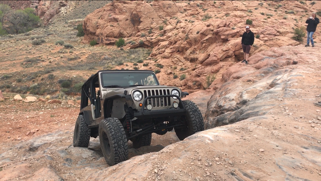

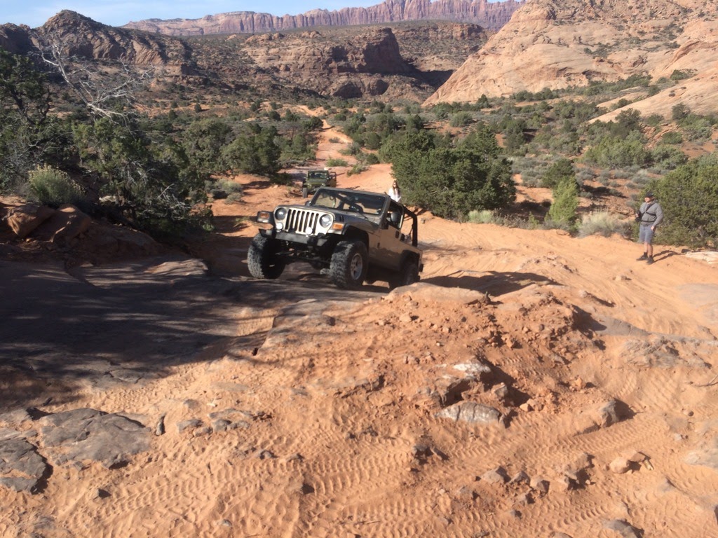

We also had our first trip to Moab with the new LJ. I didn't do any thing really extreme but I was impressed with how well it handled. First day was pretty mild on elephant hill, then we spent the second day on steel bender.

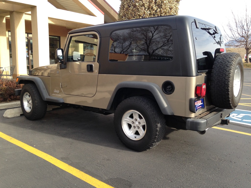

A guy offered me $850 for my tires and wheels, and there was a brand new set of 35" Maxxis Bighorns all 5 mounted on these random alloys that I picked up for $750. They stick out a little too much for my taste. If I find a good deal on some rims with more bs, I'll pick them up, but I'm in no hurry. The stance doesn't bug me that much.
I used the extra $100 from the tire swap and ran over to Teraflex and picked up a 1" body lift to give me the same clearance under my fenders. This should be the top end of my lifting. I'd like to keep it low.
After the 35s and 1" BL I maxed it out to check my fender clearance to make sure I don't run in to issues when I go wheeling. Looks like 2 hockey pucks are doing the job. I will replace my factory bump stops with some Daystar polly replacements. The factory ones might as well not even be there. The squish as easily as an empty water balloon.
