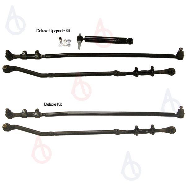

Steering upgrade
I've been staring at my tie rod for 4 years now and thinking, "Why would Chrysler build a Jeep Wrangler with a hollow tube for a tie rod?" I had a 97 Grand Cherokee and the tie rod on it was much heavier. Plus the tie rod ends were much beefier on the GC as well. I did my research over the last year and found that not all is as it seems when it comes to tie rod upgrades.
For instance, one company's tie rod is plenty beefy but received bad reviews due to up and down play where the drag link attaches to the tie rod which creates a steering delay or flat spot in the steering which seemed dangerous to some of the reviewers. The other company I found has a great reputation and they charge accordingly.
Now I think a lot and my thinking is that as big as some of these companies are, they don't have the R&D budget that Chrysler has. So I found Omix-Ada's entry in the upgrade game.
There are two offerings for TJ's; the Deluxe and the Deluxe Upgrade. The upgrade includes a steering stabilizer. I found a Black Friday sale on the Deluxe Upgrade for $141.00 and pulled the trigger. Two days later it was on my doorstep....

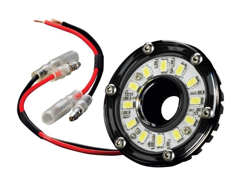

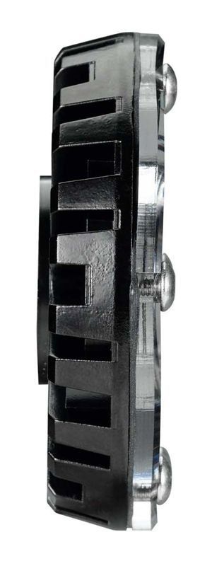

Cyclone LED by KC HiLites
So I'm on Facebook one day and I see these lights installed in a Nemesis Industries Rocker panel and I thought they looked cool. And the. A light went on...rock lights. This is the Cyclone LED light
Tiny little lights 1/2" thick and 2" diameter.

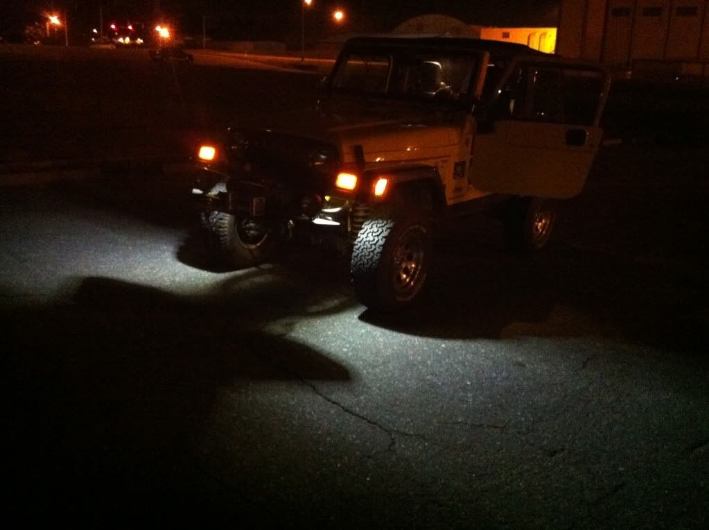

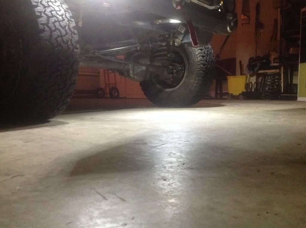

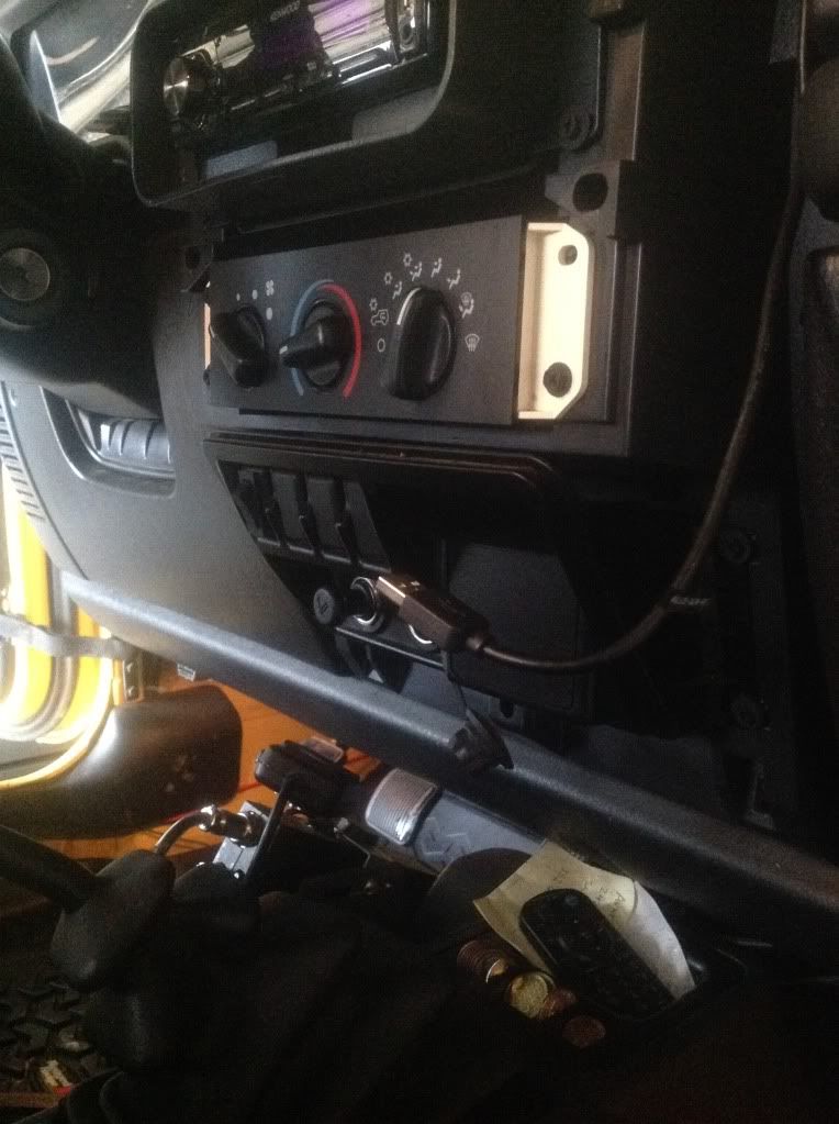

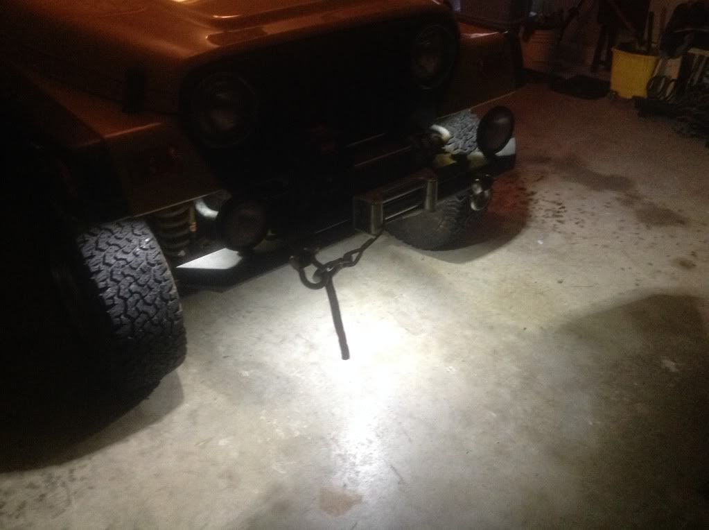

So I picked up 4 Cyclone LED's from KC HiLites for $20 a piece with the intent of using them as rock lights. I also ordered some new light switches from Amazon.

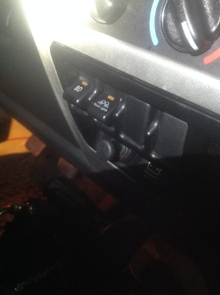

I originally used a rocker switch I picked up at Radio Shack for my fog lights.
Once I bought the Rigid Industries LED's for the windshield, I wired them to the rocker switch and put a factory fog light switch in place of my turn signal switch which didn't have a fog light position. The new switches I ordered look factory and fit perfectly where the blanks were.
As for mounting the lights, I figured out the front easy enough. I utilized the front middle fender mount bolts so the light shines out and slightly downward.
They are bright!
This was taken in my garage
And then tonight

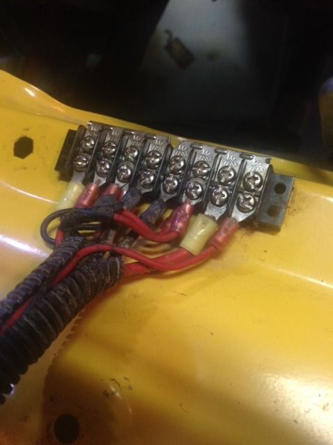

While wiring these, I put a terminal block on the inner right fender so that when I figure out where to mount the rear lights it'll be a simple job to attach the wires to the terminal block and not have to add another switch or relay. I'm using the same power source for relay control so it is a fused switch. The power for the lights is also fused through the non existent rear window defogger circuit.

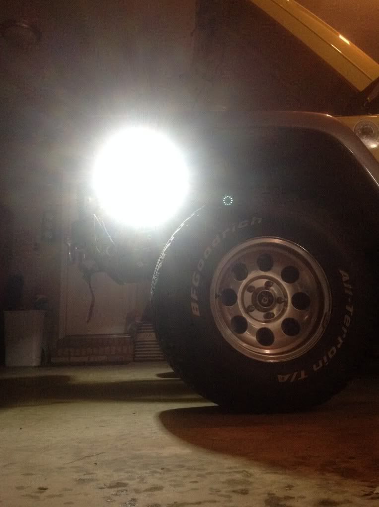

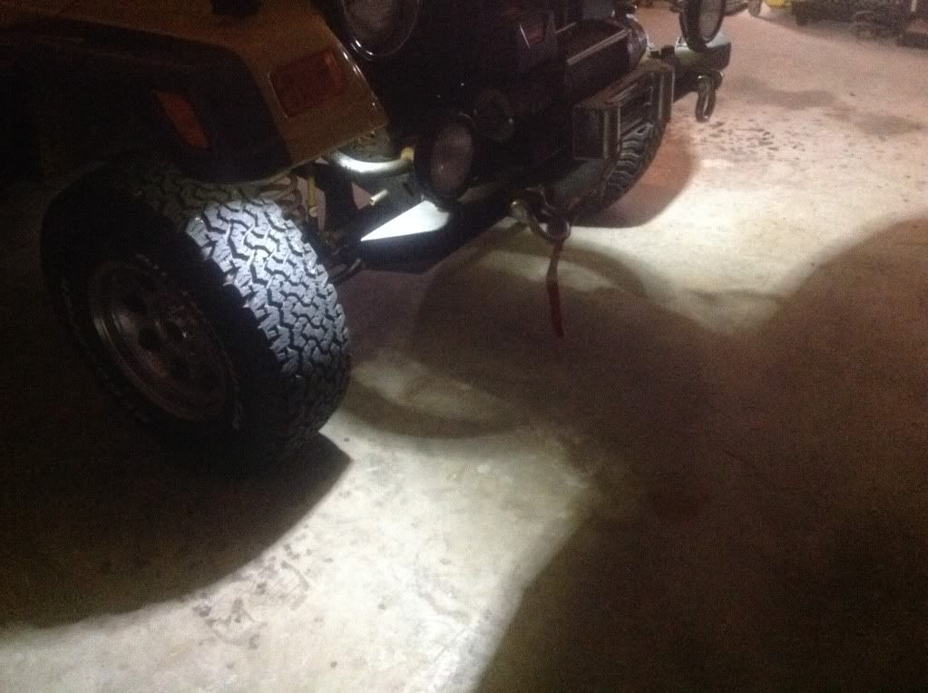

You'll notice in this pic the big shadow in the middle front. Not quite what I was after
So I added one more light to the front. It actually is mounted to the body mount bracket on the frame. Plenty of protection around it
And the shadow is gone

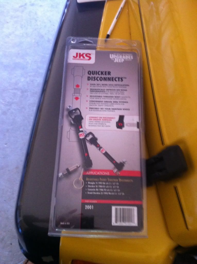

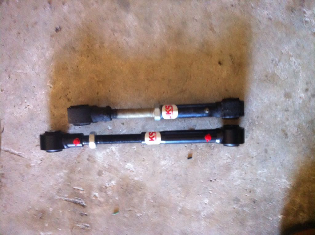

I bought JKS disconnects back when I had a 2inch budget boost. They were the shorter ones and the maximum length for them was 9 and 3/8 inches. I had to adjust them longer when I lifted to 3.5 inches but the swaybar was only at 1.4 degrees up. (Needs to be 10 degrees +/- 5 degrees according to JKS and 10 degrees per the FSM)
enter the JKS 2001 disconnects.
they are adjustable to 11.5 inches and after installing they are adjusted to 11 and 3/8" to give me 10 degrees up on the swaybar. You can see the full 2 inch difference in the links.

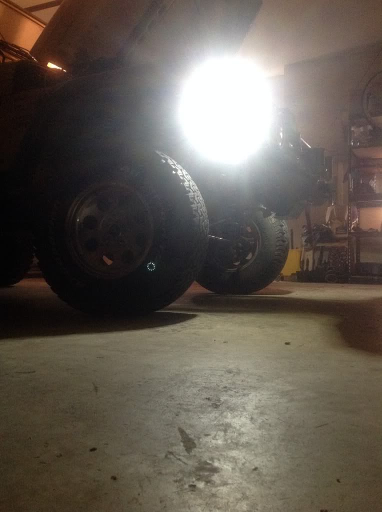

After installing three of the four KC Hilites Cyclones, I had a friend say she had an extra Rigid Industries Flood light and the price was right. So, now I have a flood light and one cyclone to install.
In the previous post I said I am using the coil power for the relay for a non existent hard top rear windo defogger to control both my rock light relay and windshield relays. I wanted them on separate switches and figure the fuse is strong enough to control both relays. The windshield lights are controlled by the actual defogger relay and the power of course is fused. I needed a fuse on the power leg of the rock lights and installed one last night. Both lights get their power from the two studs on the power distribution center which is fed directly by the battery. So, where to install the remaining lights?
The flood light was a no brainer. Where I had installed the three cyclones up front, I still needed one in the back.
It's mounted in between the two rear drivers seat mount bolts and shines it's beam underneath the rear differential. I cleaned up all the wiring under the hood and down the frame with 1/2" convoluted tubing and the main harness convoluted tubing across the firewall.
All the rock lights are wired to a terminal board under the hood

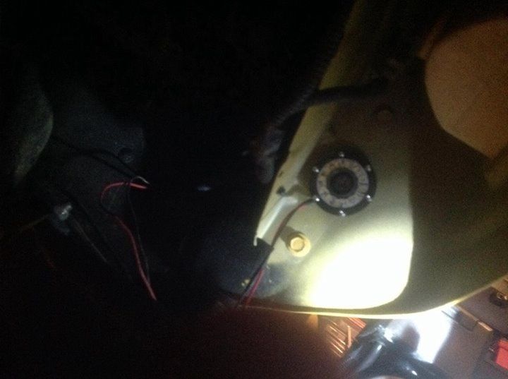

The installation of the remaining Cyclone came to me as I was working under the hood with a drop light and flash light to see. My under hood light has been burned out for awhile. So this morning I removed the light assembly, soldered two pigtails to the contacts for the bulb and installed the light using two rubber grommets to isolate it from ground.
Drilled a small hole at the bottom of the old light assembly to feed the wiring through
And yes, the light does go out when I shut the hood
