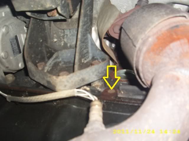

Next locate the two empty bolt holes in the side of the block per the directions. There is one on each side of the block. Not the red one
I cleaned out the threads by running a tap into the holes
The hole marked with a yellow arrow and the matching hole opposite attach to the block

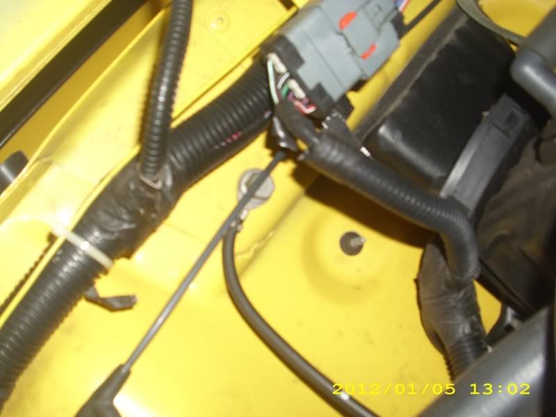

Step one, remove the factory air box
Step 2, relocate the wiring harness and ground per the instructions
Step 3, remove the cowl
The ground wire attached to the firewall is relocated to the driver's side

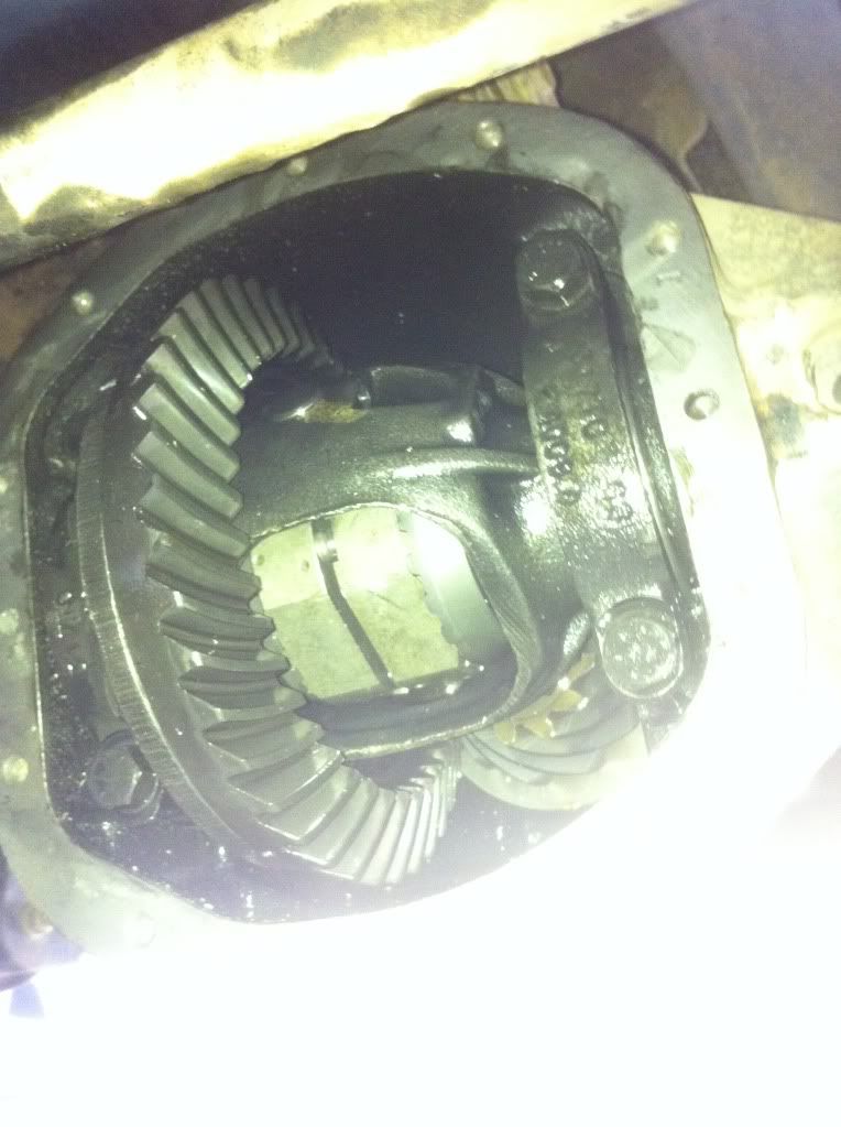

Meanwhile I decided to upgrade a little more. I ordered a Spartan locker for the front. Super easy, super durable. Best gadget EVER!
Here it is installed
It has really great street manners. I don't even feel it there except for a very slight clicking noise in tight parking lot turns and an occasional clunk. On the trail? WOW! Once it has power applied it pulls my Jeep up the steepest hills. I'm still running an open diff Dana 44 in the rear and haven't gotten stuck since installing this
