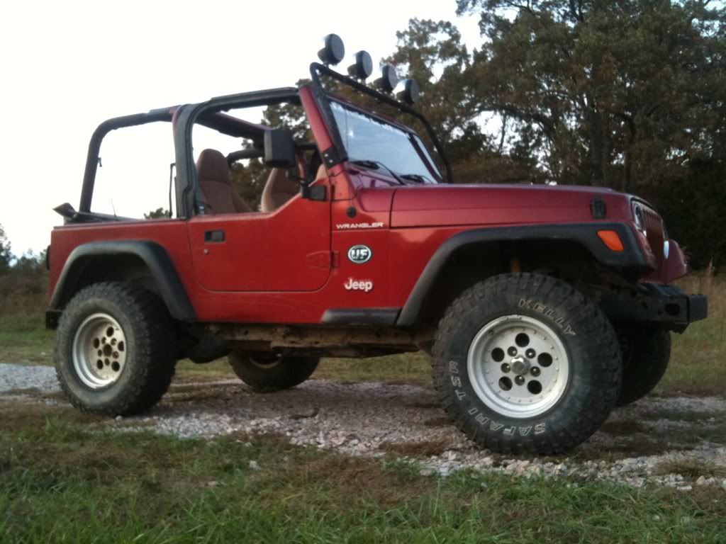

Lift is installed. 2" Rubicon Express without shocks. Still running my 31's. I didn't get vibrations, no steering problems or pulls to one side, and no death wobble.
Before,
After,
I like it. It feels just like when I bought it when it had the 2" body lift but I have clearance and no gap.
