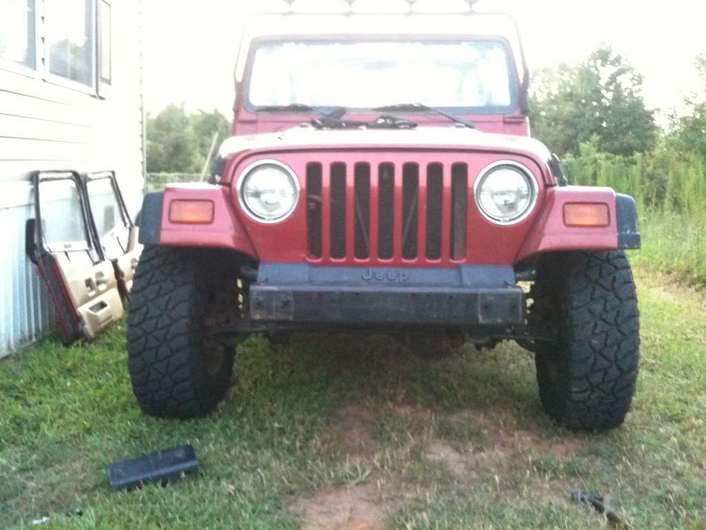

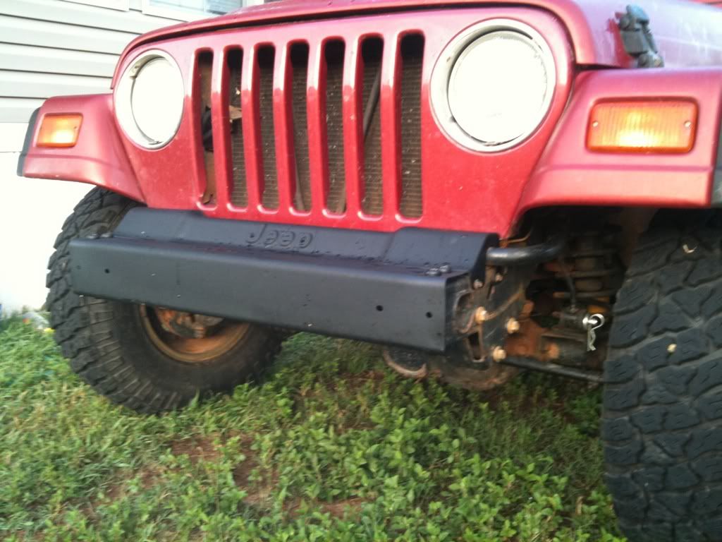

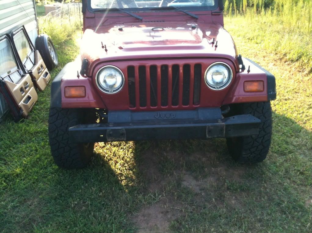

Here's the bumper chop. PO must of hit a tree. Tired of my jeep looking like I'm a bad driver so here she is now;
Before
After
