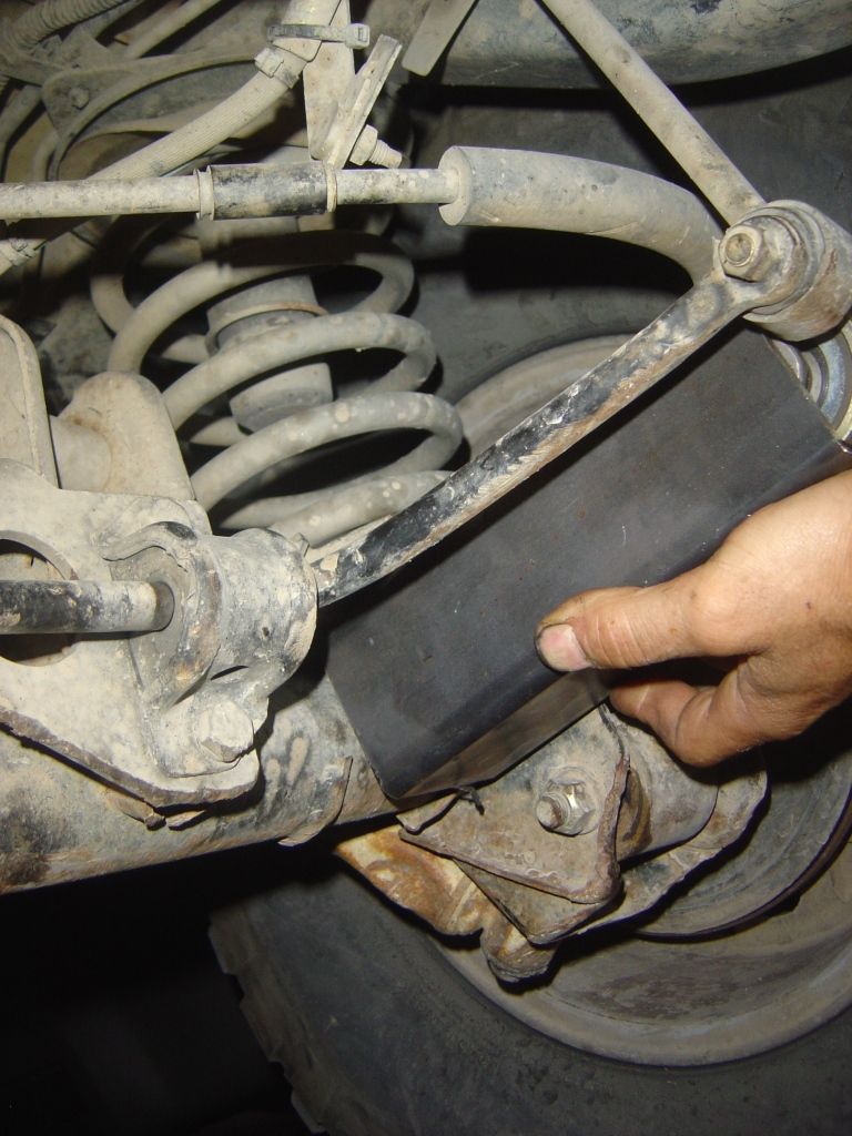

Found me a hunk of steel that would make some nice lower control arm mounts.
However now that the lid is of the worms are starting to crawl out, as you can see when I mount the control arm where I want, the shocks will hang to low, so will have to outboard those. Been meaning to do that for a long time as well as moving the upper spring seats back a tad. Then the front mount point of the tri link wishbone needs to go up about an inch or so, but that may interfere with the fuel lines.
This Jeep stuff is just so much fun.

Posts: 6,140
Looks like a good idea, but that new piece is going to have a lot of stress put on it, especially since it will be dragged over rocks yall wheel in. Some dimple died formed holes on the bottom and a nice big gusset (maybe two) on each side to mount to the axle? .... But I not an engineer or professional jeep builder... Keep us updated.

Made my other Jeep the same way and that one has had the snot beat out of it. My brackets seem to hold up very well and I weld them to the axle tube inside and out. Factory brackets are at the most 1/8 steel and wad up pretty easy as you can see in the pic. Holes in brackets makes em hang up, would take some doing dimple dieing 1/4" steel

I think he was assuming you were going to leave the steel that length. Art I re drilled the holes on mine up an inch 1/2 and I now have a descent AS. Before it would hop, and when accelerating it didn't squat nicely. Now, it does. I just used weld washers and plated the bottom it was free and other then the drilling easy

I remember what you did, I just want them up a little higher.
The only problem is, that I will have to outboard the shocks to to get everything flat with the underside of the axle
