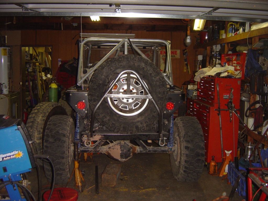

post #783 of 3079 Old 05-30-2012, 05:49 PM Thread Starter
aw12345
Location: ontario
Posts: 7,285

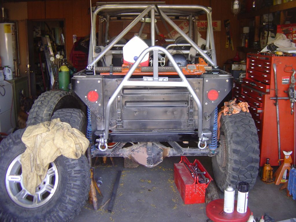

Made a bit of progress today

post #784 of 3079 Old 05-30-2012, 05:58 PM
JJeeper09
Location: Richmond
Posts: 2,190
How it connects to the Clevis mount is that permanent? Because i like the idea I would just go on both side. I need a tube bender, this is exactly what I'd like to make

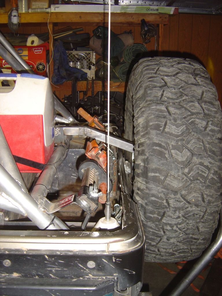

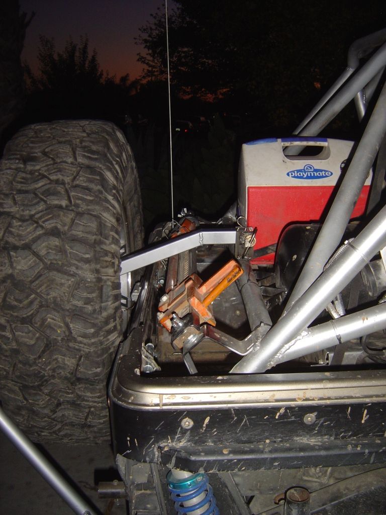

post #785 of 3079 Old 05-30-2012, 07:59 PM Thread Starter
aw12345
Location: ontario
Posts: 7,285
One side is plenty strong I might taper the tube at the bottom and plate the hole shut. Made the upper mount, now just 2 plates on the cage so I can pin it in place. Finish weld it and clobber some paint over it and call it good

post #786 of 3079 Old 05-30-2012, 08:02 PM
JJeeper09
Location: Richmond
Posts: 2,190
I like it. Are you going to get bolts to fit so it doesn't rattle loose or is it pretty stout as is.

post #787 of 3079 Old 05-30-2012, 08:11 PM Thread Starter
aw12345
Location: ontario
Posts: 7,285
I may copy
The shackles should be fine as pivots ones you tighten them you kind of squeeze them together which keeps them from loosening. Otherwise there is always red loctite.
The upper mount goes through the tire and to the cross bar of my cage.
Don't really care for the batwings on the genright setup

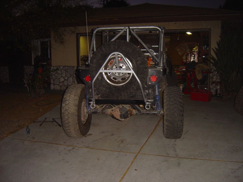

post #788 of 3079 Old 05-31-2012, 10:26 PM Thread Starter
aw12345
Location: ontario
Posts: 7,285
Just needs some paint and I need to make or find a nice lynch pin

post #789 of 3079 Old 06-01-2012, 05:20 PM
B2CARPEN
Location: Northern Illinois
Posts: 3,580
Art that looks fantastic! I am not a fan of rear mounted tire carriers but that looks very clean and solid. Not bad at all, very nice work!

post #790 of 3079 Old 06-01-2012, 05:34 PM Thread Starter
aw12345
Location: ontario
Posts: 7,285
I definitely like it. Much easier to mount a big tire and it actually lifts up pretty easy.

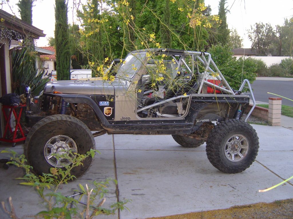

post #792 of 3079 Old 06-01-2012, 11:36 PM Thread Starter
aw12345
Location: ontario
Posts: 7,285
Thanks guys, was a fun little tinker project
Got er all painted up and had to try a bigger sneaker

post #794 of 3079 Old 06-02-2012, 12:39 AM Thread Starter
aw12345
Location: ontario
Posts: 7,285
Ditch the flares...
You are persistent aren't you, with the bigger tires the'll have to come off

post #795 of 3079 Old 06-03-2012, 11:57 AM
JJeeper09
Location: Richmond
Posts: 2,190
What are you mounting them on
