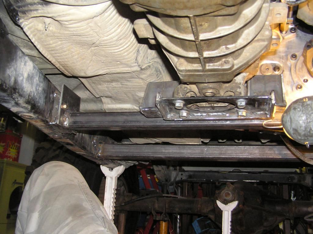

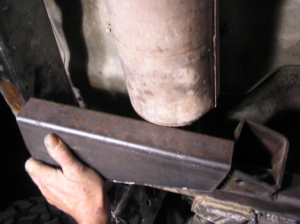

Started messing with the bracing of the crossmember for the lower control arms, seems to me once this is done the flexing issue should be resolved

Finished my welding project

The crossmember kept working the 2 rear bolts on the skidplate loose and that should be resolved now.

Is your trans/t-case hard-mounted to your belly crossmember? Or how is it isolated from the frame?

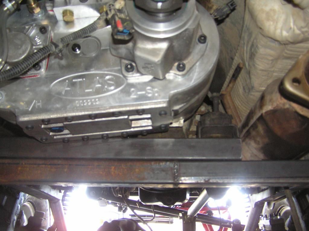

it has rubber mounts, I used 2 body mounts as Isolators seems to very well.
Very little unwinding of the driveline when you step on the clutch after some heavy crawling. This gives you an idea how I shoehorned those isolators in there one on either side of the tranny mount, it works well without any rattling or vibration.
Very little unwindingof the driveline when you step on the clutch after some heavy crawling. This gives you an idea how I shoehorned those isolators in there one on either side of the tranny mount, it works well without any ratling or vibration.
Oh, now i see. That's pretty creative using body mounts. I never would have though of that.
The other picture it just looked like it was bolted to the crossmember that was bolted to the frame which is why I asked.
