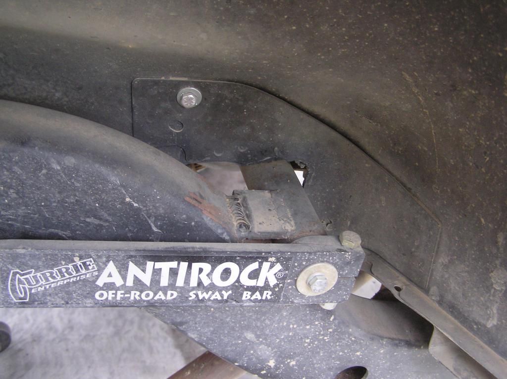

Art how is you rear antirock mounted to your frame?
Can you get me a close up pic I'm looking to make mine more clean. Right now I just have the entire bracket welded to the side of the frame and it looks like ****
AngryTJ is offline
post #1526 of 3079 Old 04-14-2013, 05:04 PM Thread Starter
aw12345
Location: ontario
Posts: 7,285
Mine has the tube sitting on top of the frame with 2 pieces of plate welded to the top and front of the tube and then welded to the frame. Here goes

Currie sells a specific tube for the tear AR for about 35$. It helps clean up the rear. Or reuse the bracket. Just trim it down and add a plate to it to clean it up.
I used the universal tube and bar.
If you don't have the tube, but do have the bushings, just find a rtube at the steel yard that has the right I.D
One side done, better angle of the arm and rod and seriously doubt this will bend.

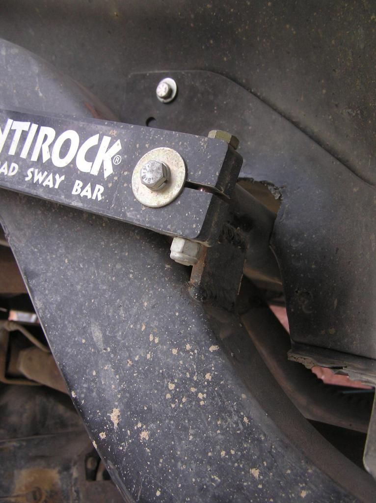

my lil project all finished up
Clearance at full droop
This whole affair moved the mounting points 2" further forward and away from the axle, thus reducing total amount of travel of the swaybar at full flex win win all the way baby yeah!
