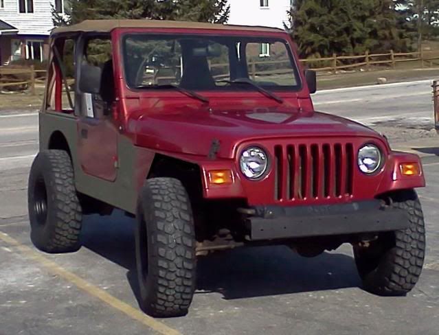

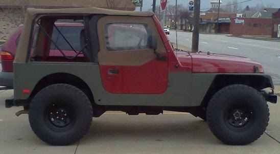

Here are a couple pics from the thread showing it on the 33x10.50s with no lift. soon I will be ditching the sagging old springs and putting on my low mileage LJ springs with a 3/4" spacer in front and a 1.25" BL. Keep in mind these pics are with 128K old springs. Also no flares and modified front fender into a flattie. (first 2 pics I photo altered the front fenders to see what they would look like chopped. the last two pics are after the chopping.)

No photoshop. Actual profile 33x10.50 no lift at all on sagging springs. No flares and front fender chopped flat.
I really think once the LJ springs, 3/4" spacer in front, and 1.25" BL go on I will be fine.
I might trim a little off the rear bottom of the fender opening to clear better in flex.
