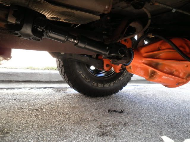

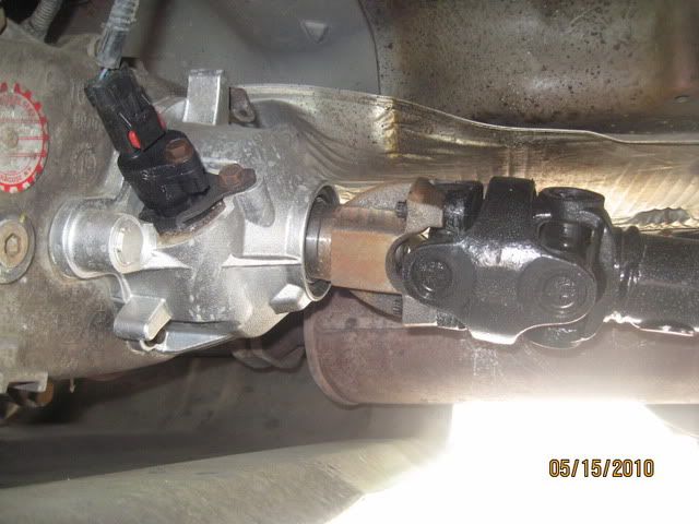

The drive shaft is installed. Since I only have a 2" lift there was no need for UCA to adjust the pinion angle. I'll take some photos the next sunny day.
UPDATE, pics attached.

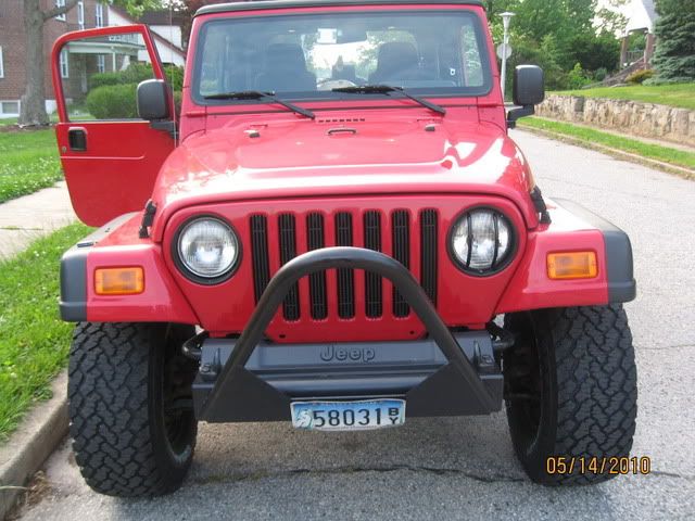

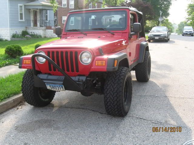

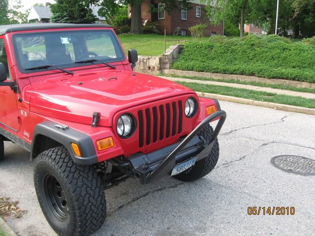

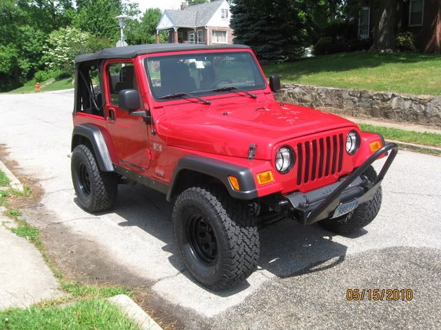

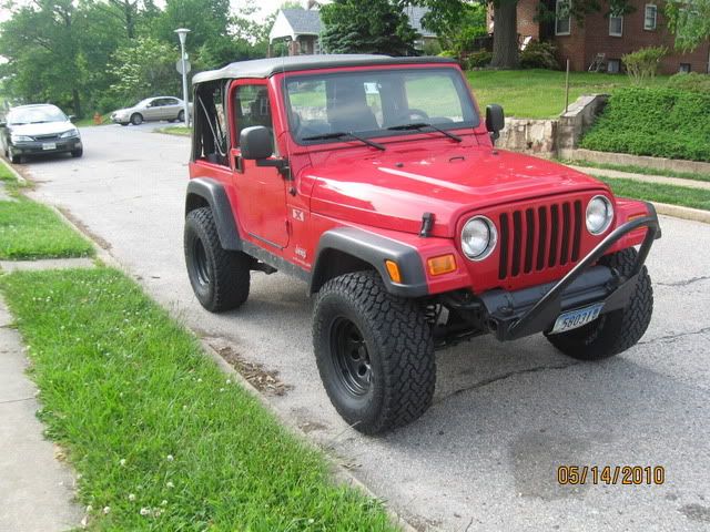

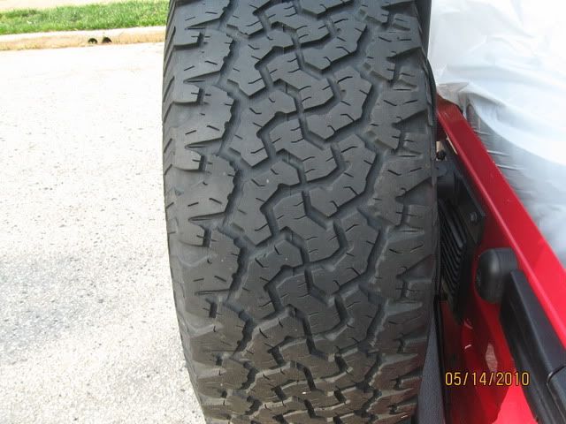

My Death Wobble came back last week. I took it to my local NTB and had them balance the tires. No improvement. I took them back and had them rebalanced. No improvement. I started to panic and ran to the boards for help. The toe was good and there was nothing loose on the front. I stuck with my gut and decided it had to be tires. I took it to Harford Tire on Route 1 and 136. They had a road force balancer and I figured it would do the trick. The guy took one look at my tires and said the road force wouldn't help them and to get new tires. They had about 58,000 miles on them so I agreed.

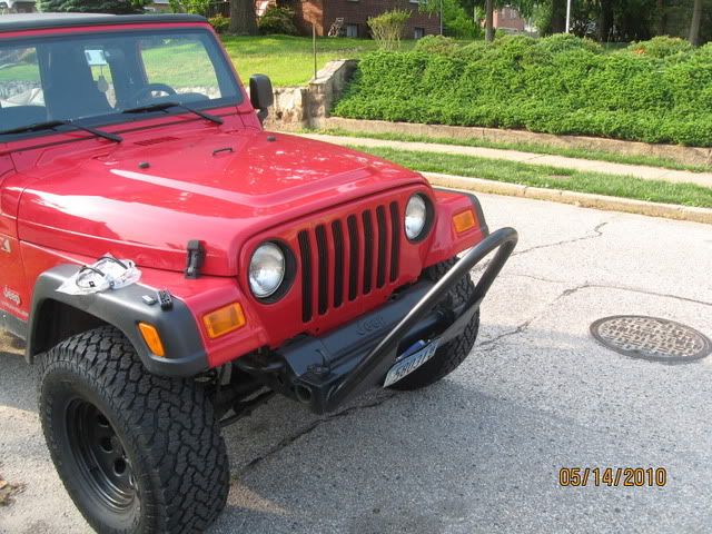

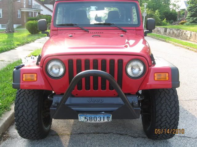

I went with General Grabbers AT2. They are the cheaper version of the BFG's I had previously. The ride home was great. No more wobble and equal road manners to the BFG's.
My spare is still the BFG. Here's a pic for a quick thread comparison. This tire has about 40,000 miles.
willydigger is offline

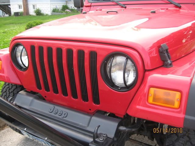

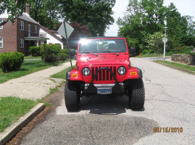

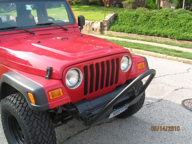

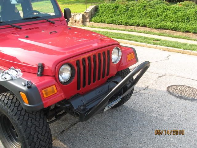

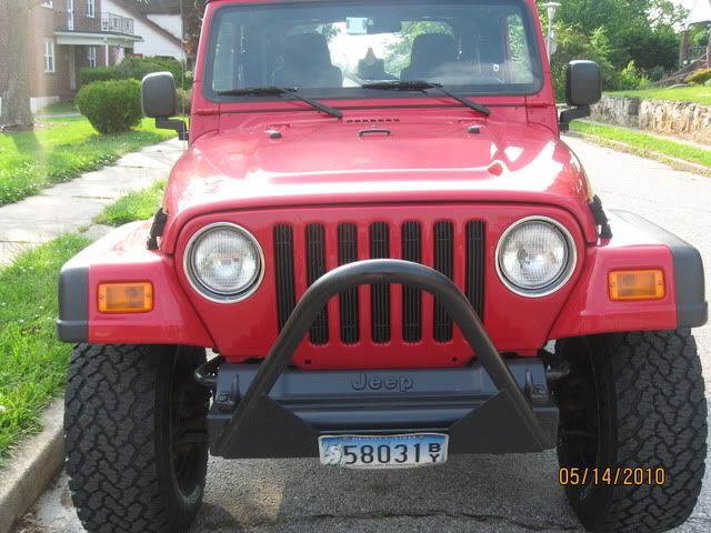

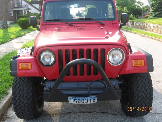

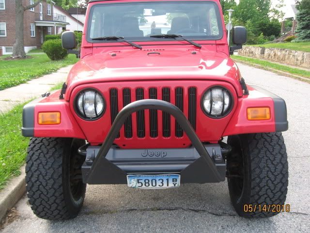

I bit the bullet and got the black headlight bezels and euro headlight guards. I had debated for several years about getting them and decided to go for it. There are a couple euro guards and I went with the cheaper Rugged Ridge version. They are pretty flimsy. I got them for looks though it doesn't matter to me. Here is an array from stock chrome to black.

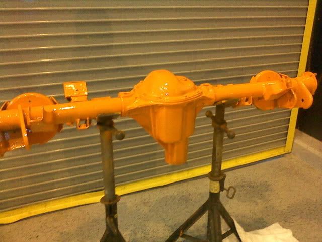

Made a lot of changes since my last post. Started with the addition of a Dana 44 with a Detroit/Eaton Truetrac. Below is after removing the surface rust, adding a rust reformer, and a safety orange paint job.
Here is a shot of the axle installed prior to shortening the drive shaft. Also notice the wheel in the back ground. I've been having fits with a leaking axle seal.
Here is the driveshaft shortened.
The axle was bought used for $500-$600 complete. It had the wrong gears (3.73) so I upgraded to new 4.10 and a truetrac. The Jeep is DD first offroad second so street-friendly traction took priority.
I took the axle to DND Offroad like I had done when I regeared the Dana35. I had the same pinion preload problem with both installs. You can't beat DND's price, but both axles had to go back, the Dana44 twice.

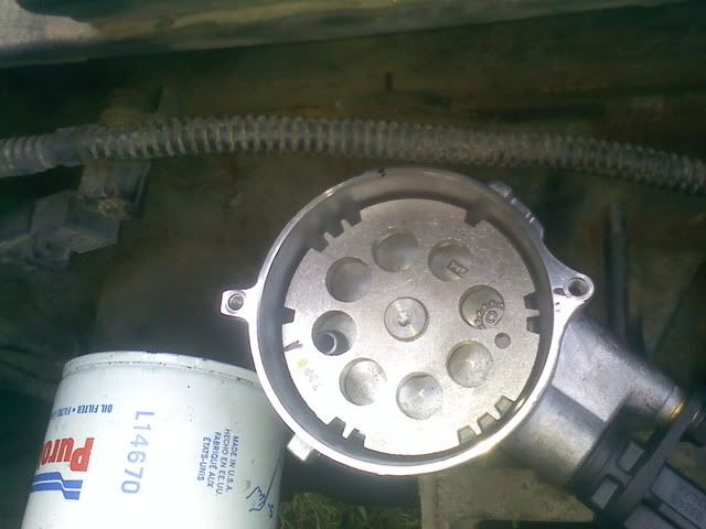

OPDA, Swaybar, and Shock Mount Problems
After installing the Dana44, the Jeep decided it wanted lots of attention. First it started with a bad OPDA. This is covered in this thread.
chrysler is paying to install a new cam (2005/2006 owners should read)
Here are a few pics pertaining to that problem.
Of course the symptom of the bad OPDA was a squealing noise from the engine bay. After a new serpentine belt $25 and belt tensioner $45, I found it was the OPDA (dealer covered for $100 deductible). I should also mention, the oil was changed to Mobil 1 High Mileage in an effort to minimize damage to the new OPDA. What a headache that has been.

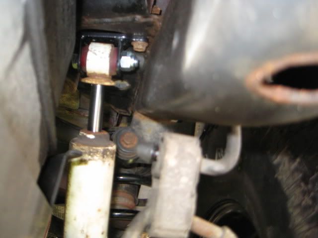

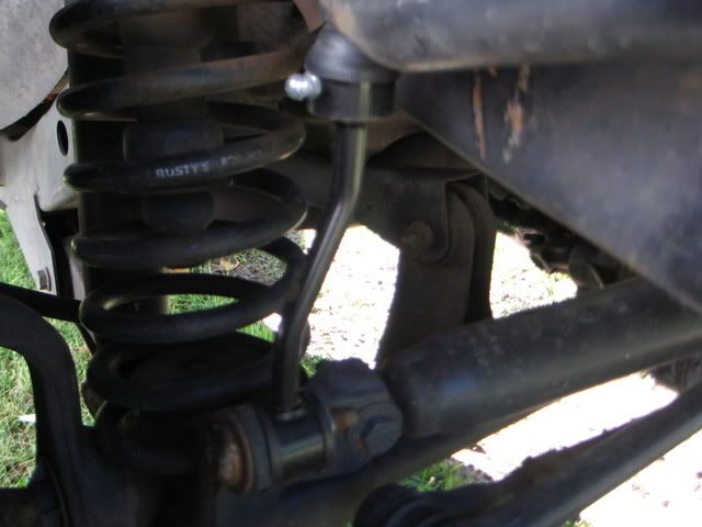

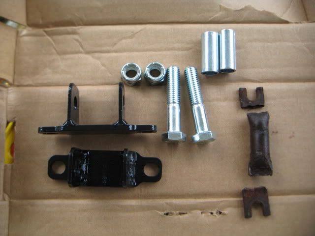

Once the OPDA was repaired, the right front sway bar link broke. Once that was fixed (Advanced Auto $17), the right top rear shock mount broke. This caused a nice little rattle as the shock bounced on the exhaust. I bought a set of Rugged Ridge BPE's $35.

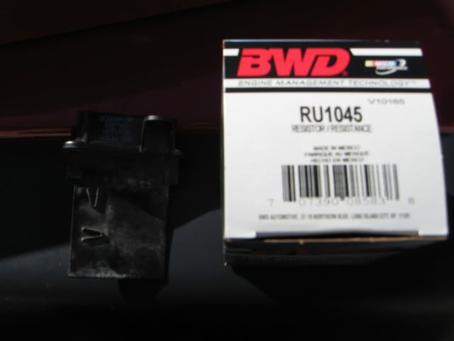

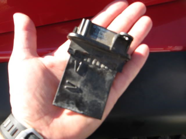

Oh and $20 for a replacement Blower Motor Resistor. That was a PITA to replace. As hard as people say on the boards.
It was a lot bigger than I thought.

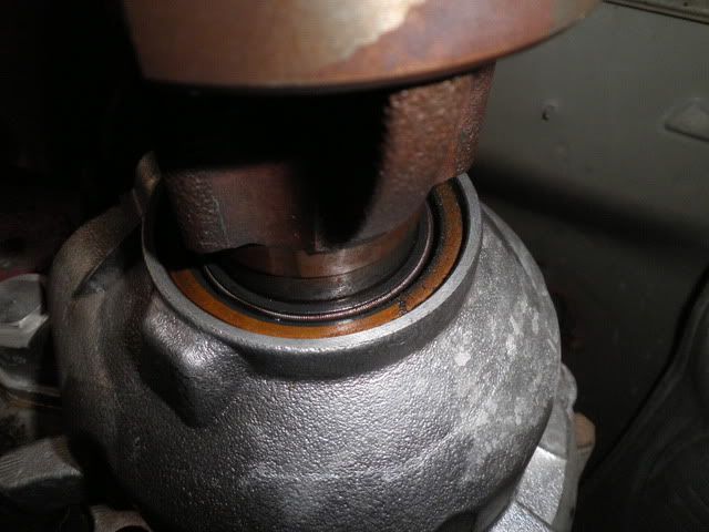

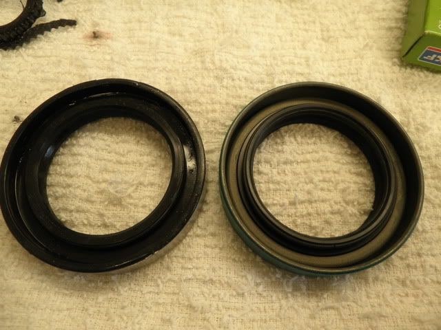

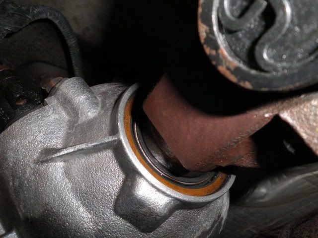

I've been chasing a slight rumble at 65mph since installing the Dana 44 rear. Along with the continuing rear axle seal, I assumed it was from a faulty bearing. I bought a new right axle shaft, new bearing, new seal, new retaining plate, and a new retaining ring. Everything on the right is new.
I drove home today, no improvement. Maybe just maybe the leak is fixed. I'll know in about a week. That's how long it usually takes to seep out of the brakes and onto the tire.
In addition I've discovered the SYE output seal was installed backwards. Seems like a common factory screw up. That explains the small leak from the SYE. Hopefully I can find a local vendor that will have the seal (18662 is the alleged PN).
Below, notice the steel spring is facing out toward the yoke. It should be facing in toward the roller bearing.

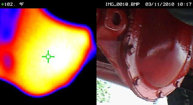

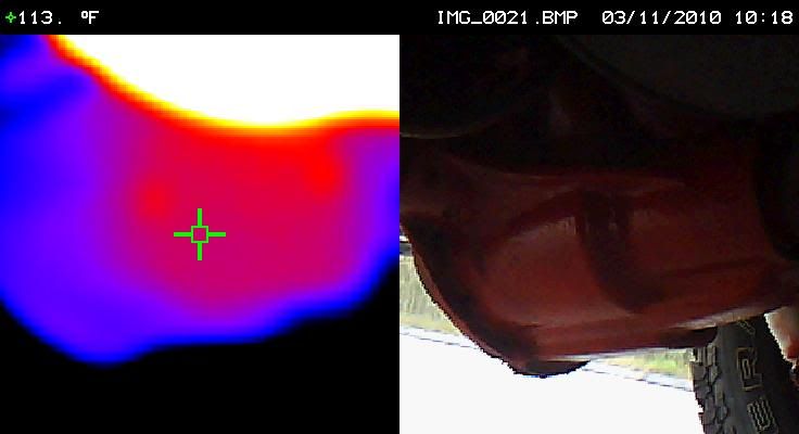

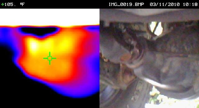

Here are a couple cool pics using a new Thermal Imaging Camera from work. This was after a 20 minute ride through morning rush hour. The speeds ranged from 30-60mph.
The red on is the rear Dana44. The other is the front Dana30.

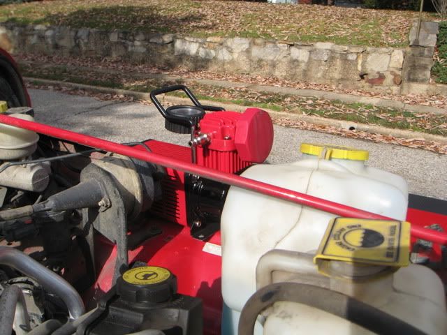

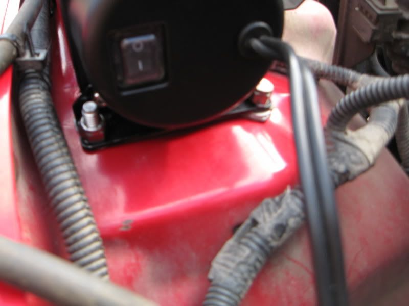

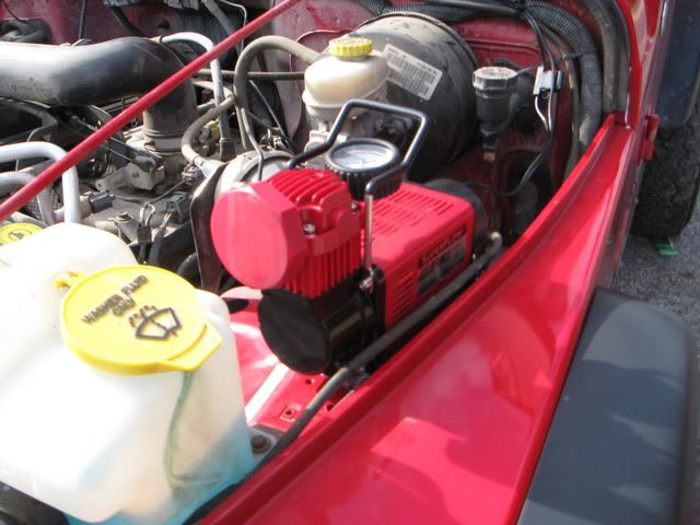

Here are some MV-50 portable compressor shots. This is my second MV-50. The first one was never installed and was subsequently stolen from the Jeep.

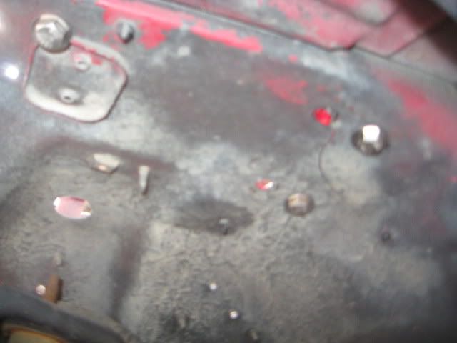

I used 3 5/16 SS bolts. I drilled through the fender, coated the hole with paint, and added a strip of double sided exterior tape to each foot to act as a dampener.
Here is a terrible pic of the bolts on the underside. There are a few extra holes. I accidentally mounted it too close to the washer reservoir.

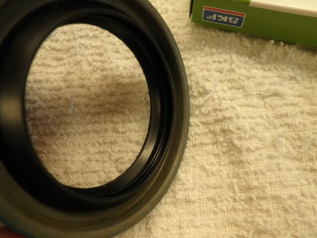

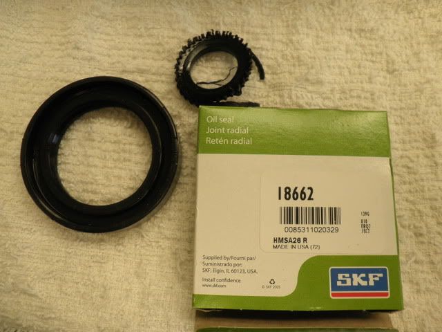

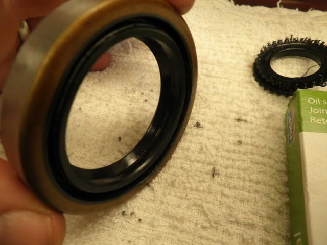

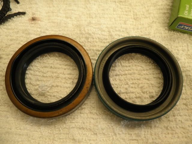

Quick update. The seal on the SYE has a spring on both sides and looked like it was installed correctly. I had never seen a seal with springs on both sides. During the seal replacement (which was by far the least problematic repair) I noticed the yoke nut was a little loose. Also the rubber spline washer was damaged. I think it got pinched during the initial install and as it degraded the yoke became a little loose causing the leak (all speculation at this point).
Below is from this thread.
http://www.jeepforum.com/forum/f9/sy...k-help-942356/
I installed the new seal today. The original seal has a spring on both sides. I cleaned up the yoke with a scotch-brite pad. I added a very thin layer of silicone around the outside of the seal and some silicone on the top section of the yoke closest to the nut.
The seal was $18 and the replacement splined rubber washer was $3.50 from the dealer.
Old seal on the left. Here is a pic of the outside of the seal.
Inside of each seal.
Old seal with old washer and new seal box.
New seal mating surface.
Old seal mating surface.
