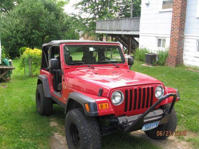

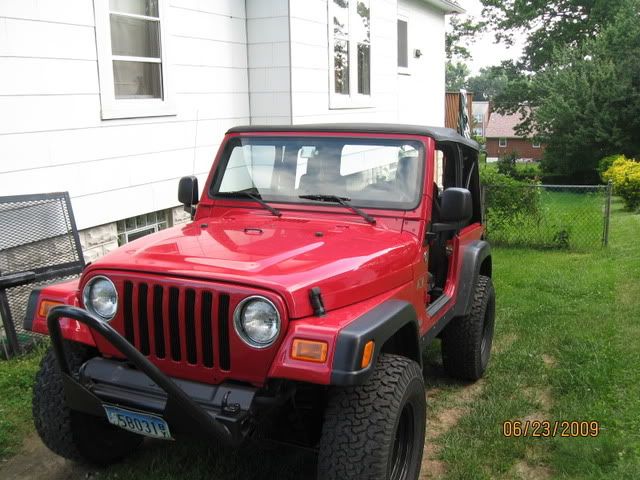

The easiest thing to do is the relocation brackets. They are kind of funny looking for our body style. One option I'm exploring is getting a set of pre-'03 mirrors with the relocation brackets they sell for that type of mirror. Although the mirror for the pre-'03 doesn't look as nice as ours, the entire setup is much cleaner looking. It will still keep a stock-like appearance. The price tag is probably close to $100. That's what is stopping me from doing it right now.
willydigger is offline
post #69 of 118 Old 06-23-2009, 05:54 PM Thread Starter
willydigger
Join Date: Nov 2005
Location: Baltimore
Posts: 1,574
Mirror Update. Check out this thread for the build specs. Also notice the grille inserts. Check out this thread for those details.

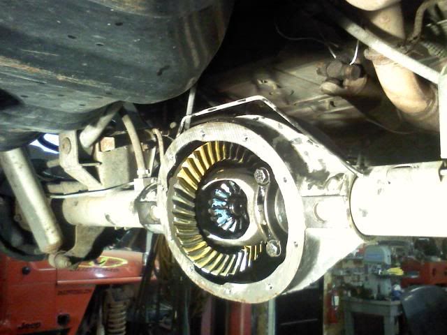

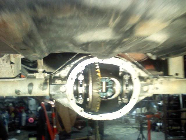

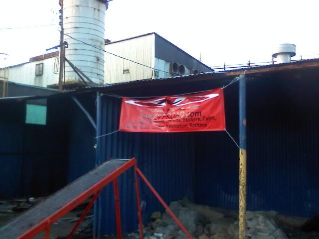

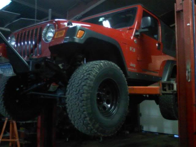

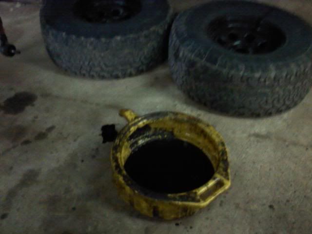

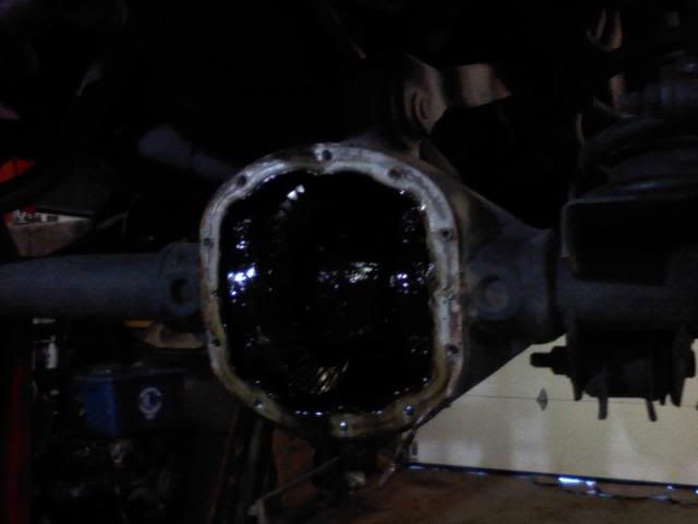

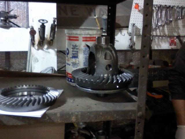

Well I finally bit the bullet and got the regear done. I had been saving for several months or so. I got quotes from 4 different shops. The shops are listed below from highest quote to lowest. If I remember right all quotes included 1 yr parts and labor. I went from factory 3.07 to Yukon 4.10's so the prices included new carriers.
Delmarva Offroad HIGHEST
Appalachian Offroad
Adrenaline Offroad
DND Customs LOWEST
Below are a few pics with my cellphone.
Overall the job took about 12 hours for the whole thing. There were some hiccups getting things apart and some problems with the rear pinion. The front went together smooth and once the rear pinion load was adjusted we were good. Mike (the owner of DND), let me watch the entire install. The ride home took about 2 hours with 2 pit stops on the way home to let the gears break in. I'll provide an update in a few weeks on performance. The ride home was a little gentle, but the initial impression is positive with regards to the increase in power.
