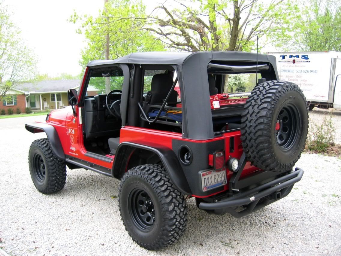

Heavy and Rubber?
There super light and urethane......Super flexible too. Mine don't pull away at all and my 33" have flexed into them a few time wheeling along with mild tree rash in the woods.

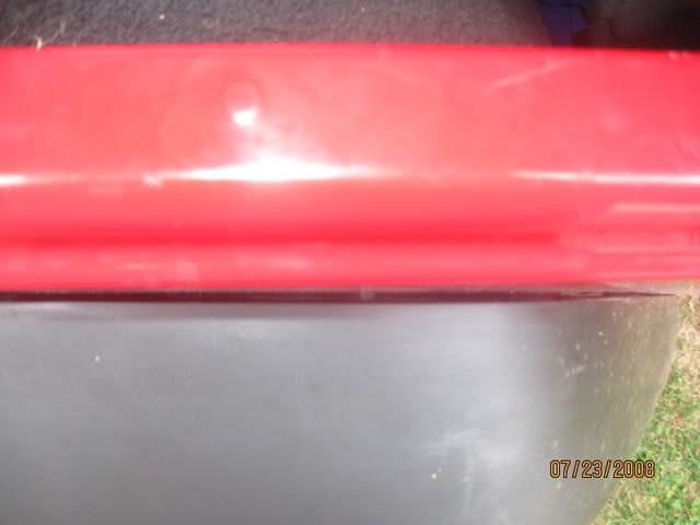

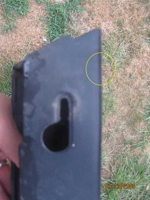

I can only speak for the version I had. I'm glad you don't have an issue with yours. The ones I got (compared to the factory and rubi) were much heavier. Because of the weight and material, they bulged at each bolt hole. I had a co-worker with the same flares and the same problem. Maybe they changed since then, but the set I had was a disappointment. Here is what I'm talking about:
The factory flares also had an extra piece of plastic that created a tight seal to the tub:

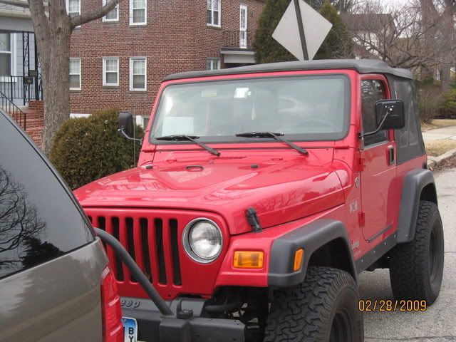

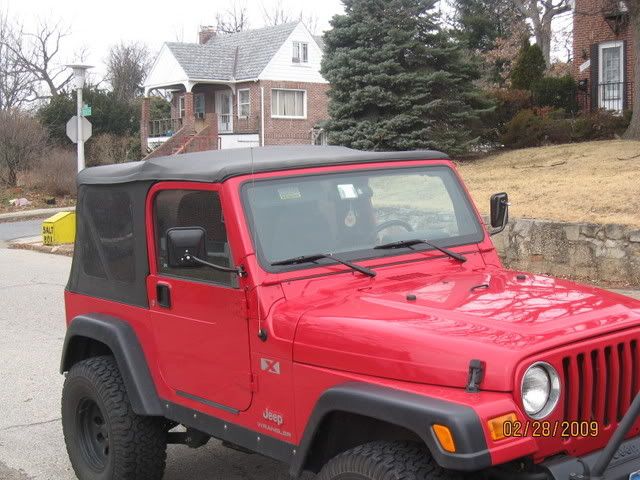

So after a long stretch of not being able to see out of my passenger mirror I bit the bullet and spent $40 on the Rugged Ridge/Omix-Ada "CJ style" mirrors. While the mirrors are more functional than the stock mirrors with mirror movers, they still aren't growing on me. My everlasting resistance to buying them was the scrawny look and feel of the mirrors.
Here are some close ups.
Here is the POV from the driver.
Here is the mirror hardware.
I plan to experiment with extending the passenger mirror mover out so I can use the stock mirrors for a more beefy look.
On a final note the "CJ style" mirrors vibrate while driving. They have no backbone and shake with only the motor vibration. They also whistle while driving. These are minor issues compared to the skimpy look. If they had more overall bulk I could live with the vibration and whistle.

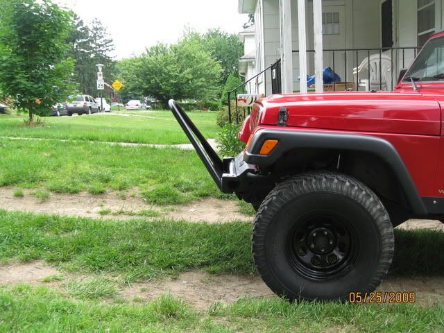

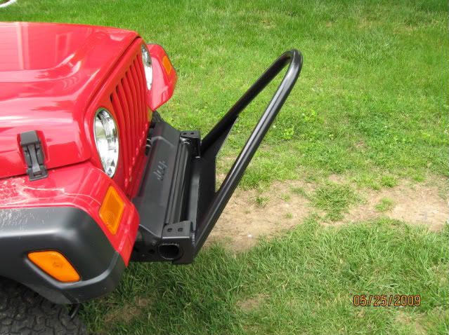

I added a homemade "stinger" brush guard to the front. The tube was ordered from Jeeptubes.com.
The angle was set to 55 degrees.

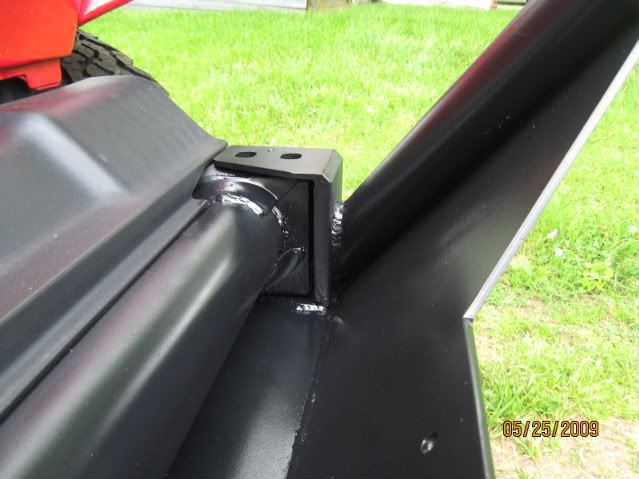

I took some shots of the inside welds and Rokmen mounting brackets.
The bottom plate is 3 inch wide 3/16 flat bar. There is a small notch cut out to provide clearance for the steering box.
The mounting brackets came with tabs to add a tube bumper. Those were cut off and a 1/2 inch plate was secured to the bracket to provide a non-flexing base.
Here are some shots of the license plate holes (MD required). The front skid plate measured just under 12 inches from base to highest point. The center was 5 inches high. It was 3/16 thick.
