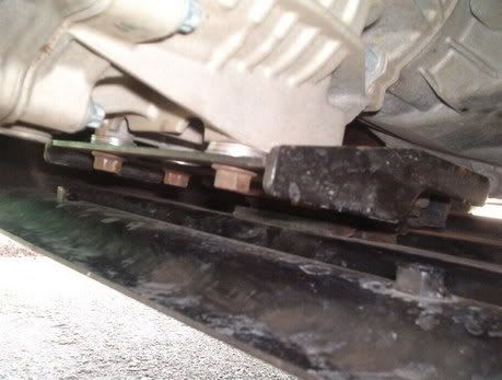

The bracket was the Tcase relocation bracket that came with the Rusty BL. I had to egg the bolt holes because the brass bushing on the Tcase link wasn't flush with the holes pre-drilled. I also notched the top like 4x4xplor recommended. Didn't know if I needed to or not, but went ahead anyway.

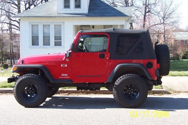

The AT's are big and quiet. They are pretty aggressive for AT's too. They won't do well in mud. They aren't cheap though. I paid $132 ea. at Sears in Baltimore. Final price was like $750. I really didn't care at that point. I made up my mind I was going to do it and convinced the old lady to let me.

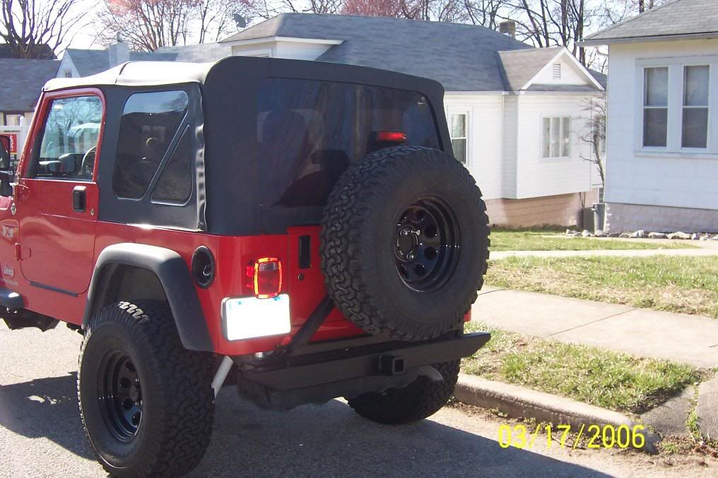

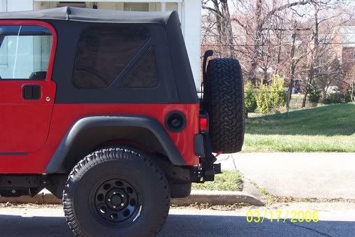

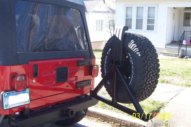

Here are a few more pics with the new TC. Notice the third brake light remounted.

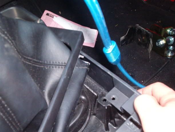

Just a quick update on the lift a few weeks after. The washers I put in between the Tcase and the skid plate are gone. I still have the washers between the Tcase and the Tcase bracket. I pulled apart my console on the interior and there was a screw holding the console secure under the shifter boot. I removed the screw, slid the console over to the right a hair and reinserted the screw in the mounting hole so it wouldn't slip back. This moved the console back enough to let me remove the washers and still let me shift in the back gears.
Here is the before:
Here is the after:
Here are a couple pics of where the console screw is tweaked.
Finally, I ordered a Rear Trac-bar Relocation Bracket. Two weeks after the lift was installed and after installing a 250lb bumper the rear end sagged enough to even things out. I don't plan on installing the bracket.

that's a nice looking homemade rear bumper!

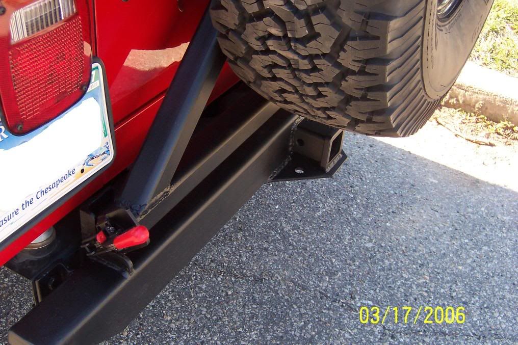

Thanks. I originally went with the 400# toggle clamp. It broke. I upped it to the 2000# clamp. It's much better now.

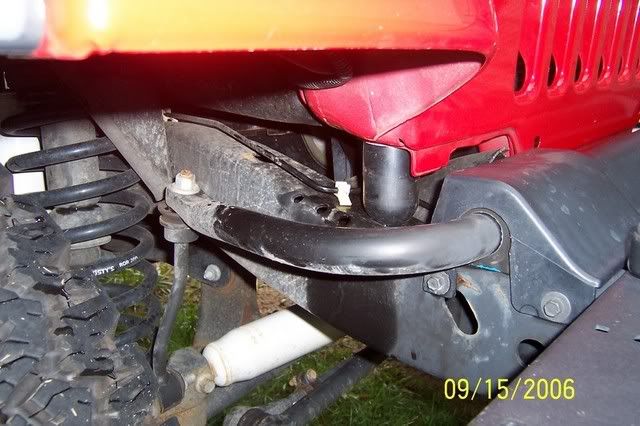

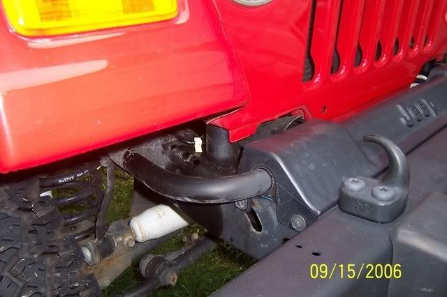

A new pic! A few days ago I found out what the little black bumpstops were for that came with the lift. Originally I thought they were rear bumpstops, but since they were so small I figured it couldn't be. I tossed them in my leftover box until the other day. It turns out they are part of the BL and replace the small bumpstops on either side of the grill.
I don't know how critical they are. A ran without them for months. I had to put them in once I found out where they go. Anyway hope it helps other newbies. I'll update with some more pics when it stops raining. I just noticed I don't have any topless/doorless pics.

i'm glad you figured out the console thing, after my body lift i couldnt shift into 2nd or it ould pop out of gear while driving in 2nd. i just moved my whole center console back 1" and made new holes in the console for the screws, problem solved.

I've also heard of people bending the shifter. There are still a few washers under the T-case. The driveshaft alignment is within reason, but I might end up tweaking the console back so I can get them out.
