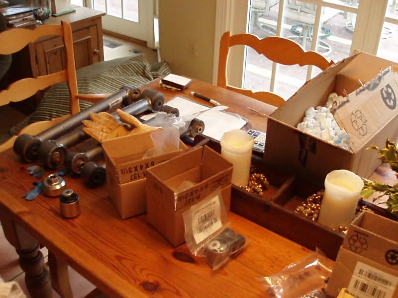

Oh, and also my RE parts for the control arms came today.

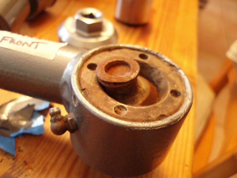

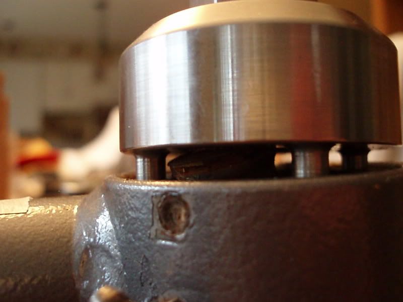

Got the bushings for the uppers put together, just need to tear out the old ones and put them in, but ran into a problem with the superflex joints on the lowers that need replacing.
The joints that are broken, are rusted in at an angle, so the SF joint tool won't fit onto the joint to take it apart.
Broken joint:
Tool on the joint:
Not really sure what to do there, it's too rusted to grease up and turn, so I guess i'll be grinding that part off? We'll see.

If the joint is already screwed up - use flame-heat (cutting torch would work great, small propane torch might get warm enough) to heat up the steel around the joint - while very hot hit it with WD-40 a few times - re-heat - re-hit with WD-40 ... and once it is cool enough to touch (still warm) try to remove the dead-joint.

So tonight I finally got the joints on the lower arms apart and rebuilt. Such a pain in the butt. After two days soaking in PB blaster, using the SF joint key, the one last piece of the joint wouldn't budge and nearly destroyed the key. With the help of my dad and brother we had to cut the part out with a dremel than wire wheel the threads. Put the new joints together tonight and tomorrow i'll grease them up so come christmas I can put them on. As for the uppers, I drilled the bushings out but need to cut out the ring that was around them and take it somewhere to have the new ring with the new bushing in it pressed into the arms. Once that's done i'll have a nice set of RE upper and lower control arms, hopefully in time for some 4wheeling this Sunday and maybe Rausch on the
3rd.
If I get around to it, i'll put up some pictures of the arms tomorrow.
