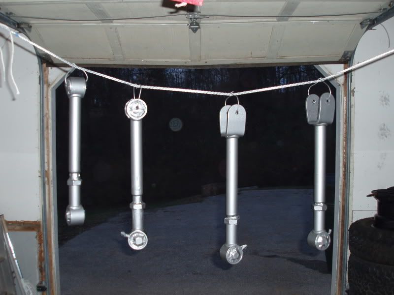

Thanks everyone. Checked on the paint on the arms after a night and day of curing, and it's gummy. Like I can scape it off with my figernail gummy. Definately not gonna hold up at all on the rocks. Thinking that it's cause I painted over powdercoating? Maybe I should clear coat it? Who knows, atleast they'll look good for a little
rustoleum hammered takes a long time to dry. baking it would help accelerate it
did you use a primer? that may be a problem

No primer. Bought two cans of the paint and one primer, than realized the rustoleum says "no primer needed", so i returned i and got another can of hammered.

should use some sort of self etching primer on steel no matter what.
rustoleum hammered takes about a week to fully cure.

Yeah, realizing that now. So i'll let them sit for the rest of the week, and hopefully by the tire there dry i'll have the joints and i can start rebuilding them. Thanks

Yeah morgan but i've already been snowboarding 3 times. Ordered my parts from rubicon, and cleaned and taped up the uppers. Tomorrow i'll paint the uppers than do a second coat on them and the lowers too.

I stayed home sick from school today, so what better time to stand outside and paint the arms? Put a whole can on the uppers, which turned out nicely. And pu a second coat on the lowers, which didn't turn out so well. Not sure why, but the paint started to wrinkle a lot? It's pretty weird, and doesn't look to good. Than again they'll be under my jeep.
Uppers:
Wrinkled paint on the lowers:
Anybody know what would cause that?

Light film of brake fluid will get you that same wrinkle look!

I don't want the wrinkles, i wanna know what caused it.
