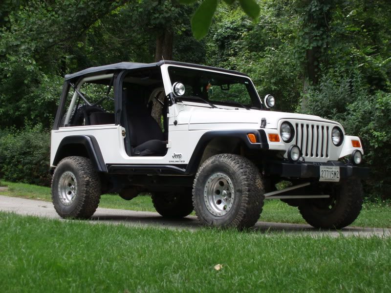

Beed almost a year since I've had the jeep, so I figure I'll throw up some before and afters.
8/19/2008
7/4/2009
It's come quite a long way
