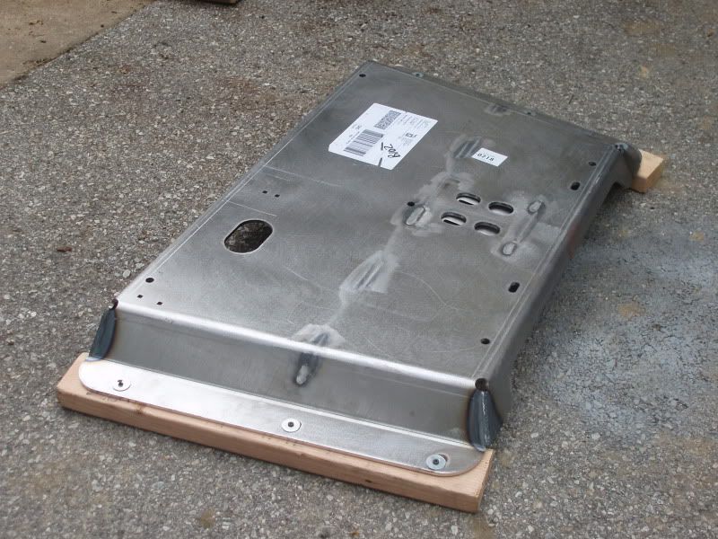

Rokmen belly up came today!!!
Thing is giant - pure beef. I had to get it out of the shipping truck myself because the woman who delivered it couldn't.
So like any normal person would, I stopped mowing the lawn immediately, pulled my jeep out of the garage and started painting it
Primed (underside):
(Top):

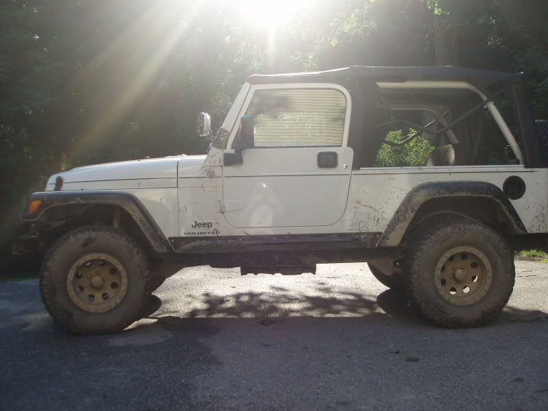

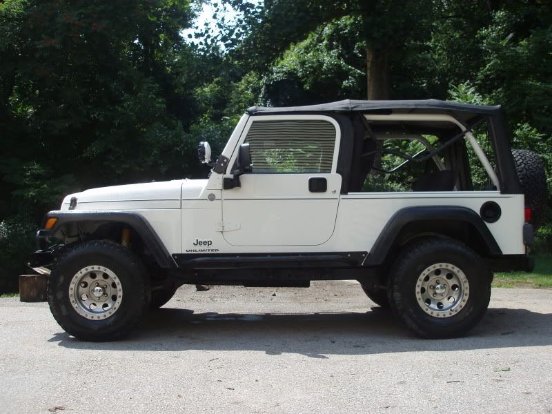

Got everything set up today! Went real smooth, took about an hour and a half MAX by myself. Other than breaking carriage bolt and having to go pick up a new one. Very straight forward and gained about 1 3/4"-2" of clearance under the belly. Only problem now is the exhaust hits the pass. front upper arm mount, but I'll get that taken care of. No vibes either
Before:
After:
Skid (sorry, bad photo):
If anybody has any questions or wants a specific picture, let me know!
