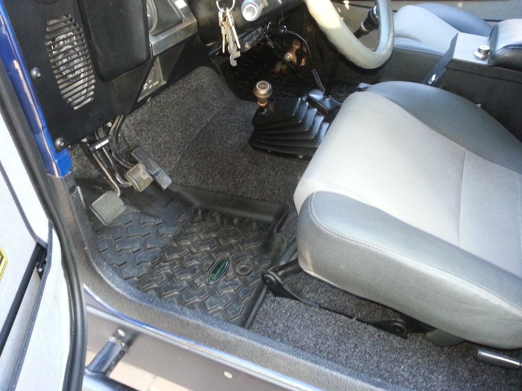

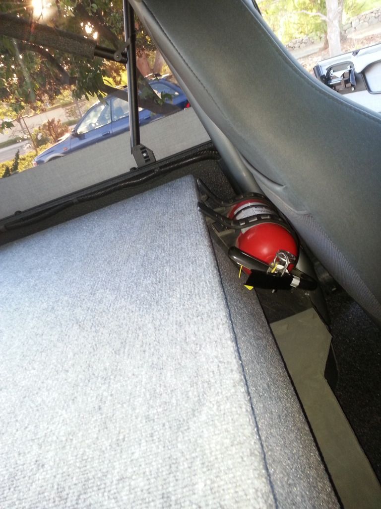

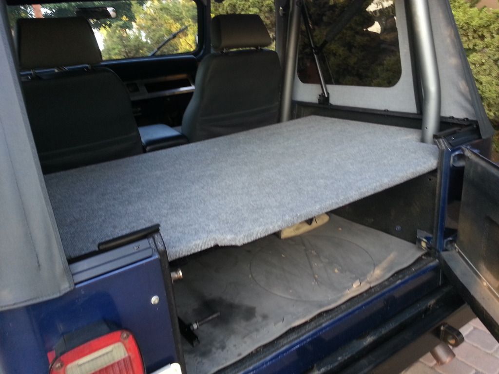

I would suggest the Bedrug interior carpeting. I put it in my YJ and it helped a lot with the heat that came in through the floorboard. I only installed the front kit. I'm sure with your additional deadening, it would be even quieter.
In the rear, I built a plywood panel and covered it with carpet. This allowed for things to be stored on two levels and for the items underneath to be "locked in" when the rear tailgate is shut and locked. It also helped to keep the sound that comes in from the wheel wells and rear tub in check. Here are a couple of pics...also added some "L" bracket aluminum with holes in it to allow for stuff to be tied down and to stiffen the panel (not shown in the pics).
That's awesome. How much thicker do you think that Bedrug carpeting is than the standard stuff? I've got some in now that's actually in really fantastic shape, and my wife wants to tackle cleaning it up, so it'd have to be a somewhat substantial gain for me to think about devoting some funds towards carpeting...but I'm open to it!

I'm looking to do what you did in the back with the split level/locked when tailgate is close.
Any recommendations?
Yours looks great!
It is about a 1/4" of foam with the carpet material applied to it. That is why they call it "waterproof". If your carpet is in good shape, then stick with it. Most people's carpet is pretty terrible

Good to know. Yeah, I lucked out and mine's in good shape, if a little dirty. With the foam, deadening, MLV combo I'm looking at, and a serious lack of water potentially entering the cab, I think I should be good.
Now your split level mod is something I'll be heavily considering! Thanks for the tip!
