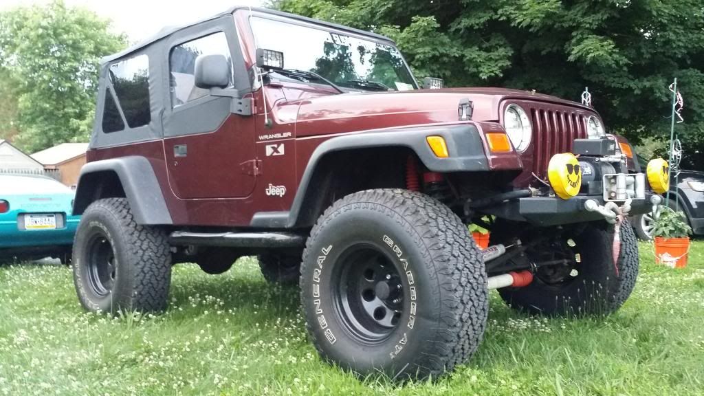

A couple pictures i received from PO:
So after talking Via email on a jeep i couldn't afford, we finally set a date we both drove about 2 hours met and drove the sucker home.
-Also It Is a 2002 Wrangler X 132,000 miles 5spd

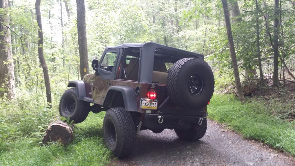

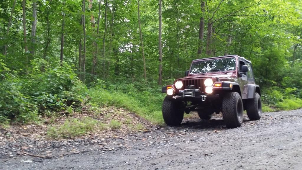

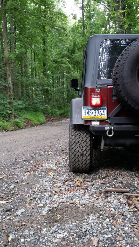

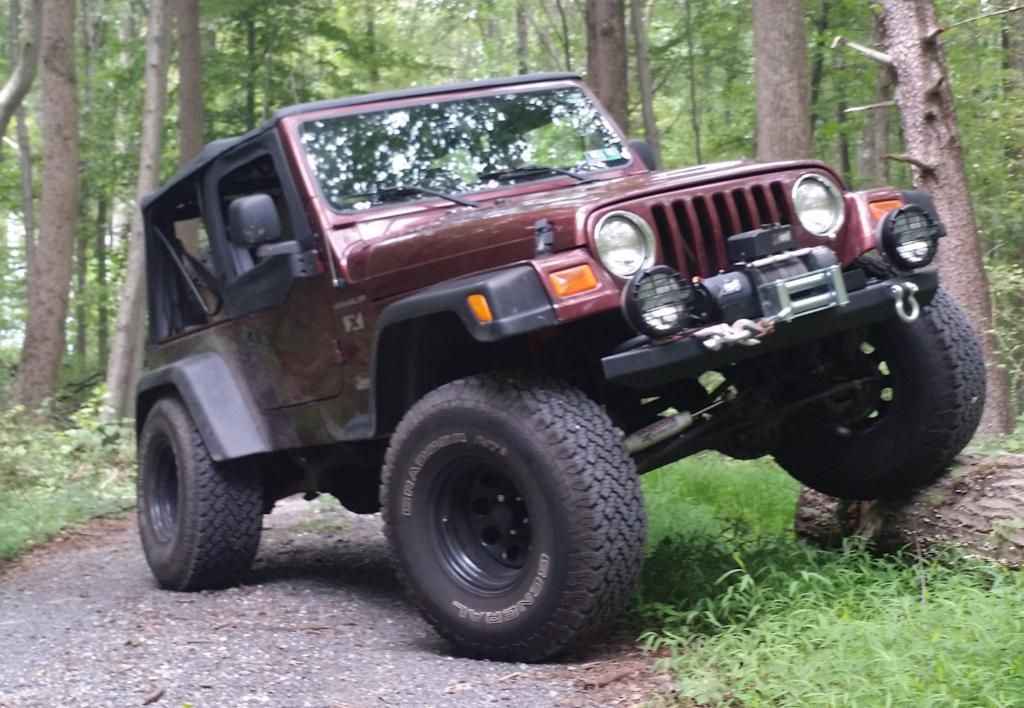

Aside from all that was able to do a little cruising and take some pics as i always love looking at my jeep
Little Flex with links still attached
^^mind you my 2 year old in the back having a blast!
After some fresh fluids - complete night and day difference.
