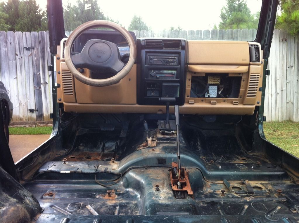

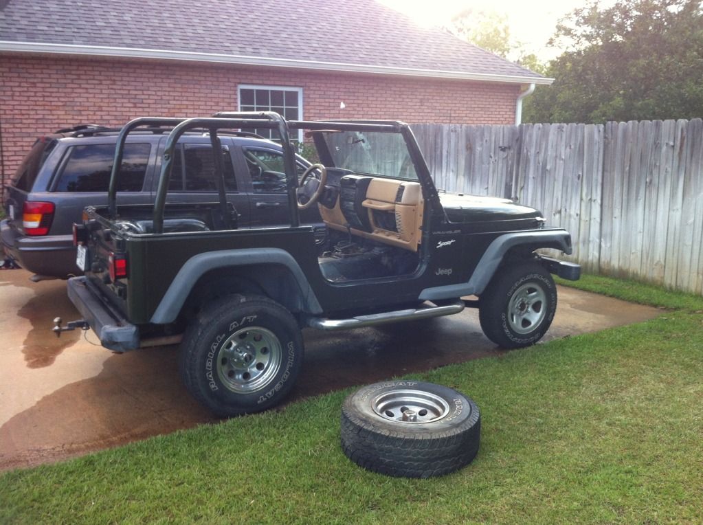

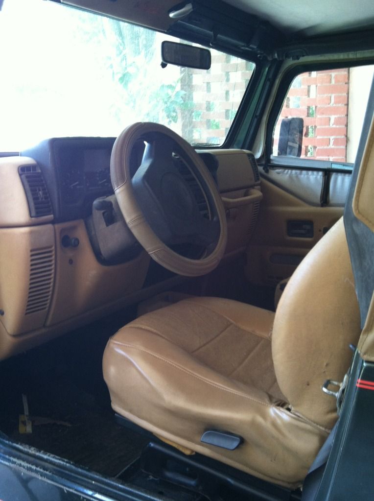

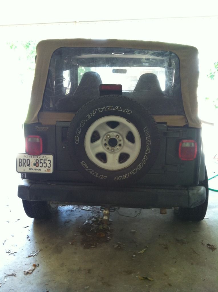

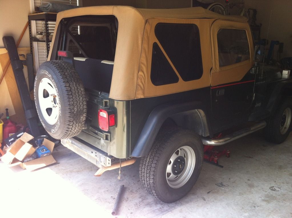

So that afternoon, my wife and I gutted her. And suprisingly once we got all the trash and guano out of her, we were pleasantly suprised.
Replaced the flat tire with one that was a little more round
I kept telling my wife, I was keeping this bumper for a reason. 3 years later we knew why...

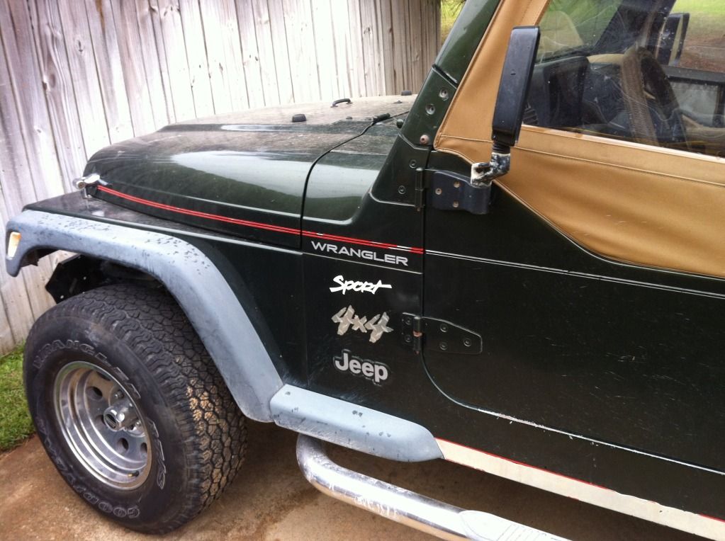

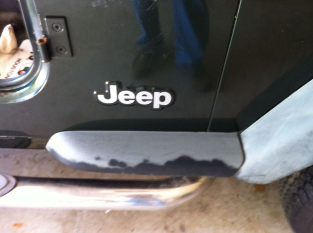

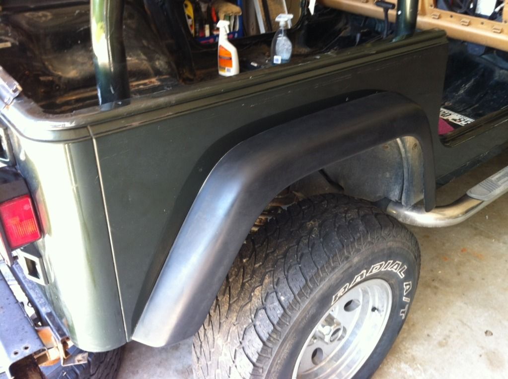

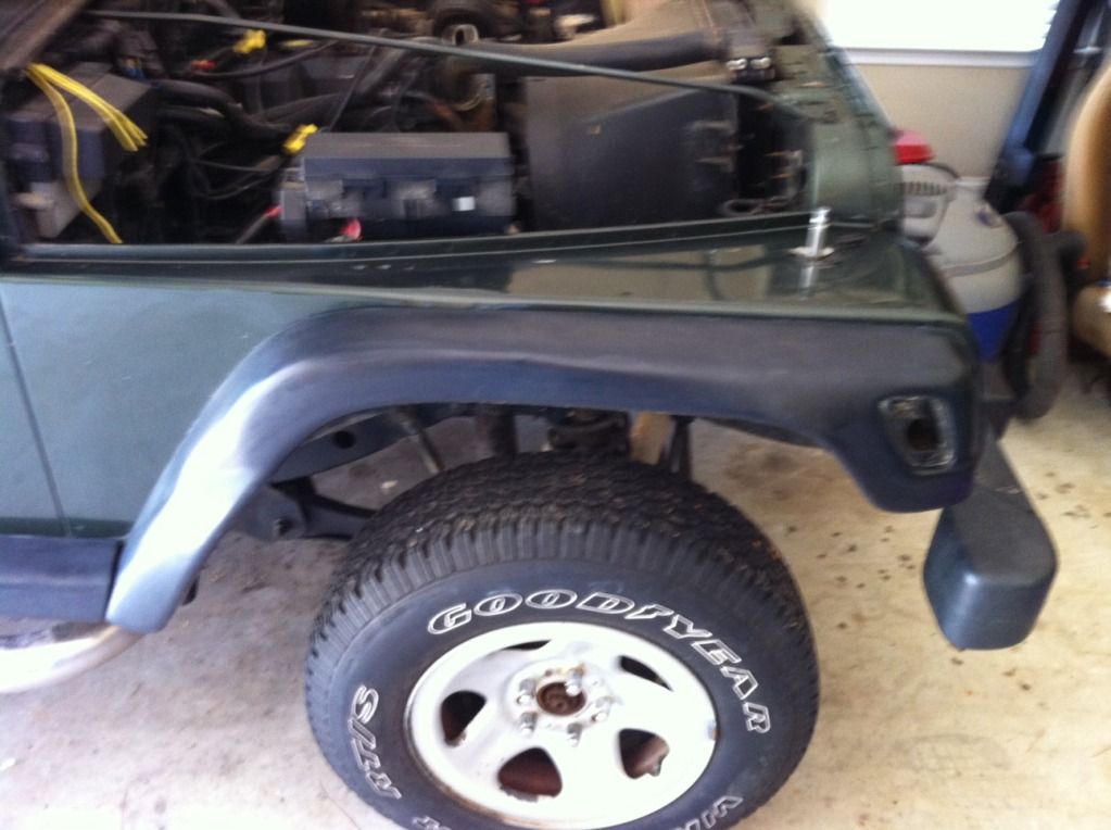

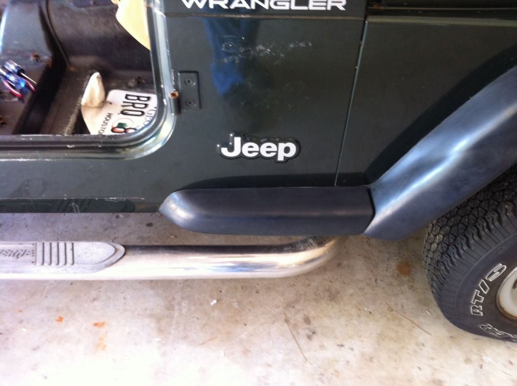

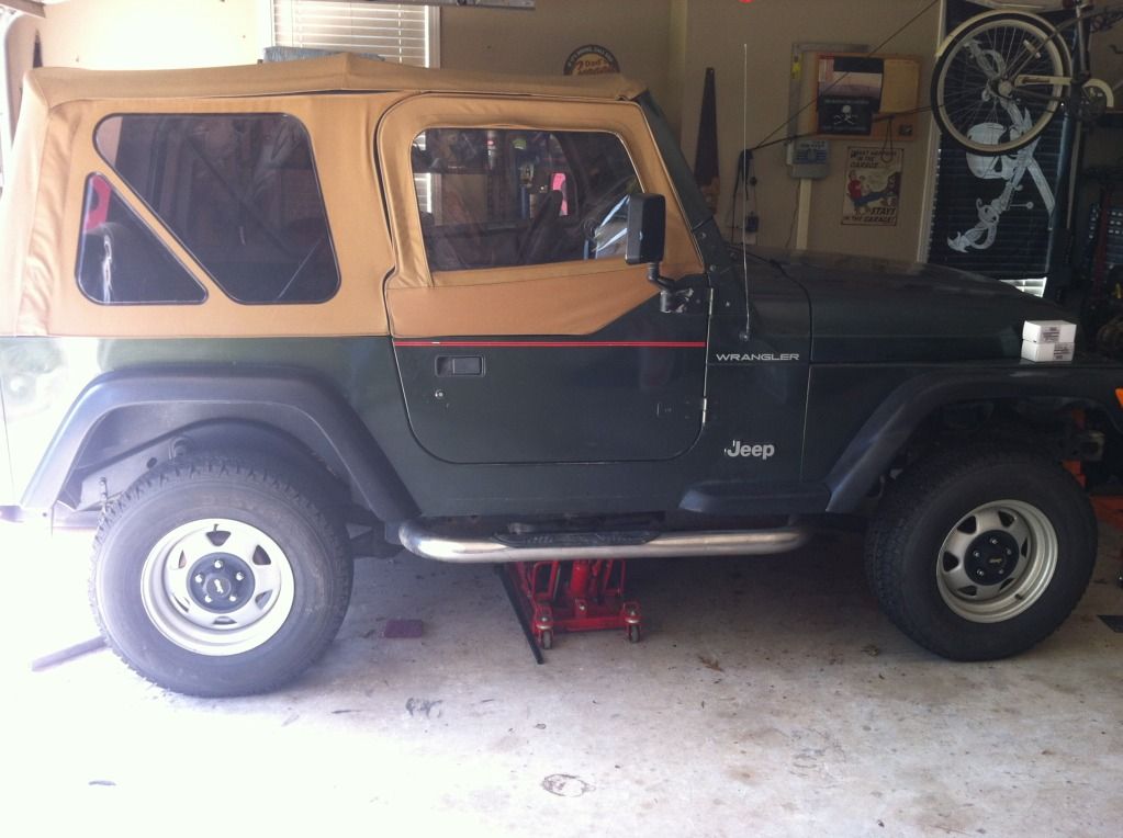

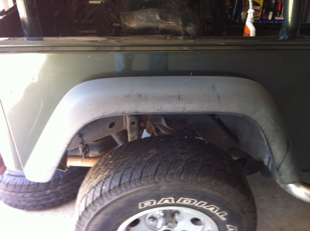

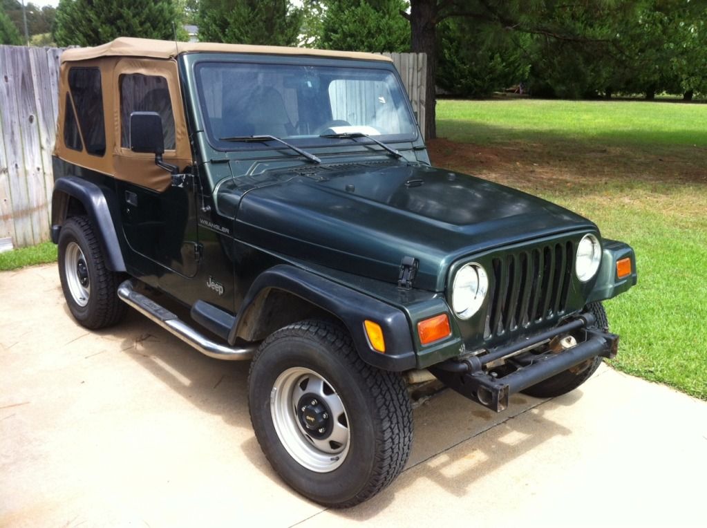

So one thing I've learned in living my life is, Small Victories can boost your spirit. With that said, we rolled her into the garage for the last time until she came out in September. So I'm looking at this sad, dejected little green Jeep in my garage and one thing that stands out is the fender flares. They are a dull chalky grey.
A little research and I find a neat trick.
Observe...

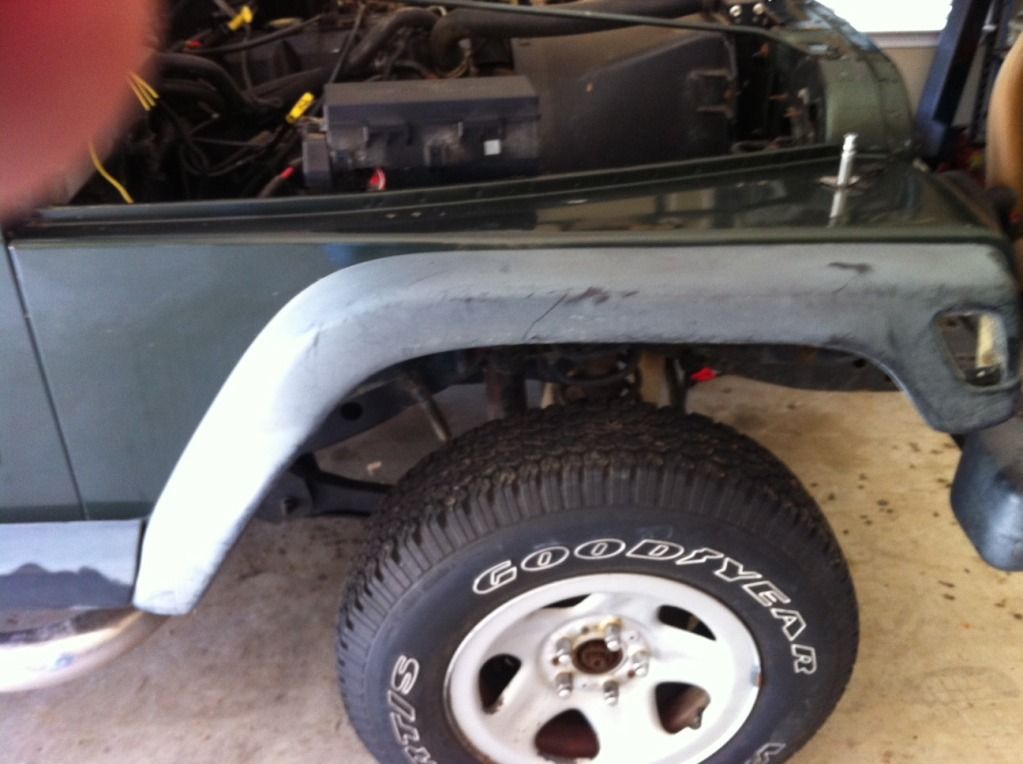

A propane torch waved back and forth quickly on the fender flare turns them kind of a shiny black. As a matter of fact they looked really good, so I did them all.
Not bad. Motor next...

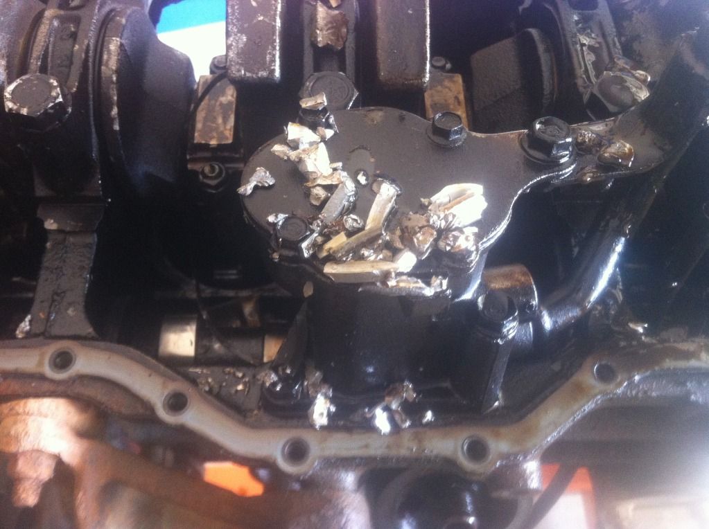

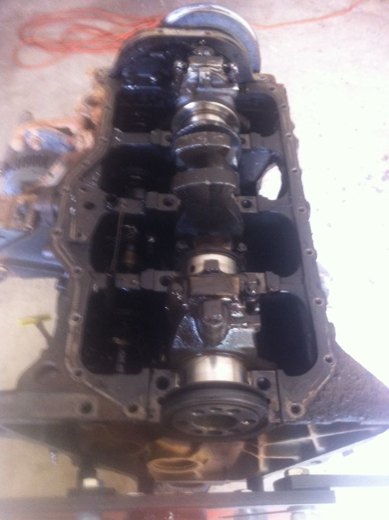

Well, the kid that sold this to me says it has a thrown rod. And I cranked the engine in the driveway. Didn't start, but cranked over really nice... kind of quiet. As much time as I spent under and around the car, I never saw anything to lead me to believe anything else other than a broken rod.

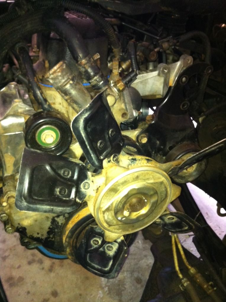

So in research I find that a 2.5L remanufactured engine will cost me about $1500 after the core return. I'm okay with that, still under budget and it has a one year warranty. What could possibly go wrong.I figure at the least I'll overhaul, at most I'll do a crate engine.

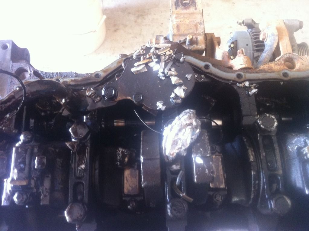

I thought, HEY I LUCKED OUT! No. No I did not. A buddy at work has a cherry picker, so we borrow that and pull the motor. When I removed the driver side motor mount bracket there was a loud clank as a grapefruit sized piece of engine block hit the gound. Yeah, it's like that...
The autopsy revealed this:
Notice the GREAT BIG FREAKING HOLE IN THE BLOCK!
Motor goes on an engine stand and I moved on to greener pastures

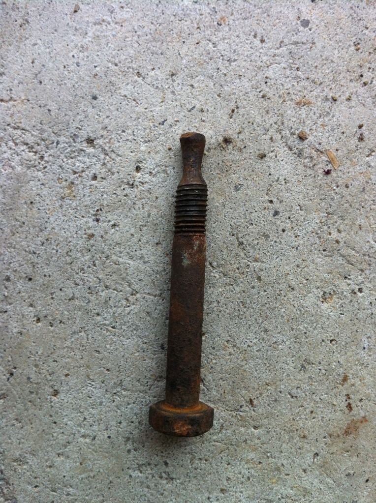

First up was to remove the 31 inch tires. A guy in a local club I belonged to wanted to replace his stock rims and tires with bigger rims and tires. I had decent rims to trade so we haggled a bit and I gave him $200.00, my rims and I got 4 stock rims with brand new Firestone tires on them.

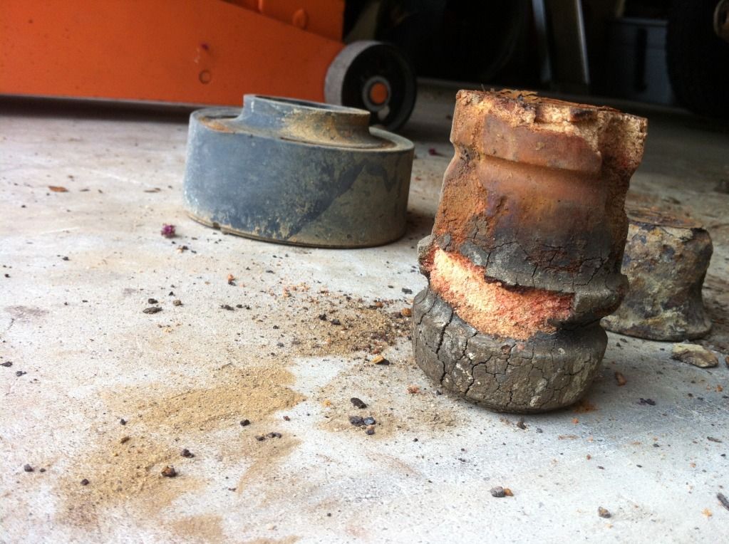

Next, get rid of the spacer lift and replace the shocks. I ordered four Monroe shocks from Rockauto and set about removing the spacers.
You can see how bad off the bump stops were, so I ordered new bump stops. The spacer is in the background.
Here is the retaining bolt for the bump stop cup (Notice the hourglass shape at the end of the bolt. I'm surprised they came out in one piece.
Everything on the right rear completely clean and painted. Still waiting on shocks.

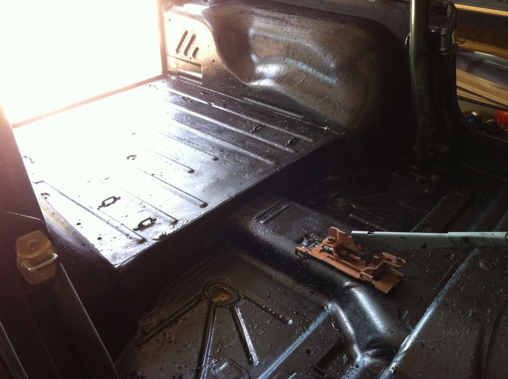

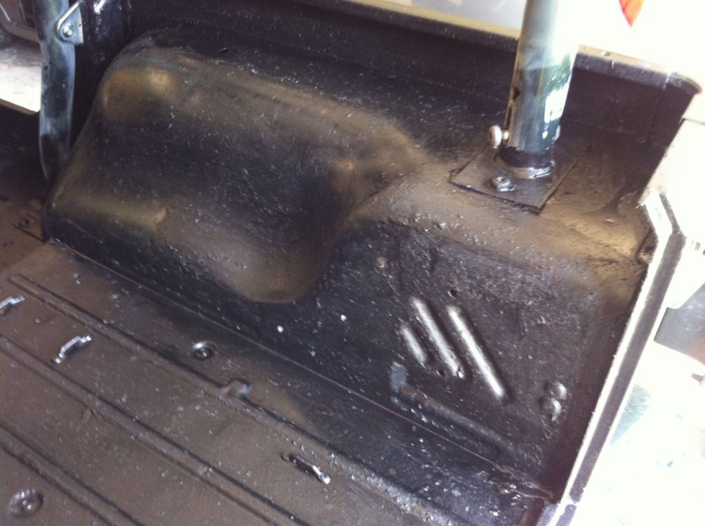

While waiting on shocks, why not bedline?

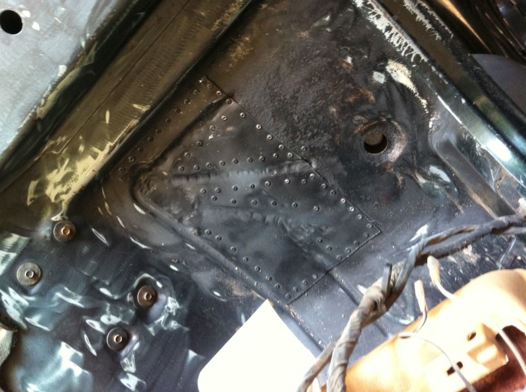

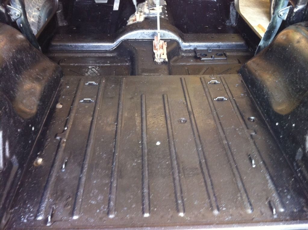

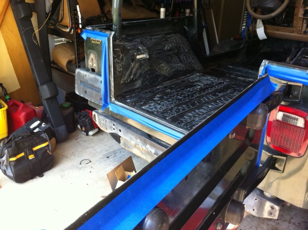

So as I am waiting for parts and nursing a bum shoulder, I decided to tackle the interior. We discussed carpet, etc. We decided to bedline the inside.
Scuff sand the interior...
And some more scuff...
Had to make a patch for a small rust hole in the floor. Lots of rivets and sealant to keep it in place
Tape off where my lines will be

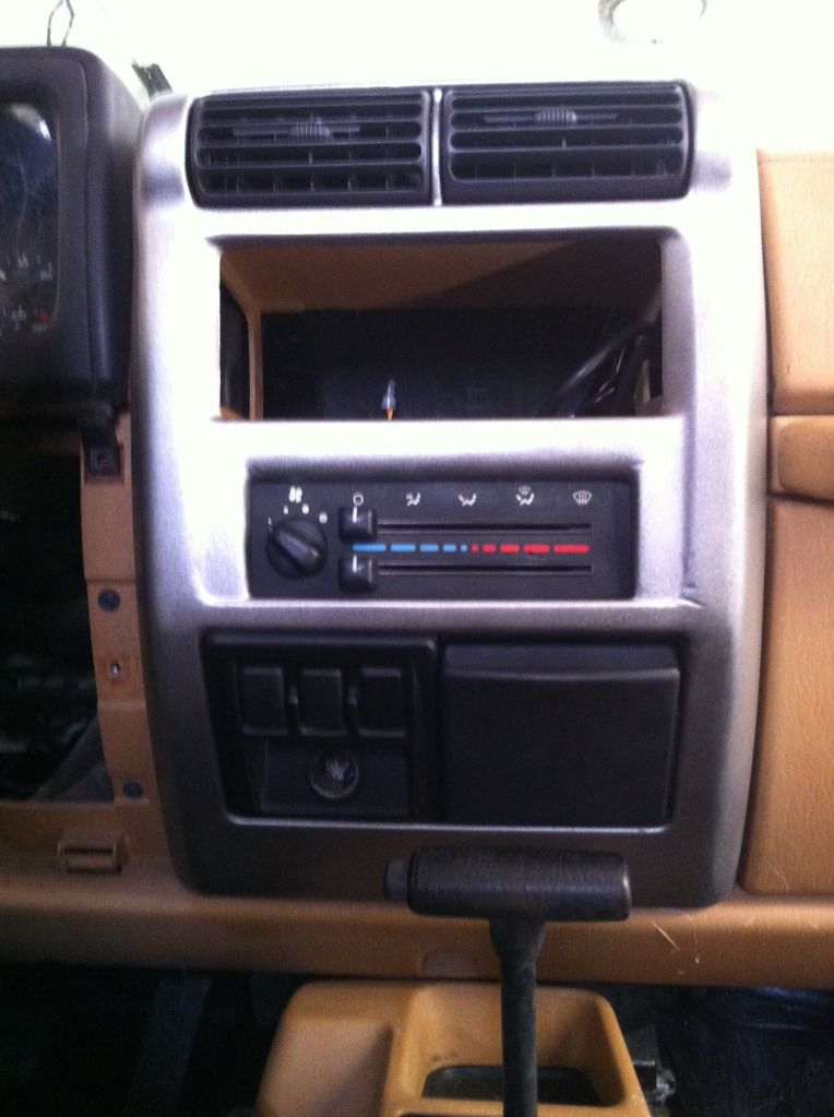

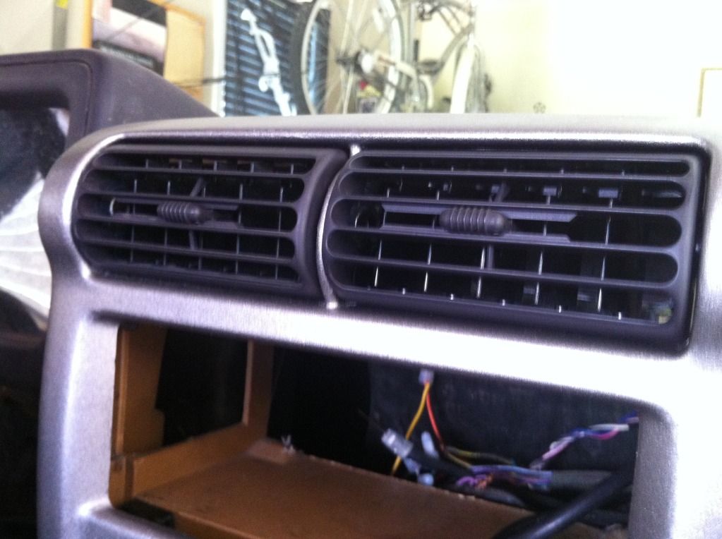

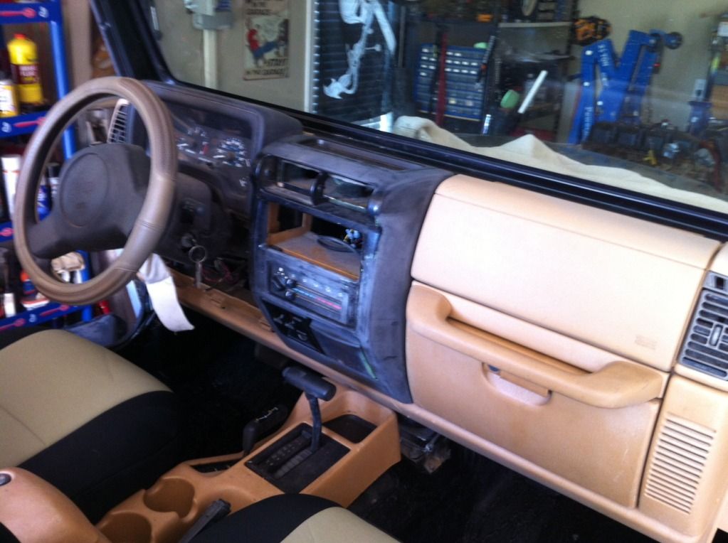

Dash center bezel
So P.O. had sprayed the center bezel with fluorescent yellow spray paint and then about 18 layers of black spray paint. Yeah.
Sanded all that off and removed the yellow overspray with scotchbrite pads.
I found some textured silver paint at Lowe's and decided to go that route.
Owning a jeep is like raising a rebellious teenager: the more you love it and nurture it and buy nice things for it, the more it says, "screw you! I'm doing drugs and drinking because I hate you!"

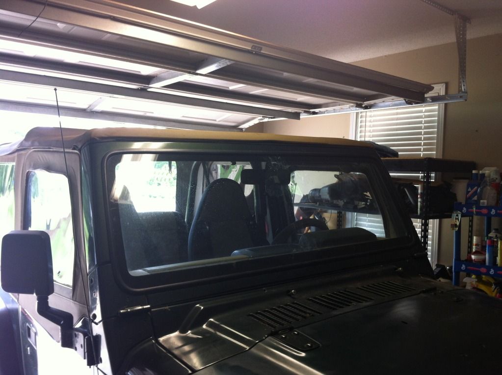

Soft top

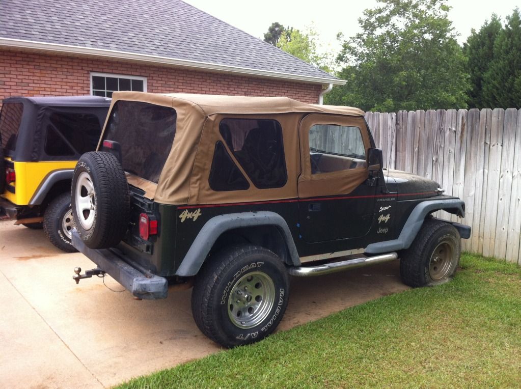

The top on the Jeep is the spice denim. Reasonably new, I decided to leave it. It was installed incorrectly at the windshield channel by the P.O., so we fixed that. After a really good scrub, it all went back on the Jeep.

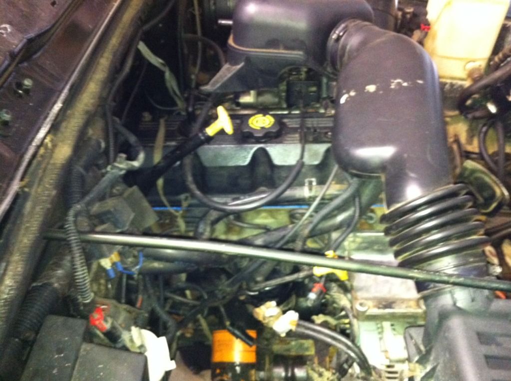

So, being the Craigslist shopper I am, one day I see a guy in North Macon who is selling a 2.5L engine and transmission out of a 97 TJ for $600.00.
I take a ride up there, look it over since it is out of the car and hanging from a chain and we commence to haggle. I got the motor for $450 and he kept the tranny.

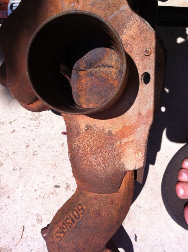

Sadly, I have no pics of the motor when it was not installed. But I do have pics of the exhaust manifold from the old motor that was cracked.
A little frame work...order a new exhaust manifold
And then push the motor in

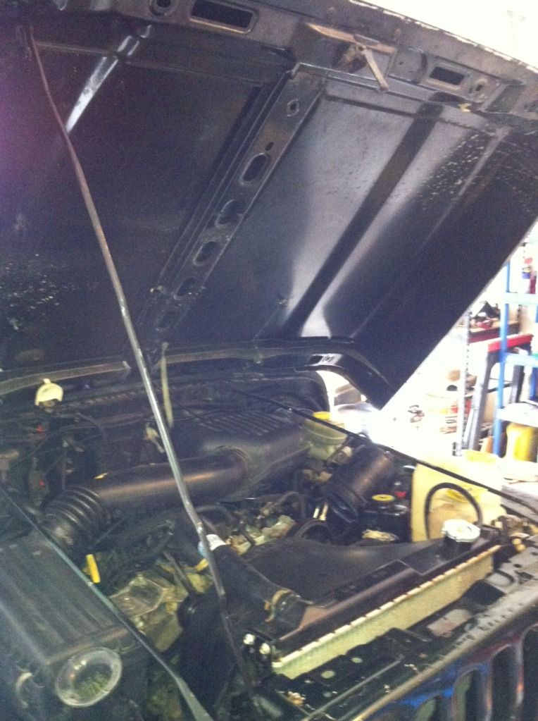

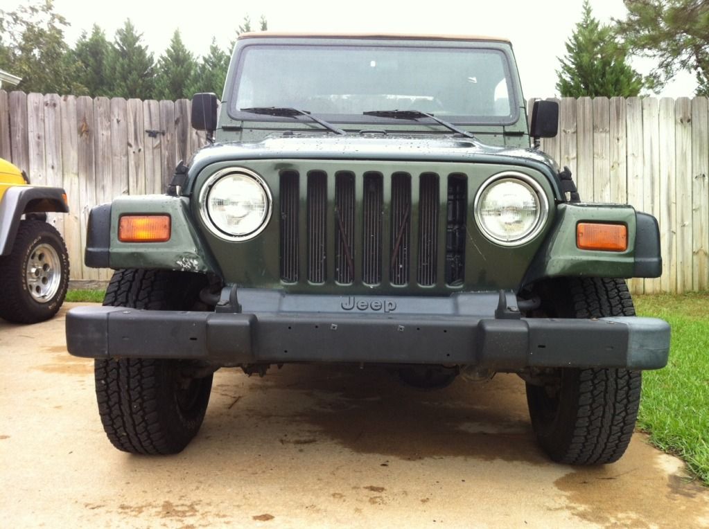

Well now it's August and she rolled outside. Jake's graduation is approaching October 12th and I need to get this baby done.
The hood had a really bad case of clear coat peel.
I wet sanded the clear coat off and shot it with an emerald green single stage paint. Not a pro, but not terrible either.
About this time we also cranked her for the first time. She fired right up and purred like a kitten!

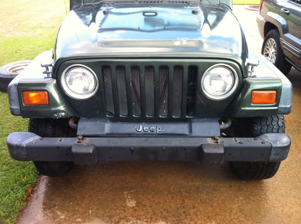

Front bumper

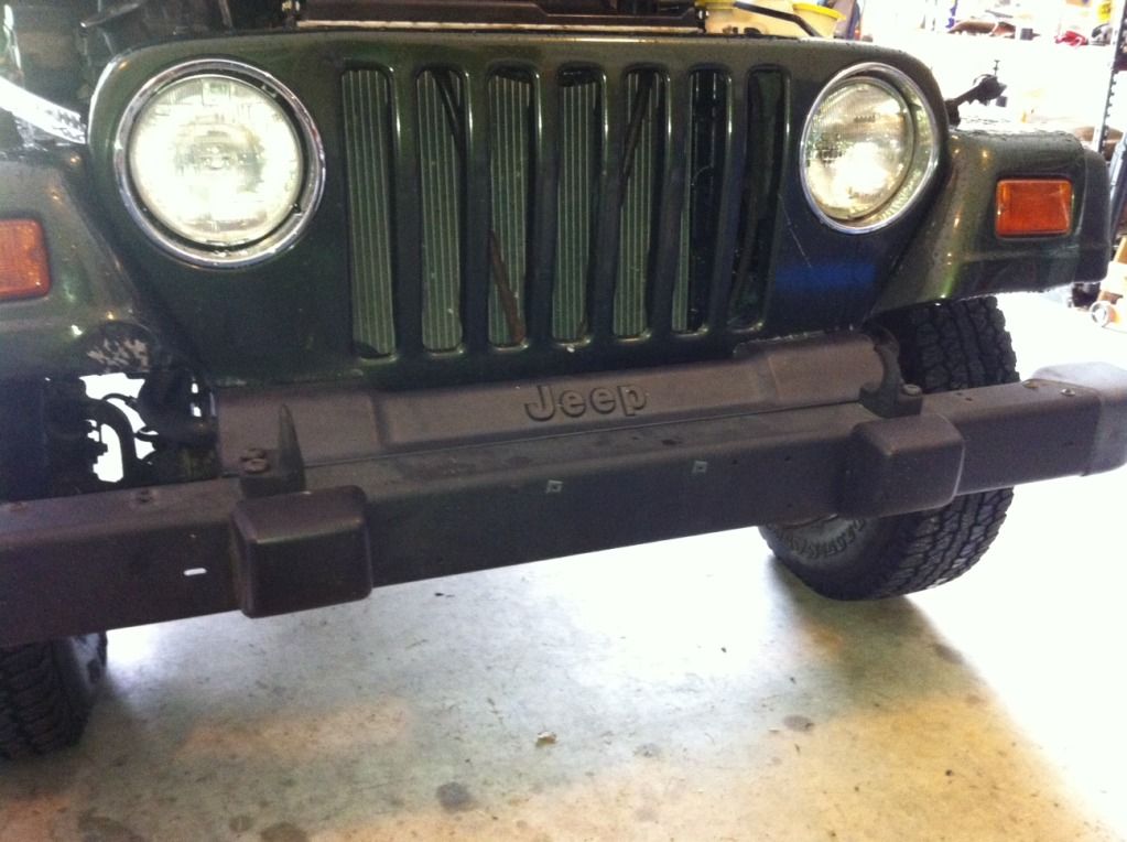

I had to do a little welding on the front frame horns to re-attach nuts for the front bumpers.
I also ordered a hood prop on EBay
