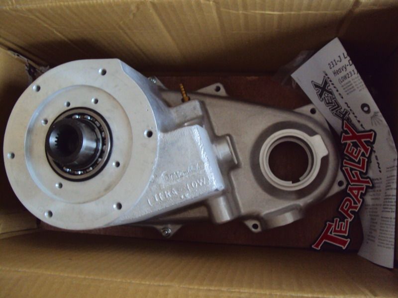

It showed up at my door today so it's time to spill the beans...
It's a TeraLow 4:1 kit. I've been looking for one for a while. Finally decided to just bite the bullet and get one.

Got the TeraLow finished today. In total it took two afternoons to complete; an afternoon to pull it out and pull it apart, and an afternoon to put it all back together and reinstall it. Keep in mind I was operating at a snails pace.
Final comments on the TeraLow:
-The improvement is nuts. With the front drive shaft off, I can stand on the brakes with no foot on the gas pedal, skid the front tires and spin the rears.
-It is damn near impossible to stall this thing in 4 low (in a parking lot). We'll see how it does wheeling but I am already impressed with the improvement.
-All said and done the install was very straight forward. Other than the fact that the snap rings gave me hell, everything went very smooth. The instructions sent with the kit were detailed and helped a lot.
-If you can follow basic directions, you can install a TeraLow.
