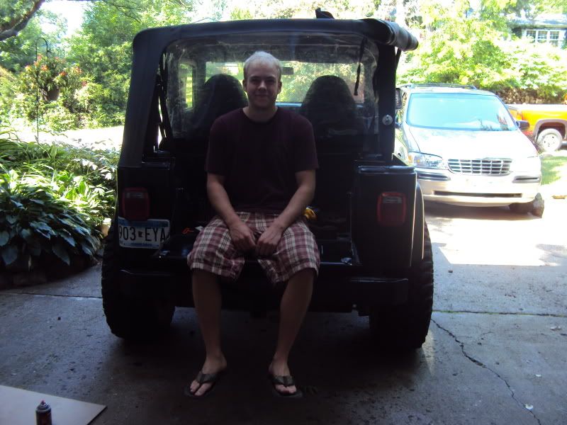

Tailgate pretty much done:
And I'm packed to drive to CO in the morning (with a dana 44 hanging out the back). It's a rolling project:
I still have to clear coat the whole rear. I will do this out west. I did however get it looking pretty damn good and mechanically functioning. The rear of the Jeep is sitting real low. I guess about 400 pounds of parts and other stuff will do that.

Posts: 1,662
How did you anchor the lower hinges to the tub? I don't remember seeing that.
It looks incredible by the way. Great work!!!!

Scroll up a little bit! I made some nut plates by welding some nuts to some scrap steel.

That CJ gate is awesome!

tailgate looks awesome man.. and by the looks of the pic its already being put to use haha

Thanks alot man! I'm pretty proud of it. One of these days I have to shoot it with clear.
It's getting plenty of use...I'm real happy with it.
