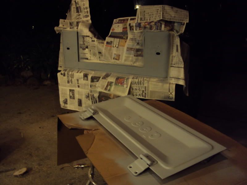

As for progress, last night I got my tailgate and rear end primed. The gate will need to be sanded a bit more, and I'm out of primer. But more progress nonetheless.
Mocked up....

Your hinges are still upside down.
Great progress by the way!!! I can't wait to see it mounted!!! You're getting it done faster than I am.
I know...I'm trying to decide whether to just run em like that or not. Those bolts AREN'T coming out. I went to ace and bought a brand new Torx bit to try and get them free. I broke the bit just trying to get one free. So it's either drill the bolts out and figure out a way to mount the hinges, or just run it. Having them upside down wouldn't be the end of the world to me, but it would be nice to have it all "perfect". Not much progress today. I worked all day. I did pick up more primer, paint, and some tapered Allen bolts that will sit flush and aesthetically match the others. Looking forward to seeing yours mounted as well! Are you planning on doing anything with the "Jeep" part?

Yikes, they're probably stuck good, seeing as CJ tailgates are OLD. But I'm just saying that because some people have put the hinges on upside down, and the tailgate won't sit flat. Just a warning. If it works though, go ahead! I can't wait to see you finish this project. And I don't know, I ran the idea past everybody on my build thread and they seemed to think I shouldn't. Or I should do it with vinyl so if I don't like it, I can take it off. Are you doing anything with yours?
Yikes, they're probably stuck good, seeing as CJ tailgates are OLD. But I'm just saying that because some people have put the hinges on upside down, and the tailgate won't sit flat....I should do it with vinyl so if I don't like it, I can take it off. Are you doing anything with yours?
Trouble sitting flat when up or down? I'm just going to paint it all black...In the future I might get a silver "Jeep" decal. I think that could look clean.

When it's down. It wouldn't go down all the way flat, is what several people said.
I read it HERE so you can read it and decide for yourself if you think it's that big of a deal. Black with silver would look sharp. I'm not sure how Intense Blue and black would look though.
I hear you! As far as it hanging down wrong, I'm not real concerned. With the cables anchored at the right point, it should be able to be set up nice and level.
