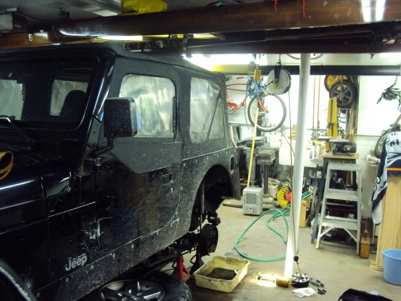

So my rear end has been leaking out of the driver and passenger side tubes and I'm a bit puzzled why. The rear end got new timken bearings and oem seals when I installed the chromo shafts about 20,000 miles ago. I find it hard to believe the bearings and seals would only be good for 20k.
I picked up bearings, seals, and lock rings for each axle shaft and pulled the shafts tonight. The bolts that attach the retainer plates to the housing were all tight. The retainer plates appear straight. The races hadn't spun in the housing. The bearings hadn't spun on the shafts. The bearings aren't broken in any way (other than the bearing and race being in separate pieces...is that normal?). The seals don't appear to be distorted. The bearings had very slight play with the shafts bolted in but I find it hard to believe it would cause such an aggressive leak. Am I missing something?
Tomorrow night I will get the old bearings removed from the shafts and the new bearings will be pressed on.
I think the new bearings and seals will fix the issue...I just thought it was weird they would leak after only 20k. Has anyone experienced similar wear?
Obligatory garage picture.
