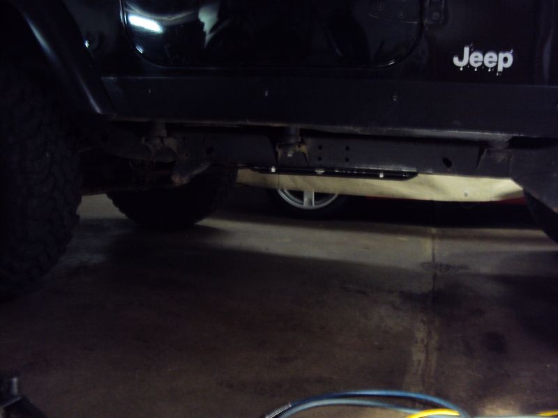

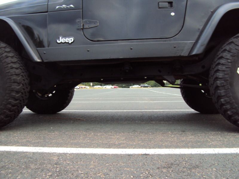

Here are some pictures of the new setup:
Hack N' Tap
Clearance measured before:
Clearance measured afterward
Edit: Given that my garage floor is slanted, the measurements aren't right on. Once on flat ground it measured around 18". Regardless, I gained around 3":

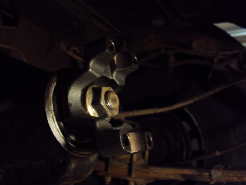

I got the new 1350 pinion yoke in tonight...I also went ahead and replaced the pinion seal while I was down there.

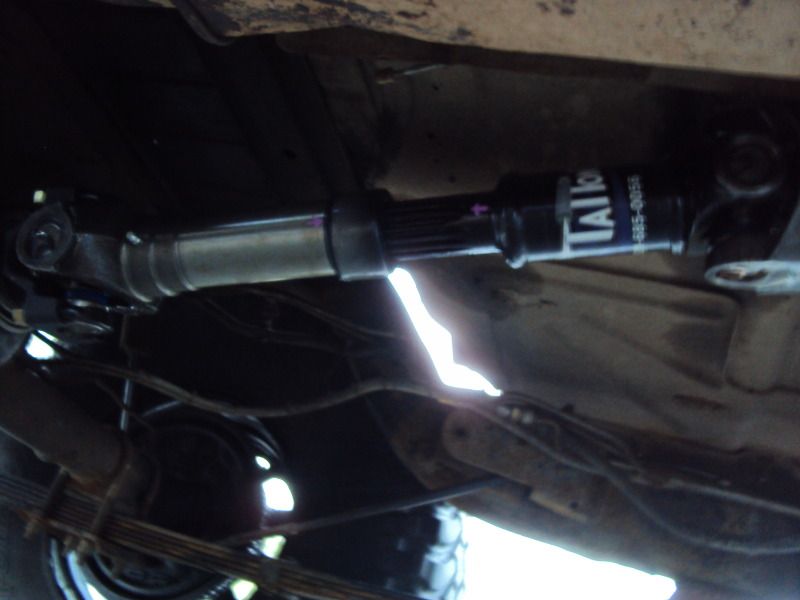

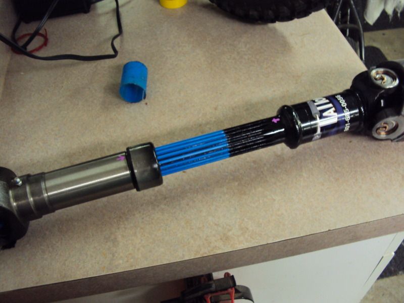

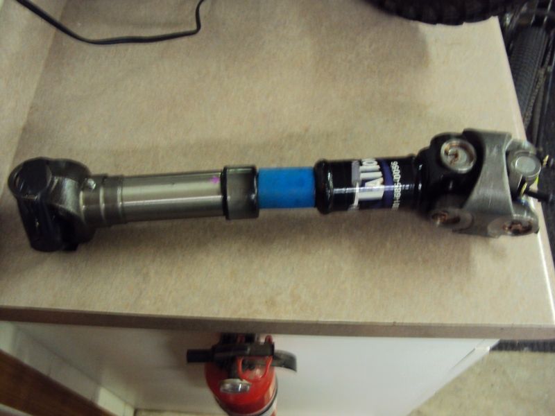

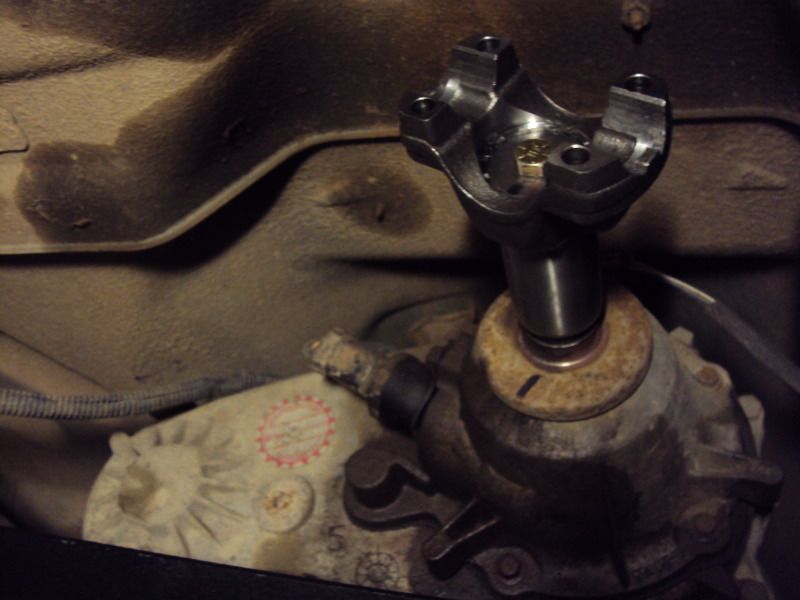

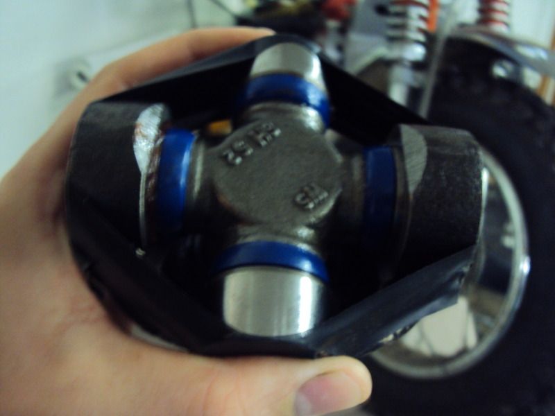

My new drive shaft showed up. I ordered it through Curtis at Tatton's driveline. It's a CV shaft with .120 wall tubing, balanced at 100 mph with a 1350 end yoke and a 7" slip spline and all Spicer brand U joints. It was $300 shipped which I felt was a fair deal. I'm pretty satisfied with the shaft and the service. It took exactly one week for it to show up at my door. I also picked up some anti-wrap leaf perches to dial in the pinion angle with the new set up. It'll be nice to drive around in rear wheel drive again!
Extended
1350 end yoke
Originally Posted by gribbles View Post
jeep looks good bud. Haven't checked in a while
dont be ashamed - I love my my rc crawlers
Thanks man! It's getting there. So since we're running a similar setup I'm curious. What leaf perches are you running? Are you still running the stock XJ leafs w/ the extra leaf? Any axle wrap? And the RC crawling is a damn good time!

I fiddled with the Jeep a little tonight. I've been driving it back and forth from work in front wheel drive for almost two weeks now. Tonight I put the rear drive shaft in (which I am very happy with). I also puttsed with the transfer case shifter, adjusted it to use two high through four low, and added a couple of springs to one of the cross-linkages to keep it from popping out. It isn't quite as smooth as before but it works well. The pinion angle is low a few degrees but it doesn't have any vibrations up to 50 mph. I'll have to open it up on the freeway and make sure it's vibration free before my voyage out west. I'll be replacing the muffler with a new one to quiet things down a bit and it should be rocking out. I'm pretty excited to have this little segment of the Jeep project wrapped up!
