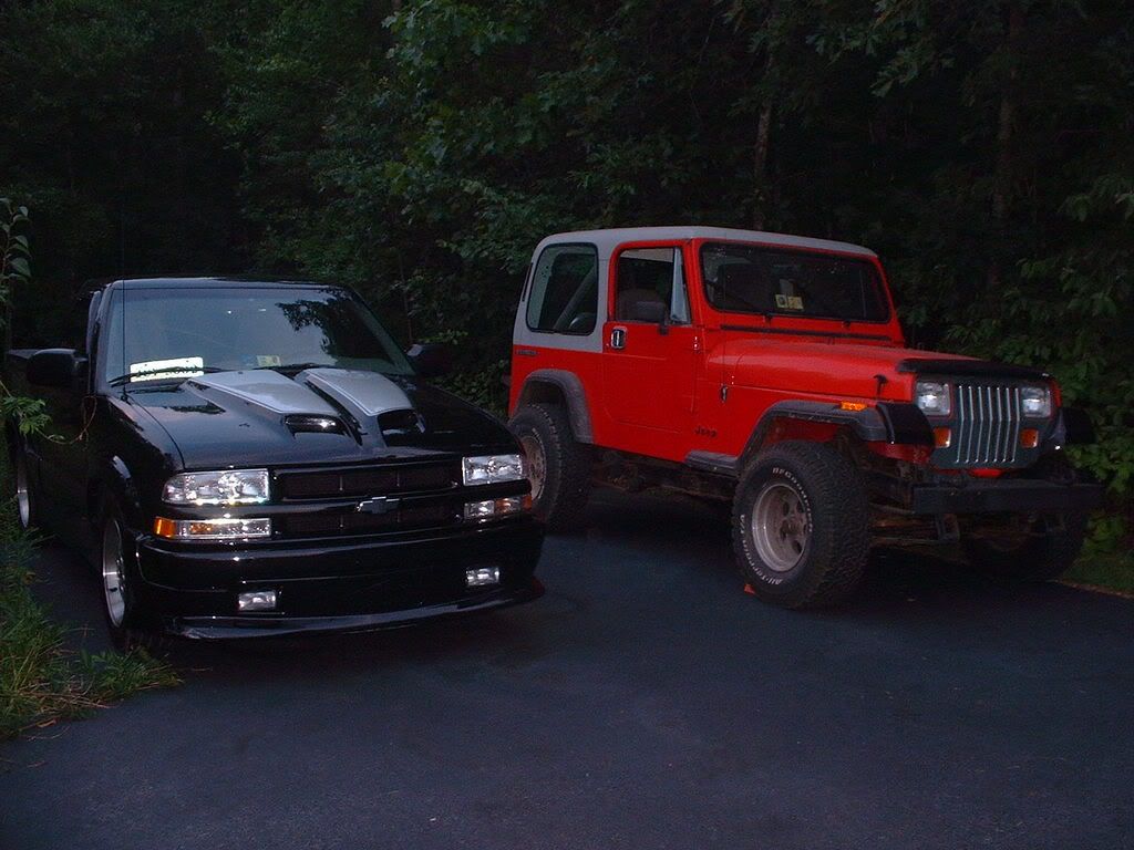

[QUOTE=kyle_craig;9628079]
Those IROCS looked sweet on that S10
Guess what I had the day i brought my Jeep home.....
Josh
Good lookin' truck my friend
