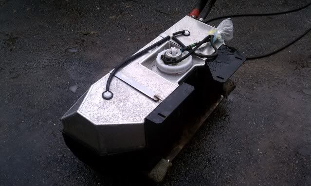

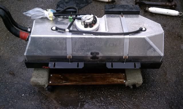

Alright well I might as well let everyone in on what I have up my sleeve...The first item is on it's way to me from MA as of today, the second I went and picked up this morning:

Sweet tank! What did you pay for that?

Nice score! Take a look at my build & note the issues I ran into with the install. The upper shock mounts needed to be trimmed on mine to fit the tank in. Not sure if yours will need it, but just a heads up.

I'm very excited about the tank. The guy was asking $750 plus $75 for shipping, we negotiated it down to $650 shipped. Which I felt was pretty fair. I was either going to go with a used Genright tank, or a new PureJeep tank. But I'm frugal, so used it was! I'm definitely looking forward to both the look and the functionality of a CJ drop-down gate.
Thanks, I thought it was a good score too. I rarely spend any time on Pirate, but I saw this in the classifieds and made an account just so I could PM the guy. And thanks for the heads up! I'll take a closer look at your thread and prepare for what I might run into!

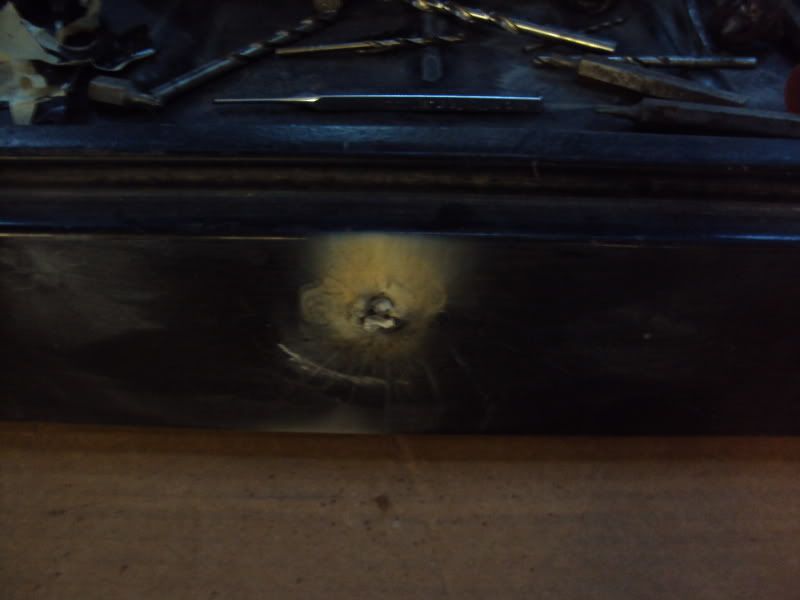

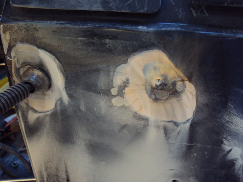

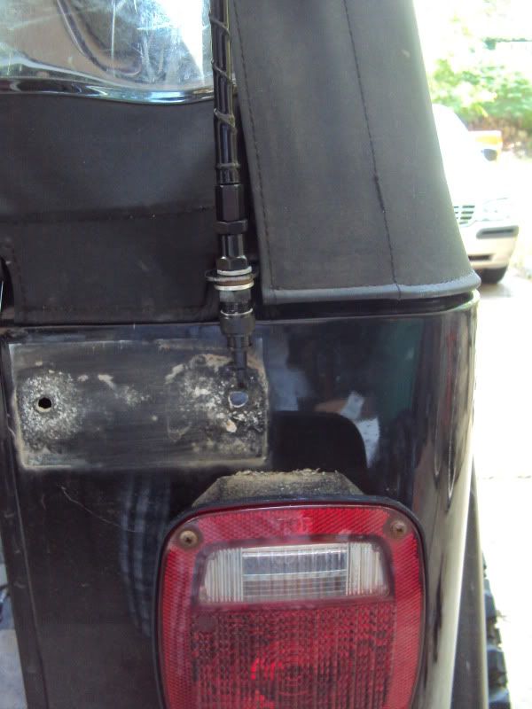

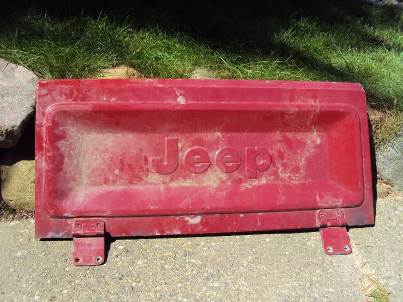

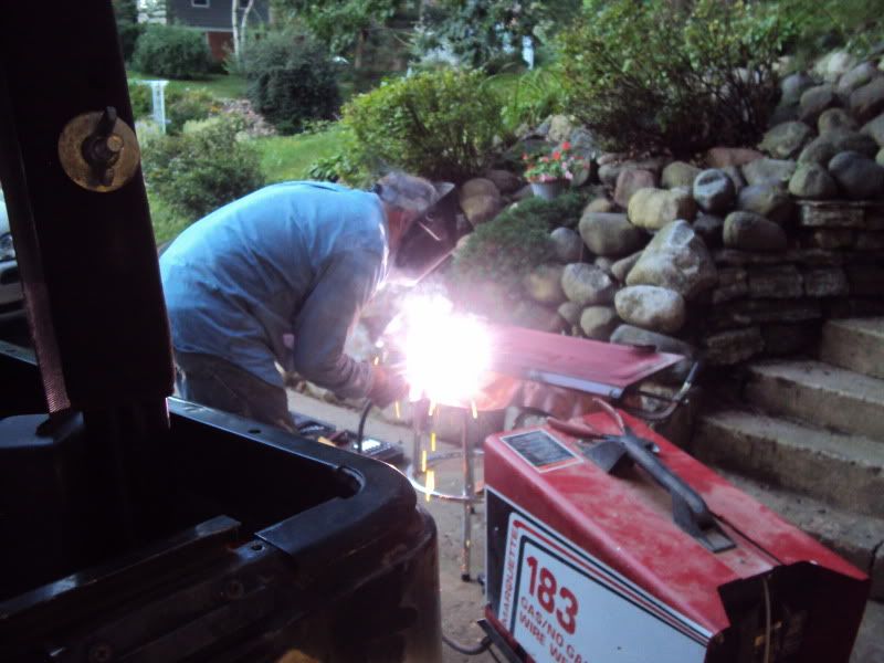

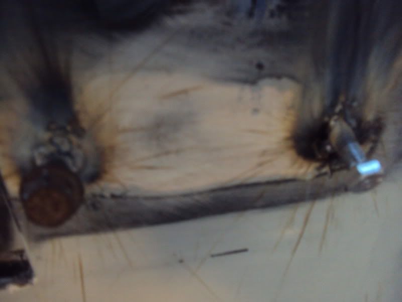

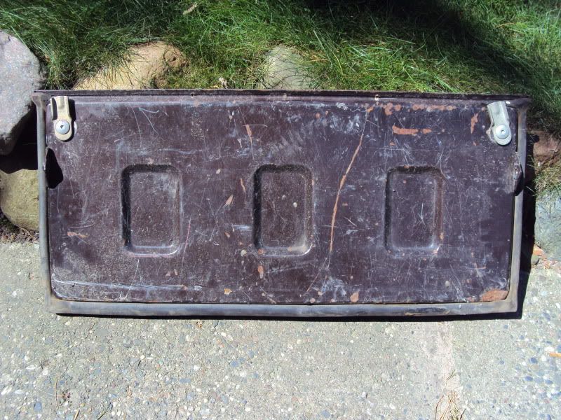

In other news: I made progress on the tailgate swap today. I woke up and pulled the old tailgate off. I had to drill the torx bolts out to get the hinges off. A guy came and picked it up for 40 bucks. So thus far, I'm breaking even on the tailgate. I also made a new CB antenna mount. Before it was mounted to the spare tire carrier on the old tailgate. Then my dad and I busted out his welder and welded some holes shut.
CB antenna mount:
Holes welded shut in the tub. We actually threaded bolts in, welded them in, cut them off, then grinded them flat.
The tailgate had small holes drilled along the top lip. Picture is of my dad welding those.

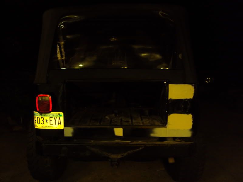

Then in the dark, I applied bondo to the tub and tailgate. It was too dark to get a good picture of the bondo on the tailgate.
Tomorrow if I have time after work I'll be sanding the bondo smooth, applying primer, and sanding some more. I also decided not to sandblast my tailgate. The orbital sander took all the paint I needed to off on both the inside and outside. I'll post more pictures when I can!
