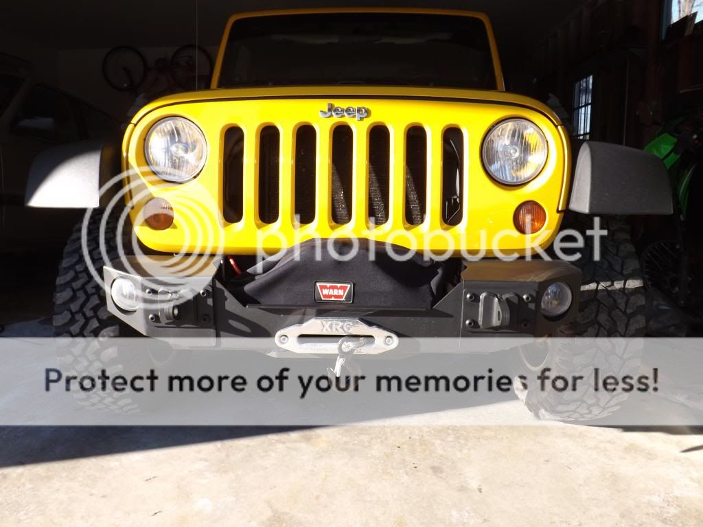

Looks good. Check out the RC hybrid stubby for a cheap, good looking, and strong bumper. If you search a few threads you can actually see mine (also detonator).
Edit: Here you go.

Very nice! Good to see another detonator. I have a Poison Spyder Brawler bar in the works. Trying to get the engineering right for their Brawler stinger with plate steel instead of DOM supports.
What winch are you running in that thing?
Ahhhhh. Makes sense to me now, otherwise I would have warned you to stay far away from PS.
I have a smitty XRC8 comp in it. I had an old non-comp version and it served me quite well and even survived a head on collision and kept working. I have never had an issue with it and had to have done upwards of 100 pulls (mostly trees and other vehicles). I wouldn't count it out if you are looking at winches.
