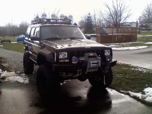

When I first bought it off dad (I was doing work prior to get it to the point where I would just be able to drive the sucker):

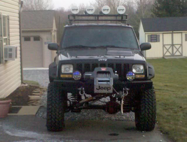

Then finally when I got it on the road sitting in front of the house:
I had to put the Mickey T's on because the PRO-COMP steelies where way too hard to balance and actually seemed to be out-of-round.

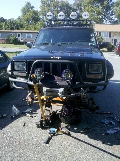

Like I said, this things been through stages of lifts... before it was driven...Dad originally started with 32 inch tires, but decided to run 35's. The funny thing is, I had already installed 4.11's. I kept the 4.11's with the 35's for one trip. 35's with 4.11's on a heavy a$$ XJ just doesn't work on the highway. First trip to VA confirmed that. It would constantly hunt gear, trans ran way hot. So, I decided to put 4.88s in.
And a TNT truss too..

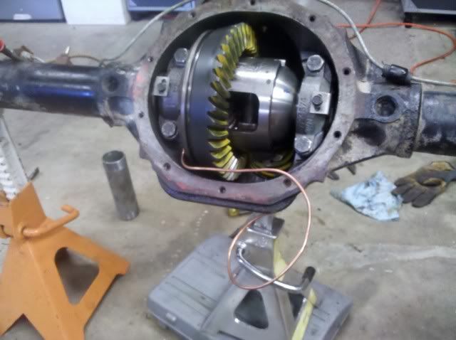

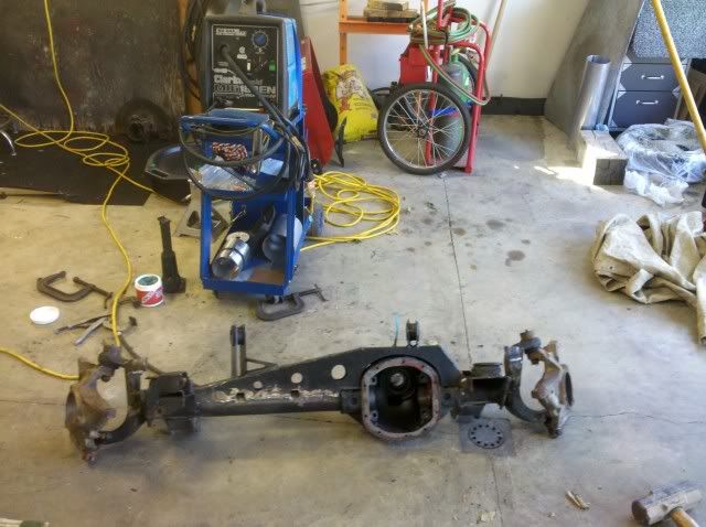

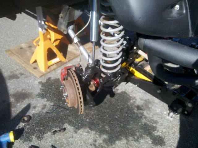

I don't like working gearing on the ground, so I pulled the axles to do it. One at a time, of course.
See that OR-Fab bumper? The whole purpose of that was to get the winch out of the front of the radiator. If you look at the first couple pics, dad put a Warn bumper on originally. Thought it blocked too much air and caused the Jeep to run hot. Then the Warn 9.5ti had to come off because it DOES NOT fit in the OR-Fab tray. I should have called OR-Fab because the place I bought it off of did not know that. So I ended up with the Smitty XRC 12k on the front because it fits. I come to find out the Jeep ran hot because dad (in his infinite quest for gauges) put a water temp gauge fitting in the engine coolant outlet hose that necked down from 1.25 to 1 inch. DOH!!!!! So I bought all that ended up only needing a $17 part to help with the cooling issues. Dad says he like the Warn bumper better. Ha! Thanks Dad....
I will say the 4.88s make all the difference. The drivetrain just doesn't work as hard. With the 4:1 tho, low range is not an option over 15-20 mph. The engine is screaming. Might be a good excuse for an Atlas? Hmmm....

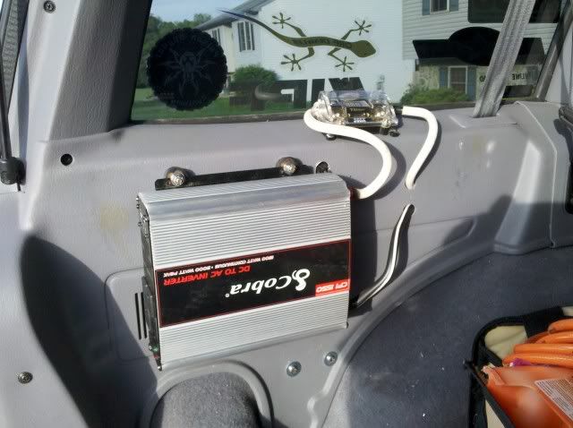

One of my more recent editions - the cobra DC/AC inverter I inherited from my dad since he didn't need it in the truck anymore. Bought a nice set of jumper cables, cut the ends off, and ran them from the battery to the inverter at back of the Heep. Works well, says 3000 watts, but 1500 is nominal. I can run drills, computers, etc. off of it. Nice to have when camping.

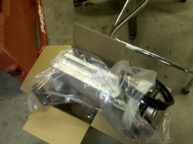

FP issues

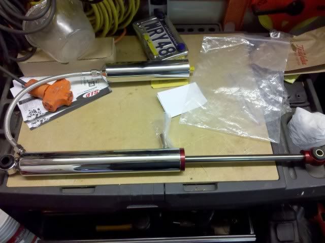

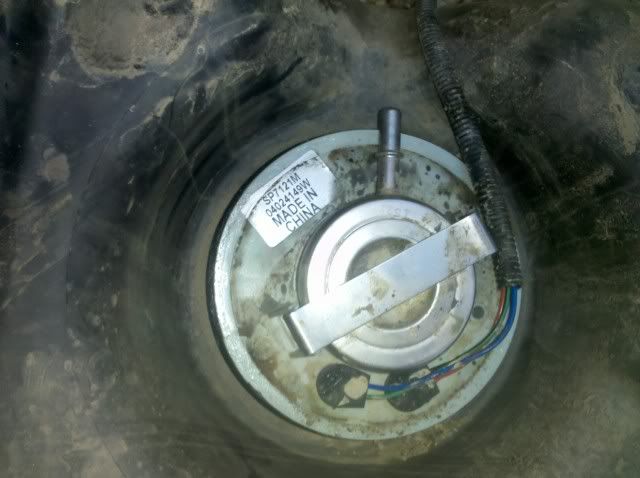

This came today to replace my current in tank pump. This will be the third FP in a year. Airtex, Spectra, now Carter. I am tired of replacing them but I am also getting good at it. The problem isn't the pump itself, it is the check valve in the FPR at the top of the assembly - it fails. Airtex lasted probably 250-300 miles. Spectra lasted maybe 50 miles. WTF. The Carter is made in the USA (actually Federal Mogul), so hopefully that makes a difference.
Also, despite what you might have heard, seen, or read, the inline (BMW) check valve does NOT (read: DOES NOT) work on 97+ Jeeps. On 96 down, yes, this will work. The check valve holds the pressure. ALL OF IT. When your Jeep is cold - no problem. But when she gets hot, you get expansion. Pressure rises above 100 PSI, easily. This will blow out Orings, or worse an injector. The FPR is designed to relieve pressure to 40 PSI when the Jeep is shut down. There's plenty of people with experience out there, do a google search.

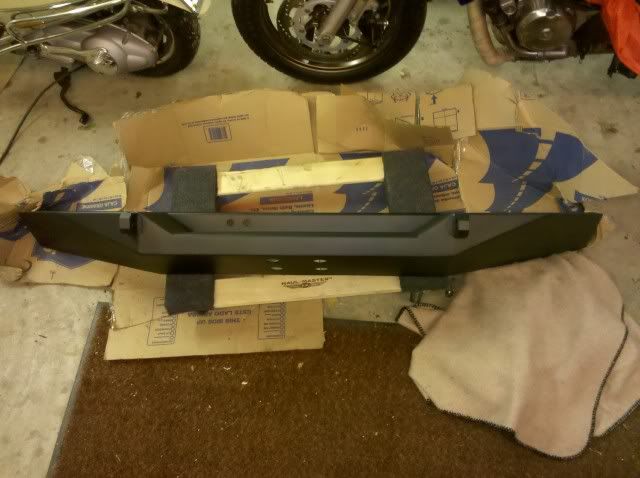

Ebay bumper all painted up. Not sure when I will get time to install, probably when I weld up the front frame stiffeners. I want to add a hoop to it. I like it better than the OR-Fab, but it will raise the winch. Don't get me wrong, the OR-Fab bumper is beef, it's just sitting about 2 inches lower than this one will. That's the thing about this stuff a lot of times you are trading one thing off for another. Anybody want to offer to buy my OR-Fab bumper to give me some incentive to take it off?!
Used VHT epoxy paint as a base. This stuff is the shiznit! Trust me. You have to let it harden though. It is rock hard after a week.
Second coat is Rustoleum spray on bedliner. Also very tough stuff. I use it on my flares and rock rails too. Touch up is cake.

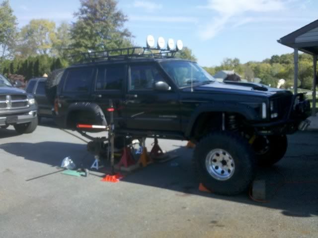

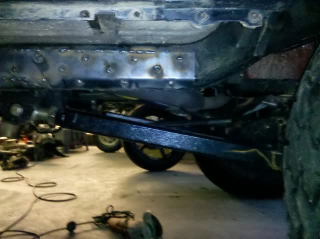

The original setup I installed. The RE short arm with drop brackets. It's a good alternative to a long arm. Rides great. Clearance was non-issue with 35's and it flexed good. I got a sweet deal on a Clayton long arm so I sold it.
Installing the long arm and HD Engineering Unit Body Stiffeners. The unit body stiffeners have a ton of holes in them to weld up. It takes longer than you'd think. Sorry about the crappy cell pic.

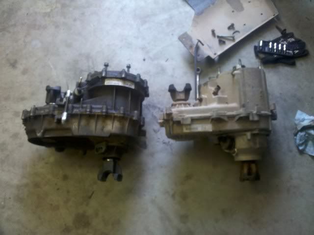

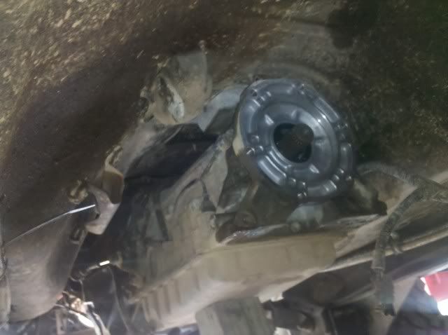

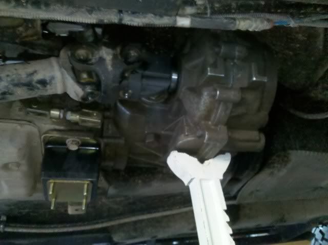

Roctrac 241OR vs 231J. Bench pressing that sucker in was non-issue, and it fits with no issues. Got this tcase on the cheap.
Back of the trans
Ready for the Clayton crossmember. Clayton makes it bomb-proof. I have no doubt it makes the station wagon stiffer. You can see the novak shifter up front. It is so much better than the miles of linkage Jeep bubble gummed up. It's worth the dough.

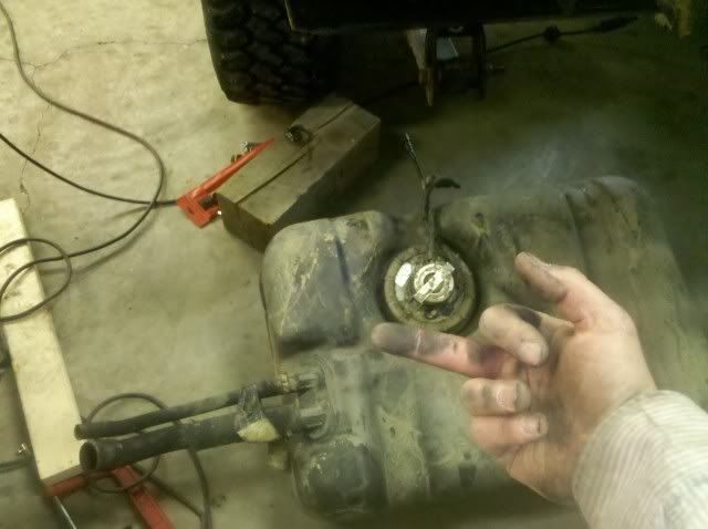

Just got done doing my favorite thing! Changing the fuel pump.... let's hope 3rd time is really a charm.
The problem:

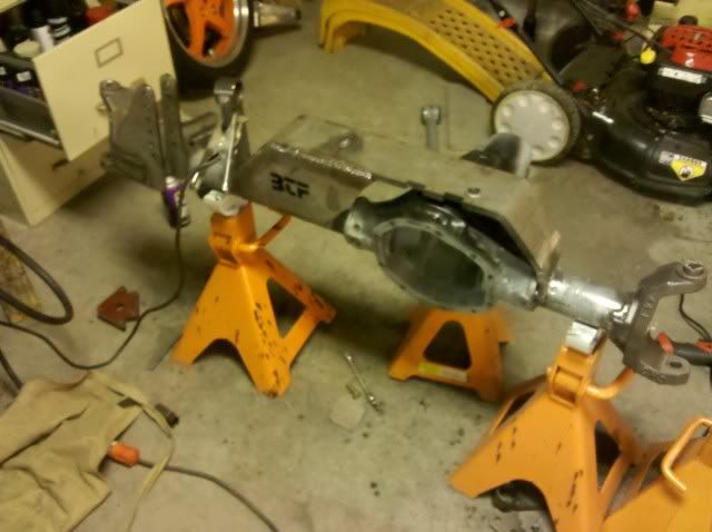

Worked on Welding the Clayton brkts up to the 44 today. Since my cell phone is a POS, it didn't save the pic, so I will throw up a pic of a recent score I stumbled upon: Edelbrock Extreme travel IAS shocks for the rear. Let me just say, I do not like chrome on the Jeep, but these are nice. They are valved for an F250, and they work great on the heavy a$$ XJ. The best part of it all? $60 each, shipped. You can't beat it.
