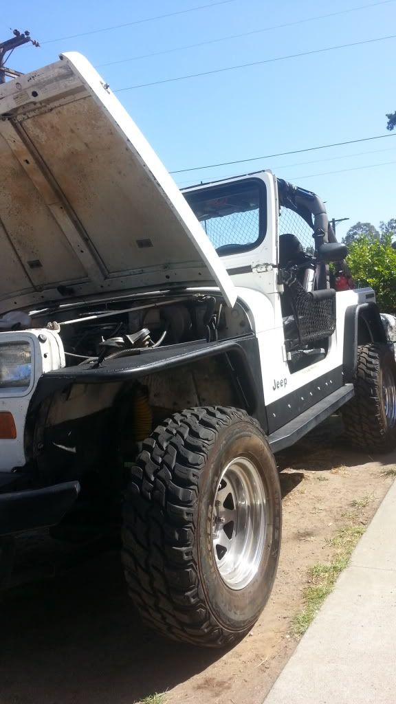

Update 06/15:
After speaking with Brycen who has been very helpful and doing some research along with everything posted itt, I have made up my mind and ordered OME 36r springs
Will be placing the order for Bilstein 5100s as soon as the money from superlift hits my account.

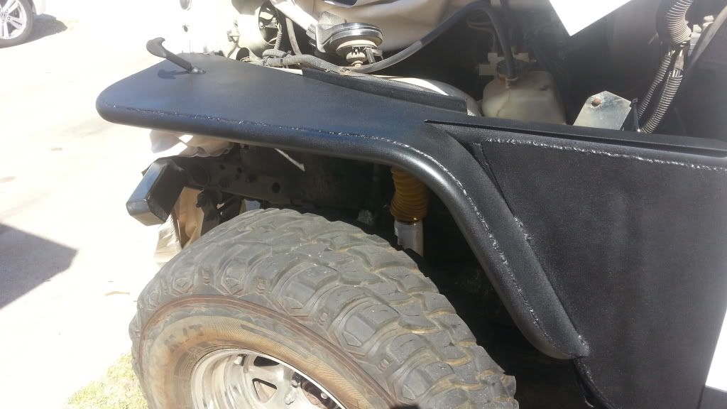

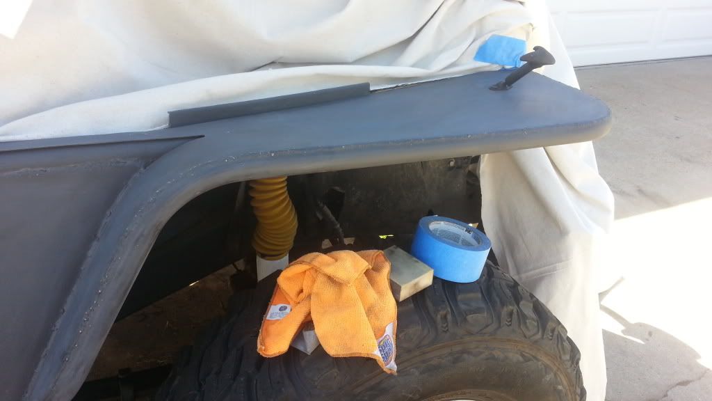

Meanwhile I couldn't stand looking at the primered tube fenders, went ahead and sprayed with bed liner. Harbor freight canvas blanket came in handy:
Sprayed inner fenders with flat black after lots and lots of sanding
Passenger side:

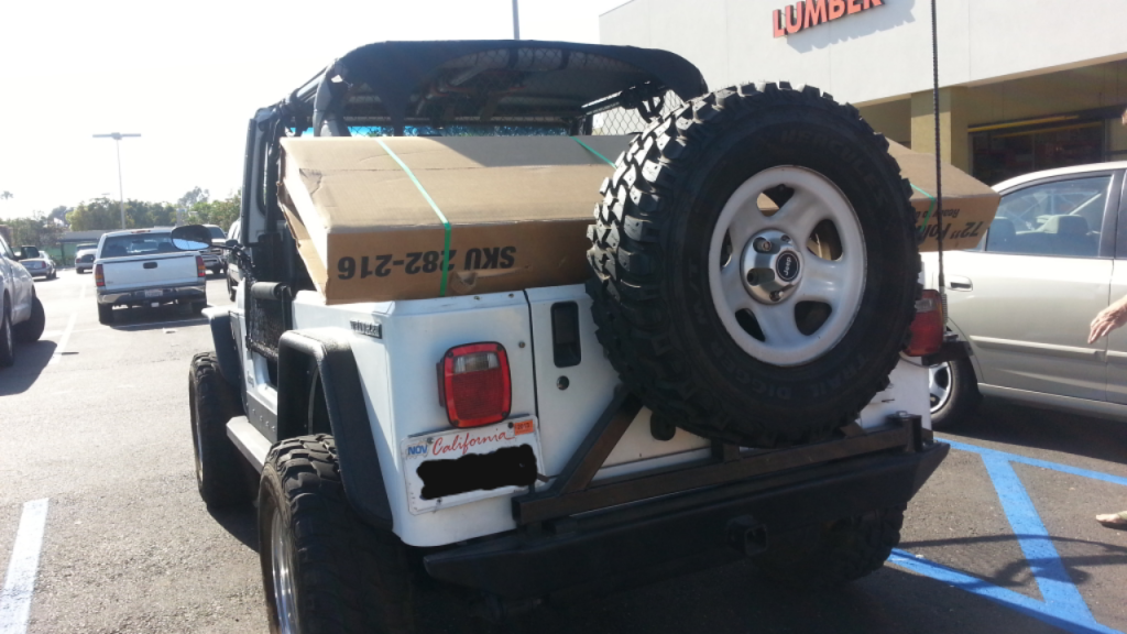

Had to make a quick trip to home depot, saw a nice little work bench made in USA for $69 Figured I can use one over the plastic table we've been cutting on:
people say you can't fit anything in Jeeps
all setup in 4 minutes rather than 3 as advertised, but I'm very happy and have a real bench to work on
