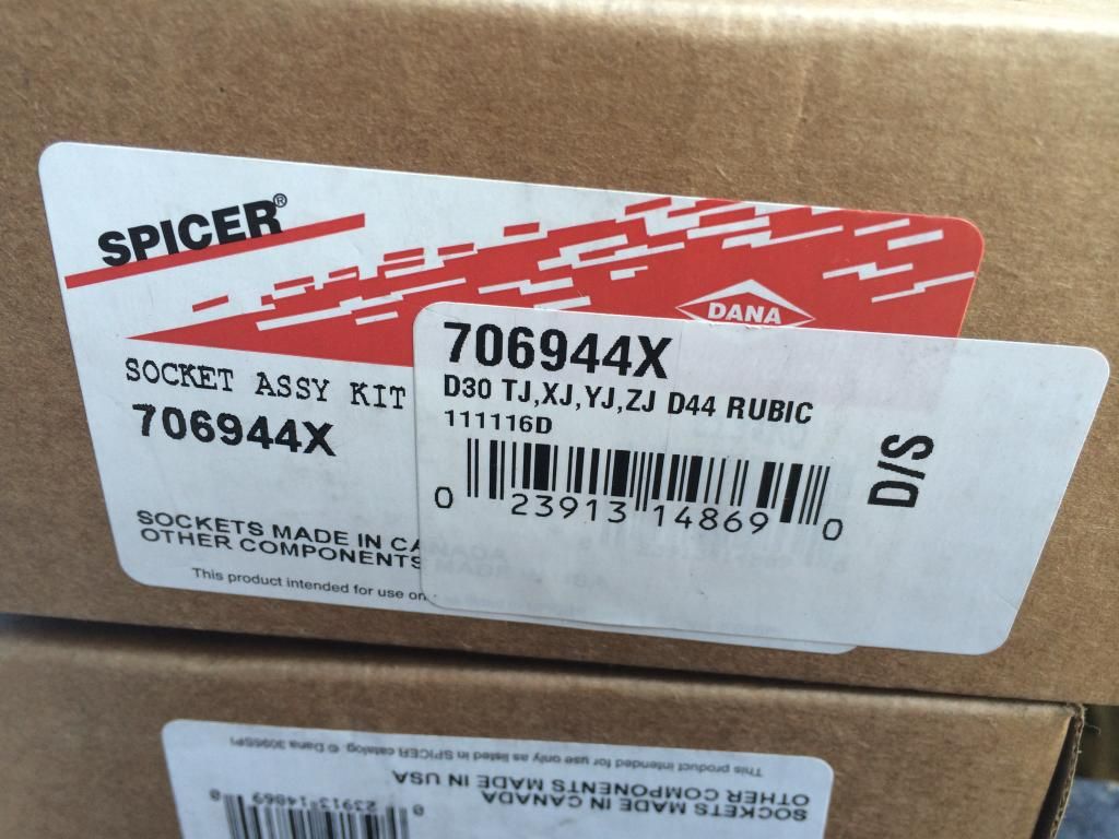

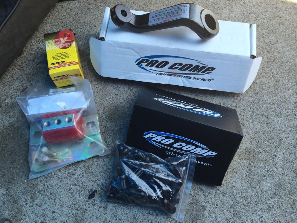

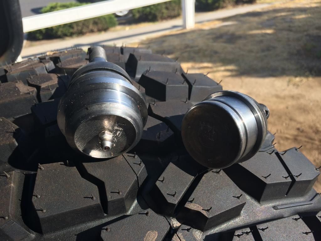

Some more goodies came in today. Since I'm building the transmission crossmember and been reading a few things on cracked transmission housing. Decided to use Energy poly trans mount in conjunction with a custom made DOM crossmember. Once that's in, flat 3/16" or 1/4" (haven't decided yet) for skid plate. Pro-Comp drop pitman arm will get the angles close to where I need them and new Spicer ball joints should work well with 35s. I also got a set of black Pro-comp lugs to replace some old beat up ones:
I dig the stainless steel look:
