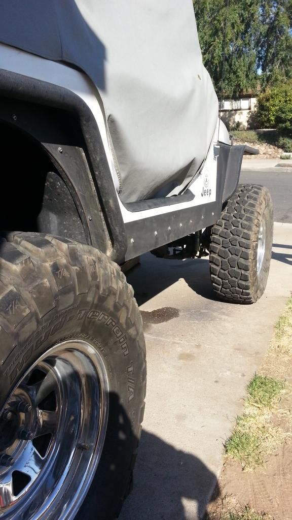

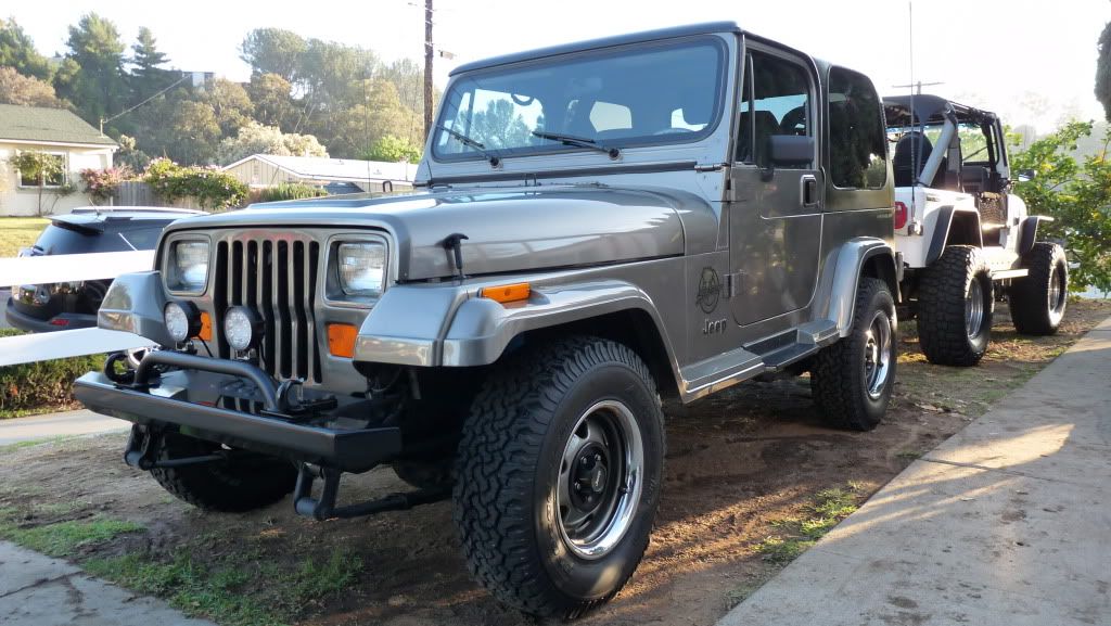

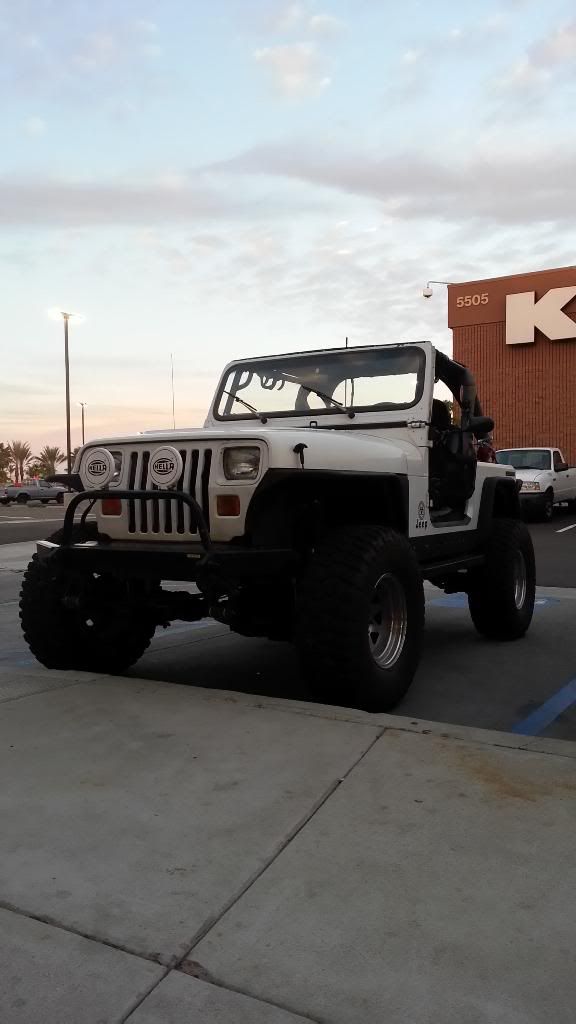

Couple of pics of the new stance during the day:

We finally got a chance to install the 1" Daystar leveling kit. Very straight forward install, all the bolts broke lose using simple hand tools and new ones went in no problem: Finished product: I'm digging the new look, no more rub!
Just pointing out its a bl and not a leveling kit, looks good by the way!! And ftw I run and swear by brown dog!

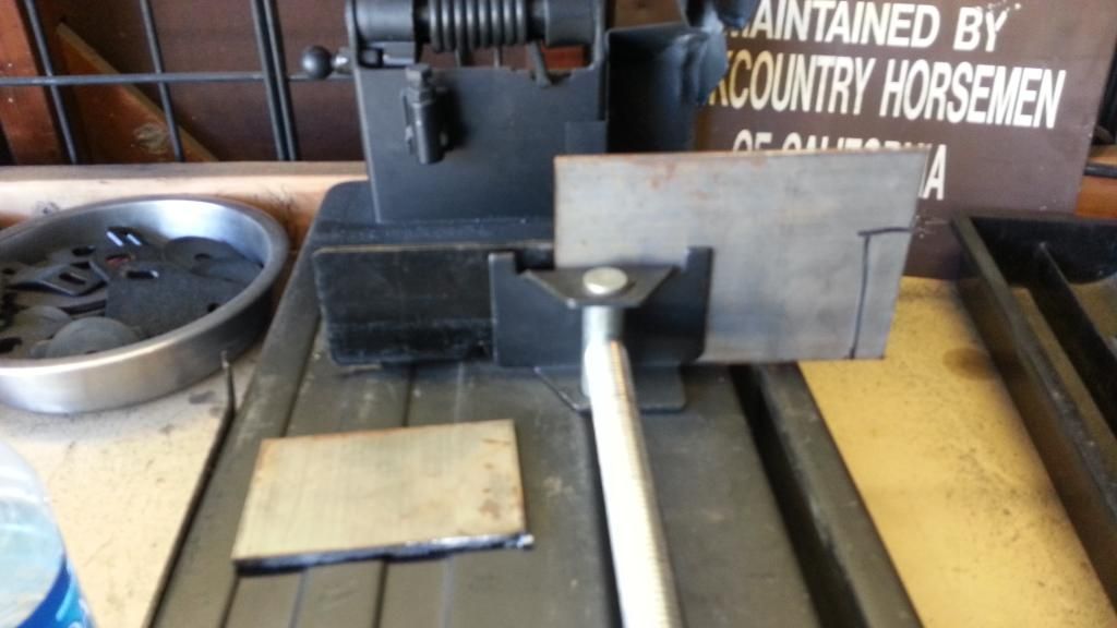

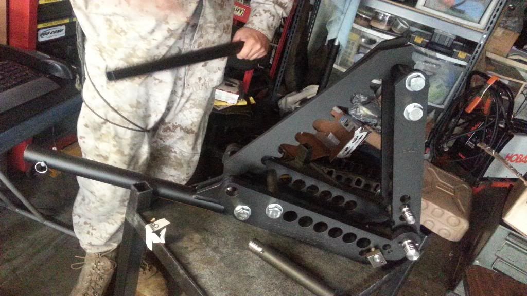

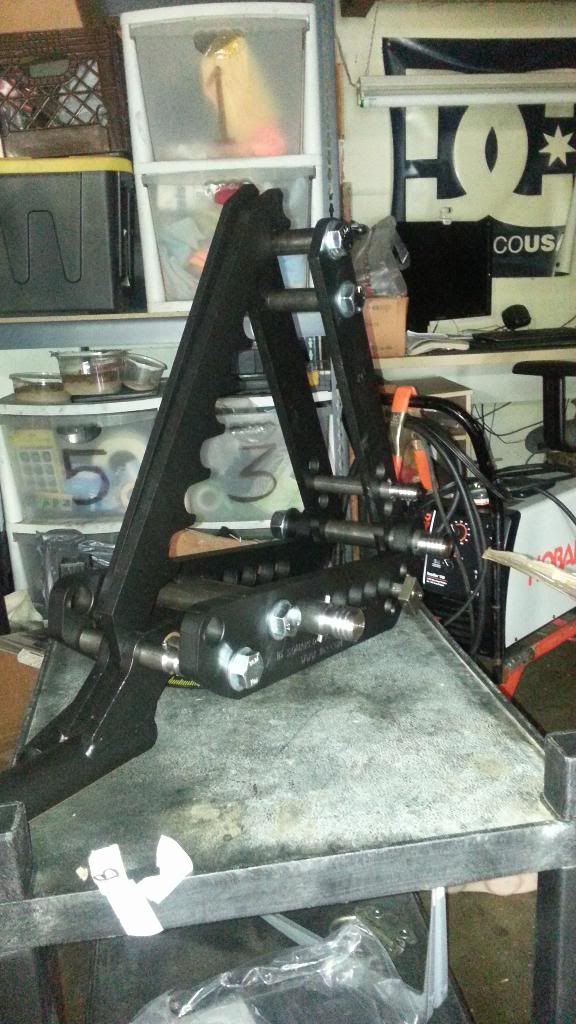

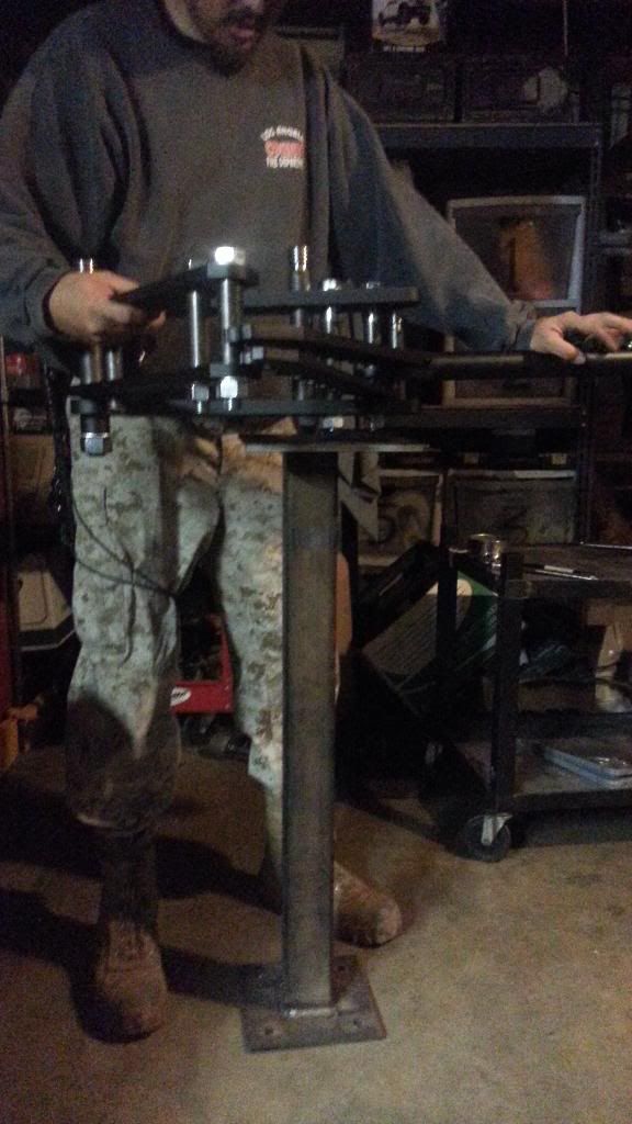

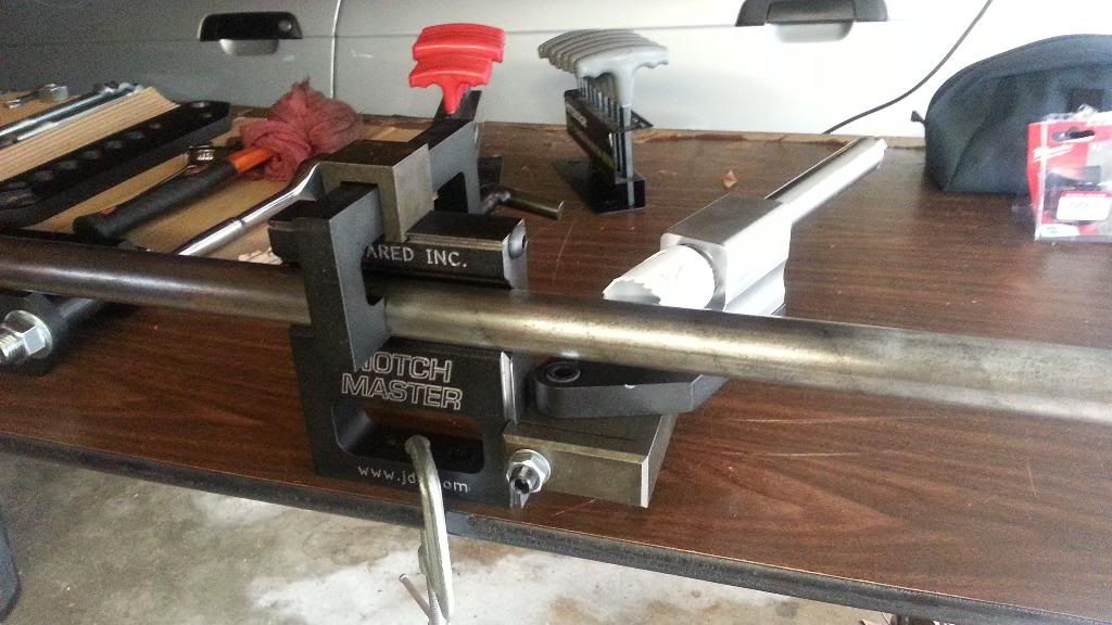

Meanwhile we got the notcher and bender assembled. Still have to weld up a stand we already picked up metal for!
These things are freaking beefy, love the quality so far, can't wait to put it to use.

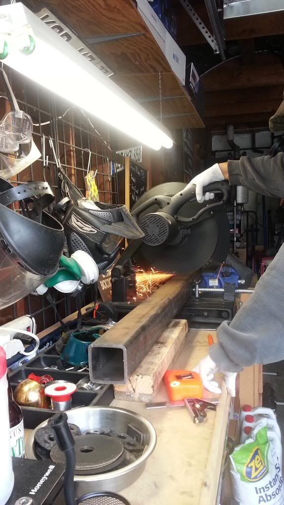

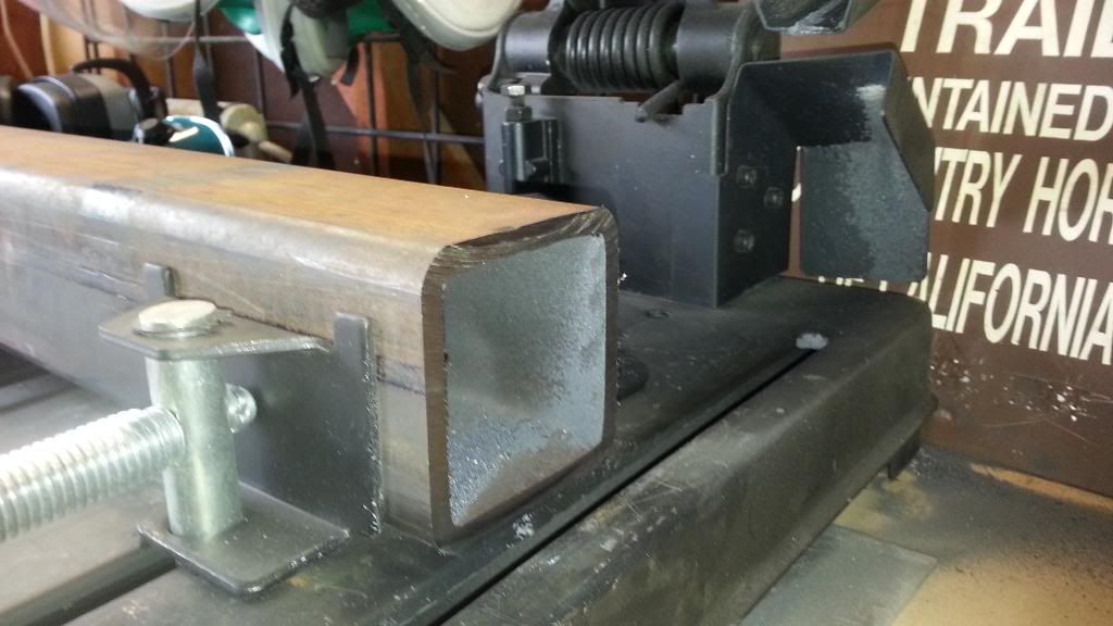

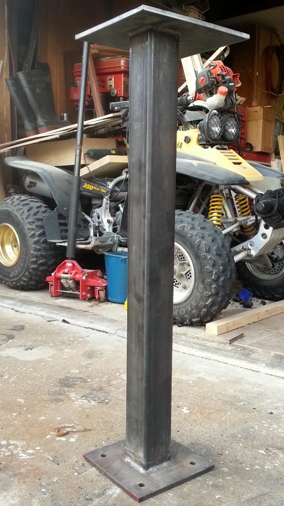

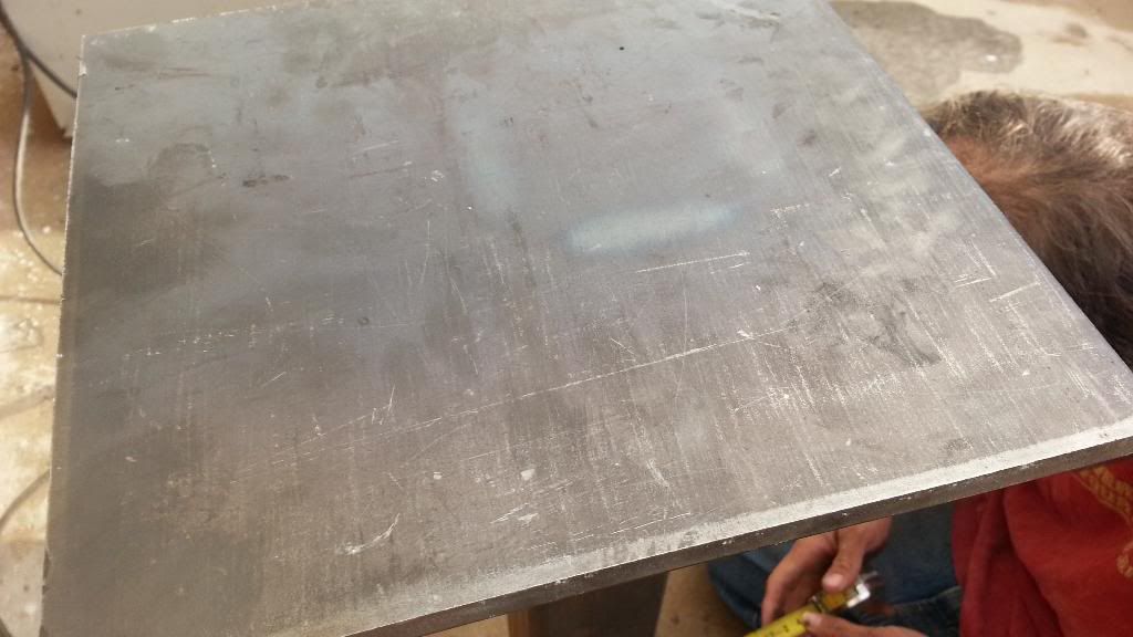

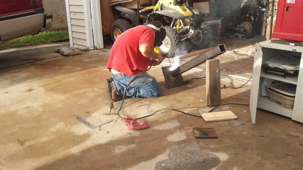

We had to make a solid mount for the bender to sit on. Got some metal from a local shop at a decent rate, cut it home on our chop saw:
Nice and straight cut, took 10min or so to cut:
Took to my buddy's house for a proper 220v arc weld:
Got through 3/8th plate:
Ready for paint:
Test fitting the bender:

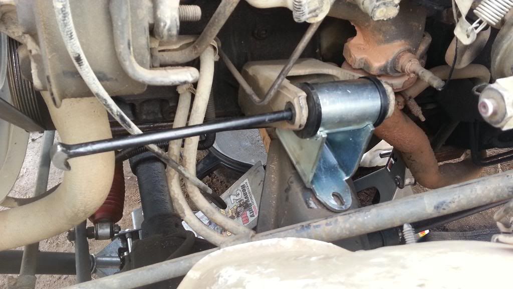

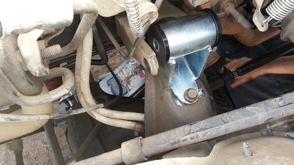

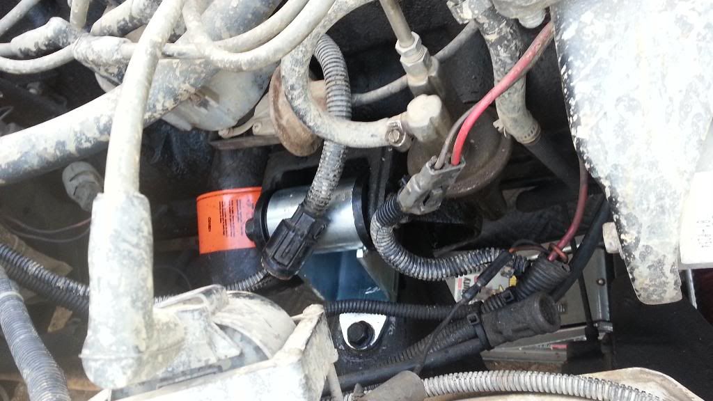

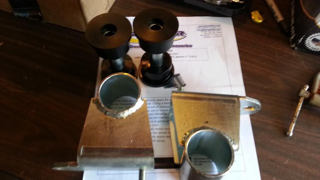

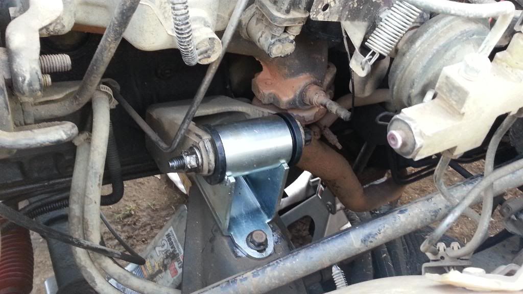

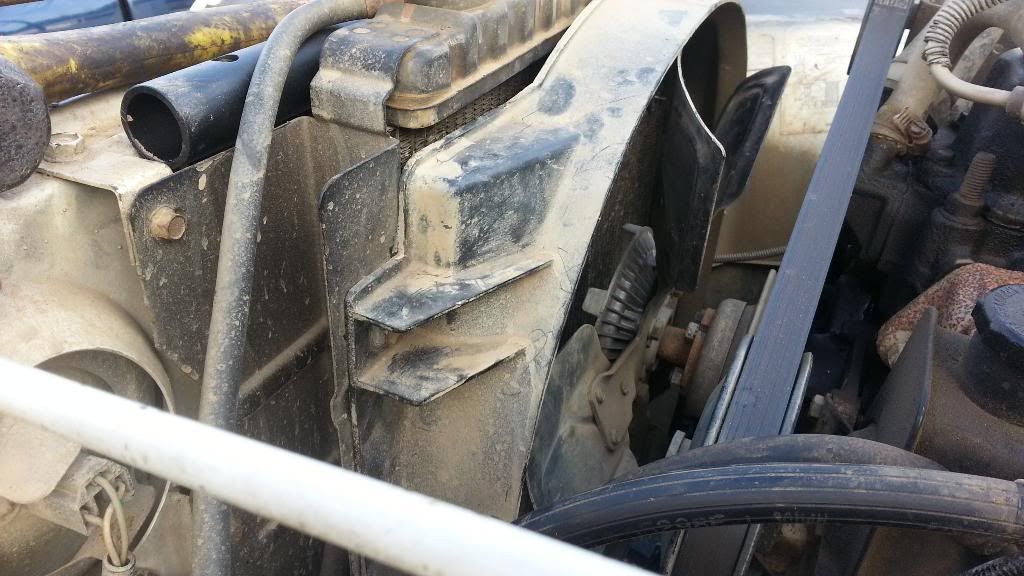

Onto the Daystar 1" motor mount lift:

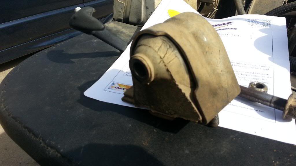

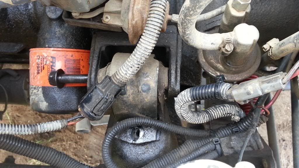

Original mounts pulled:
Test fitting the new mounts:
Falling asleep waiting on my buddy to finish the passenger side:
Have to remove giant Fram filter to get the motor mount bolt out:
Used alignment bars to get everything back in place:
Driver's side done:
Passenger side done:
Fan shroud fits perfect in its original location, no need to re-drill holes! (excuse my dirty engine bay, soon will be washed!)
Went for a quick test drive down to an auto parts store:
The ride is definitely smoother due to body lift, motor mounts are great quality and fit like a glove. There's absolutely zero vibrations I noticed over stock mounts. It's smooth and definitely helps out the drive-line angle and hides the oil pan a bit from under the jeep. I would definitely recommend this setup for anyone in the market for bl/ml.

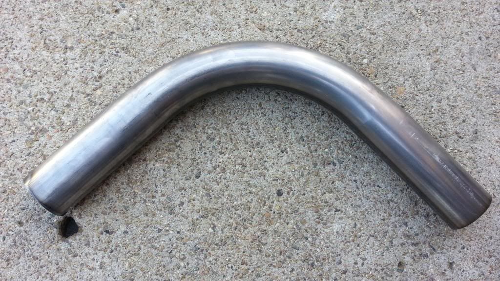

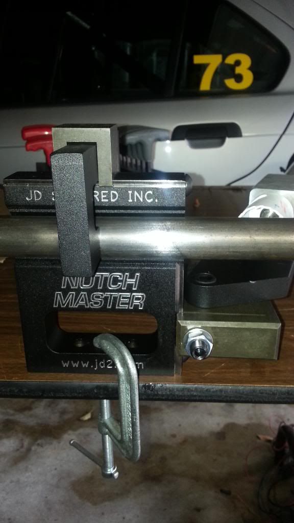

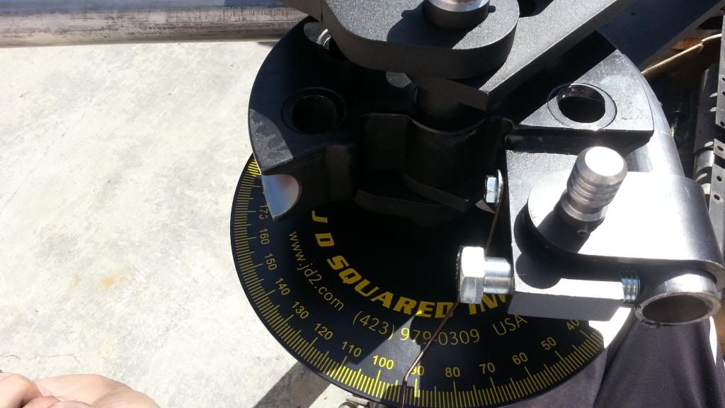

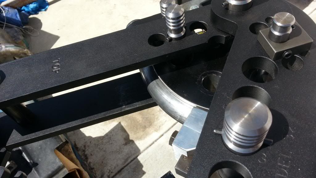

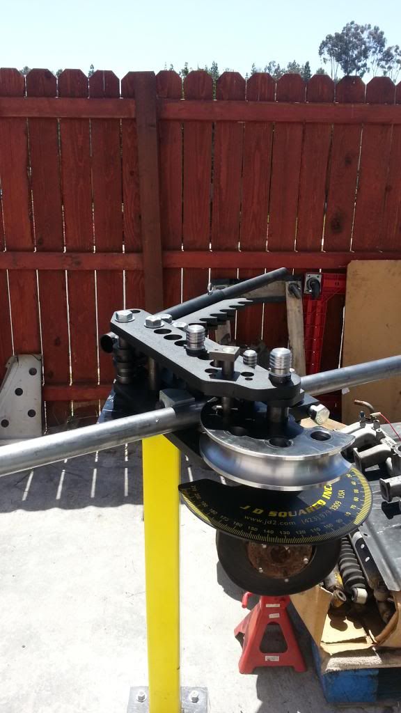

Setup the JD2 bender and learned how to bend some tube:
It was fun while it lasted, I no longer own the bender or a notcher, long story I'll pick another one up as soon as finances allow.

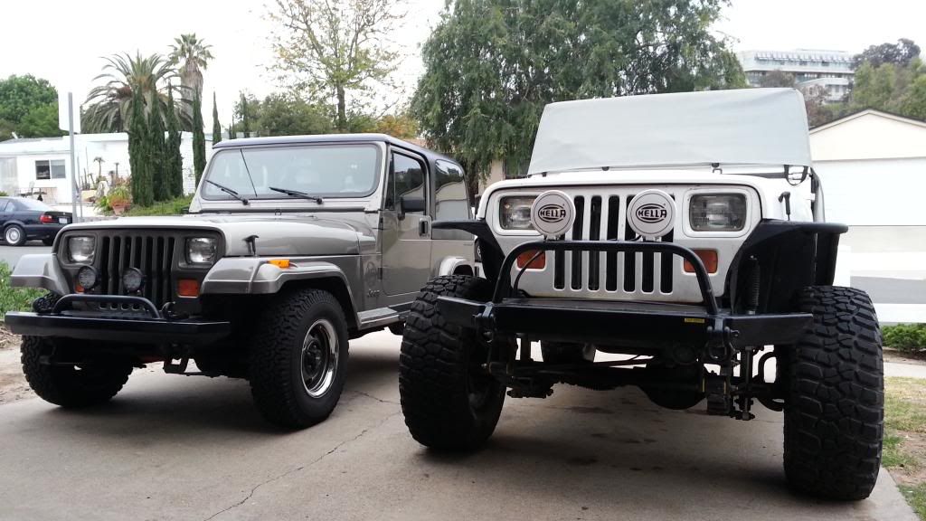

Cleaned up the Jeeps today:

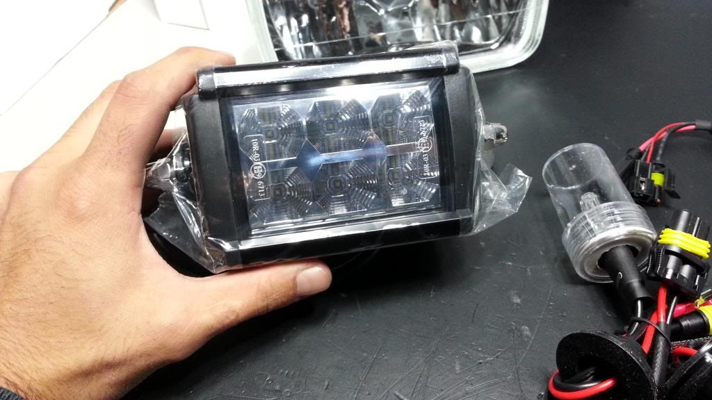

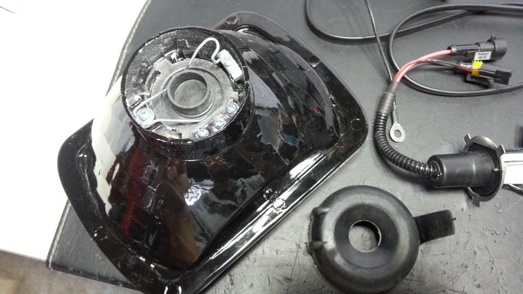

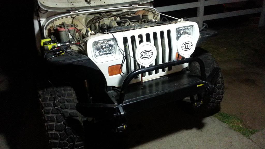

I've been meaning to do something about poor light output. Stock headlights and Hella 500s with stock bulbs leave a lot to be desired. I decided to pay a little shop called DDM tuning a visit. Left the shop with a great deal on the following:
New headlights that accept H4 bulb, H4 HID kit with high and low beam along with 55w ballasts! H3 HID kit conversion for Hella 500s also with 55w ballasts! To get the rear covered, I picked up a 5" LED flood light:
The 5" LED:
Headlights:
Planning on getting everything installed this weekend or early next week. Will be sure to post before and after light output

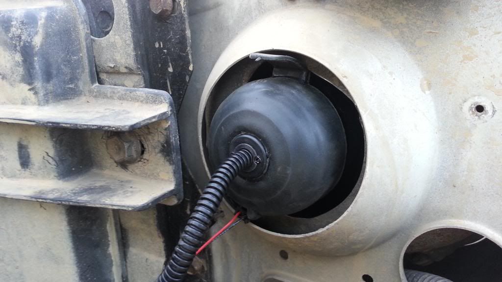

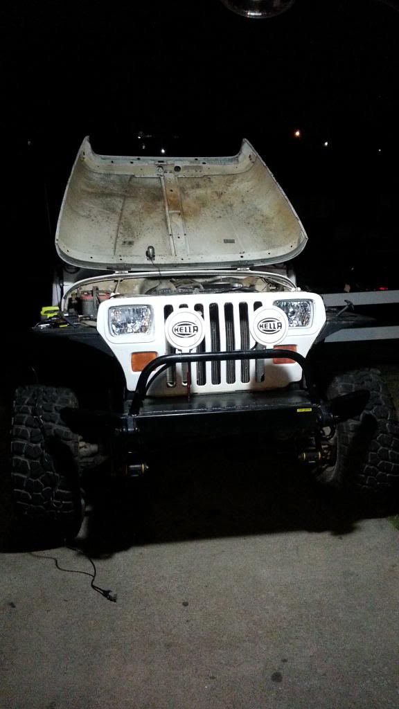

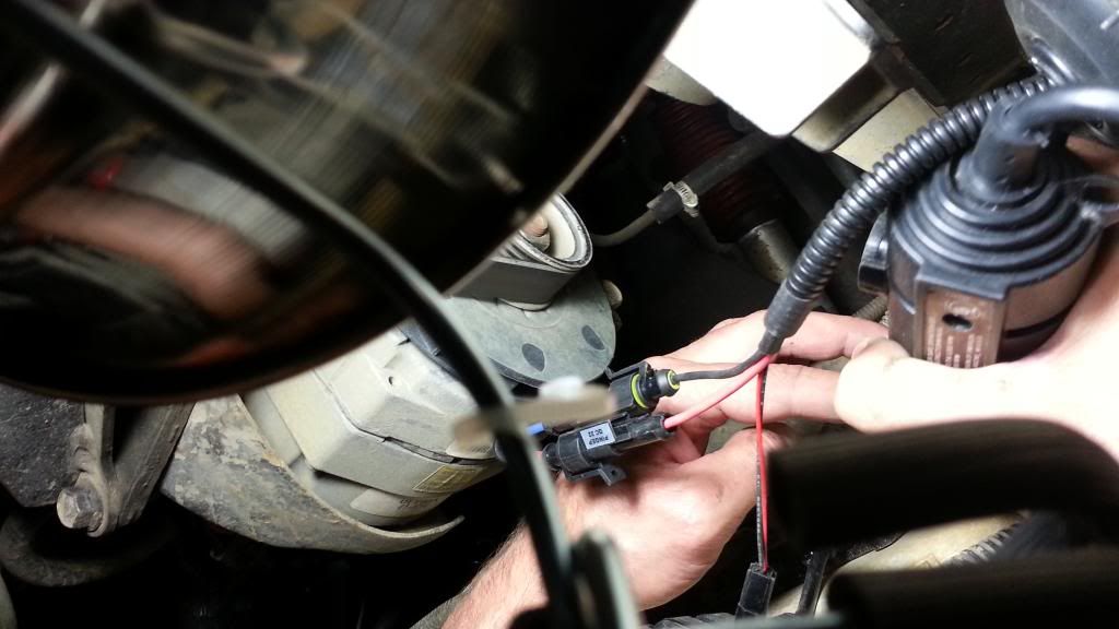

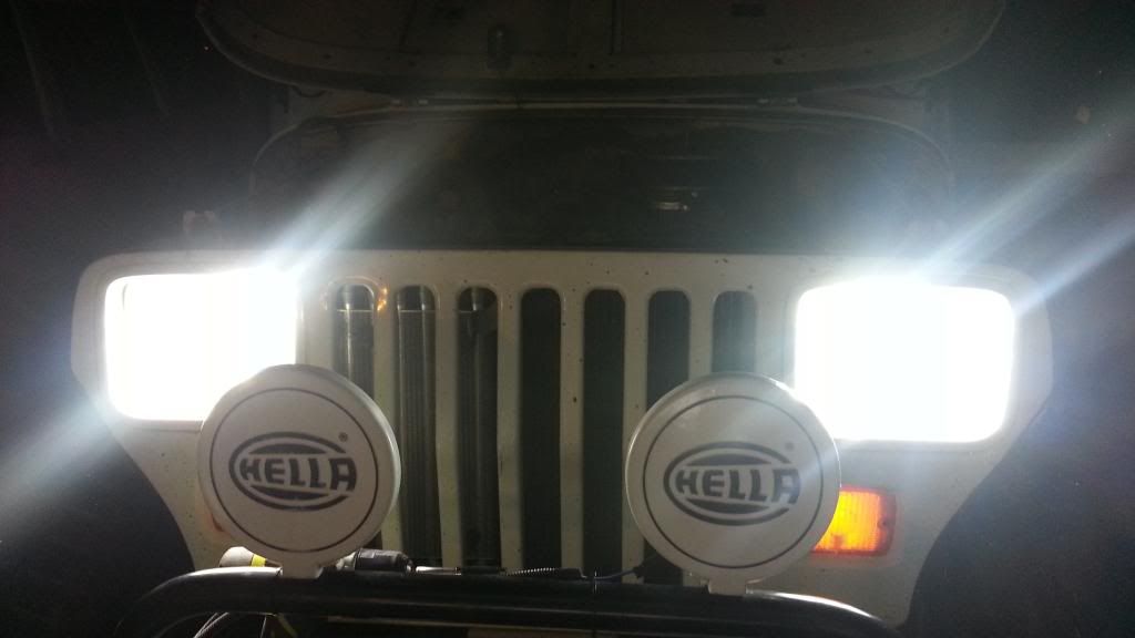

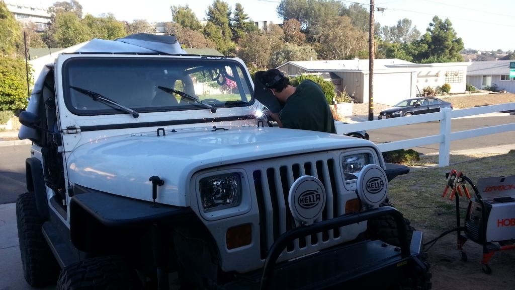

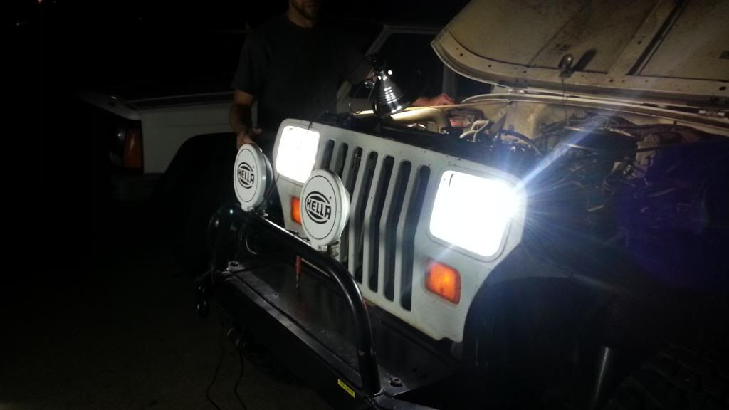

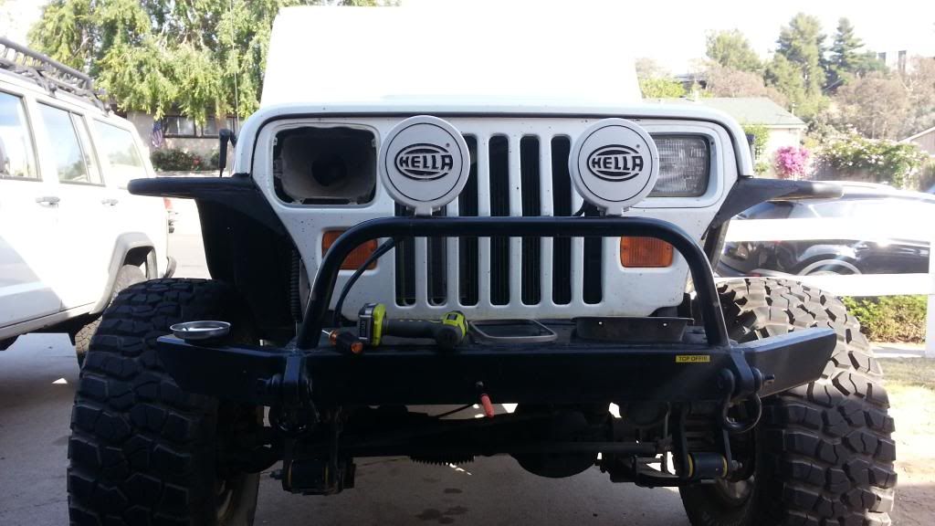

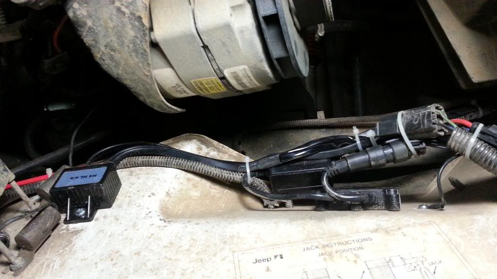

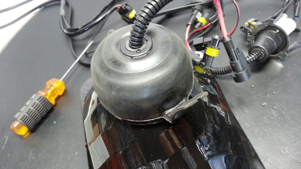

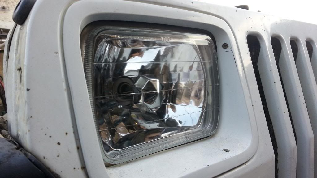

Got the new headlights installed with HIDs tonight :

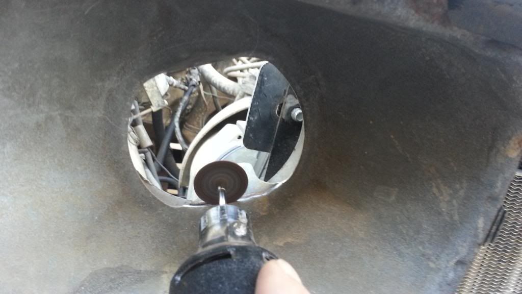

Had to cut the tabs out and make a little more space:
slim 55w ballast

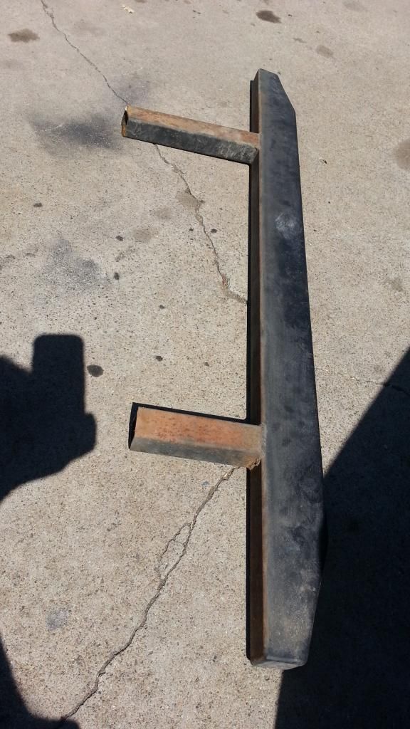

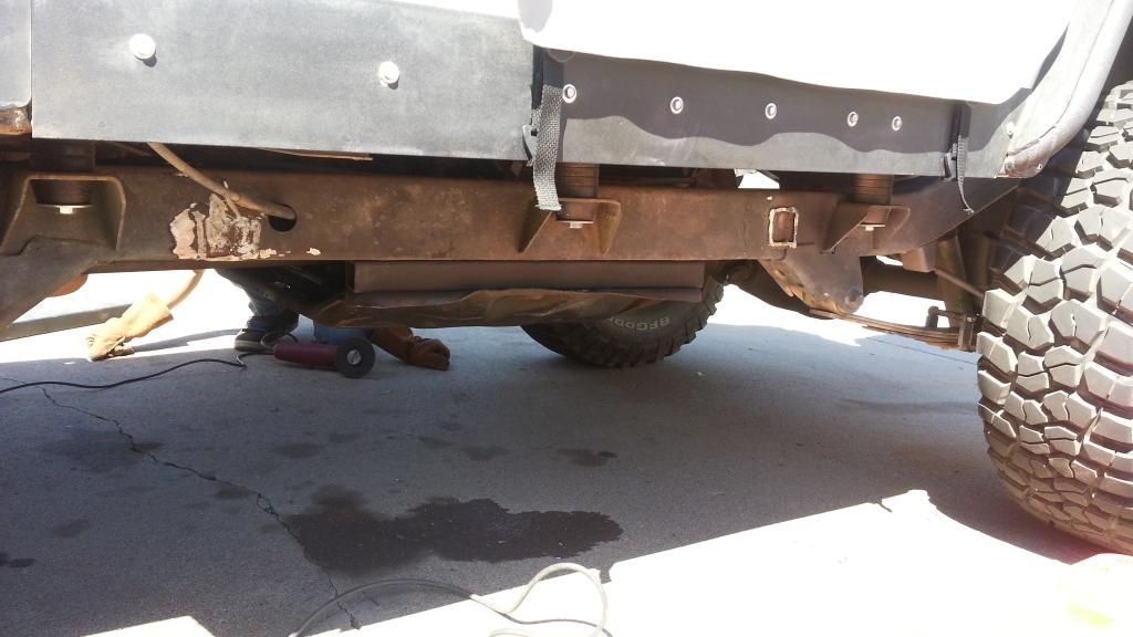

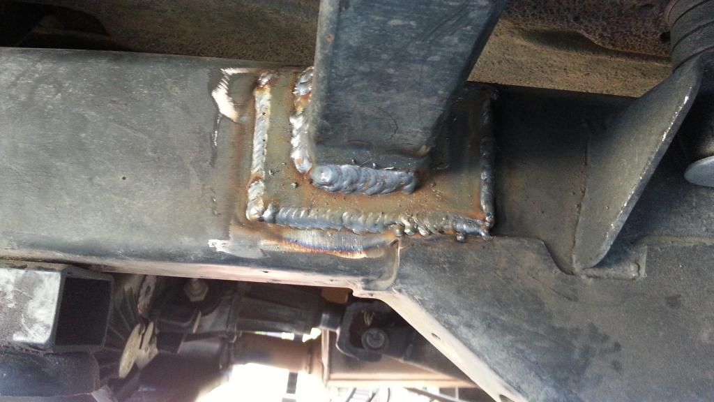

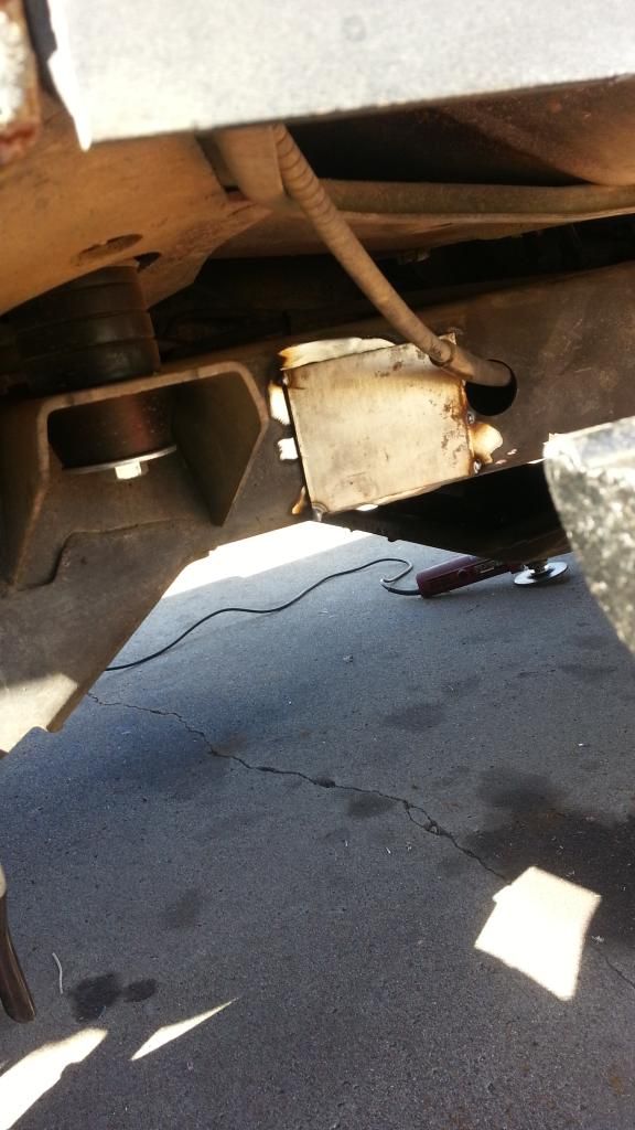

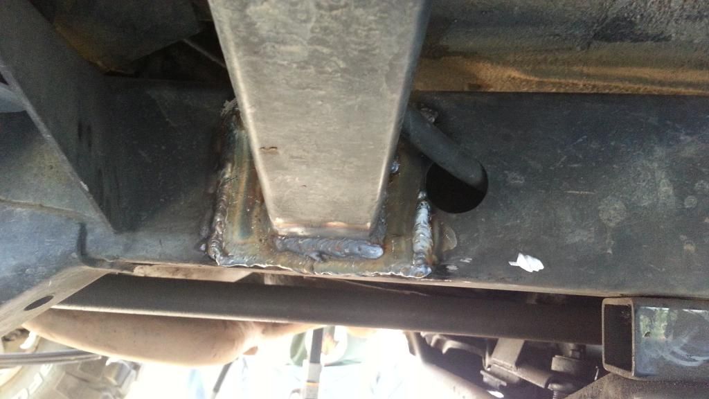

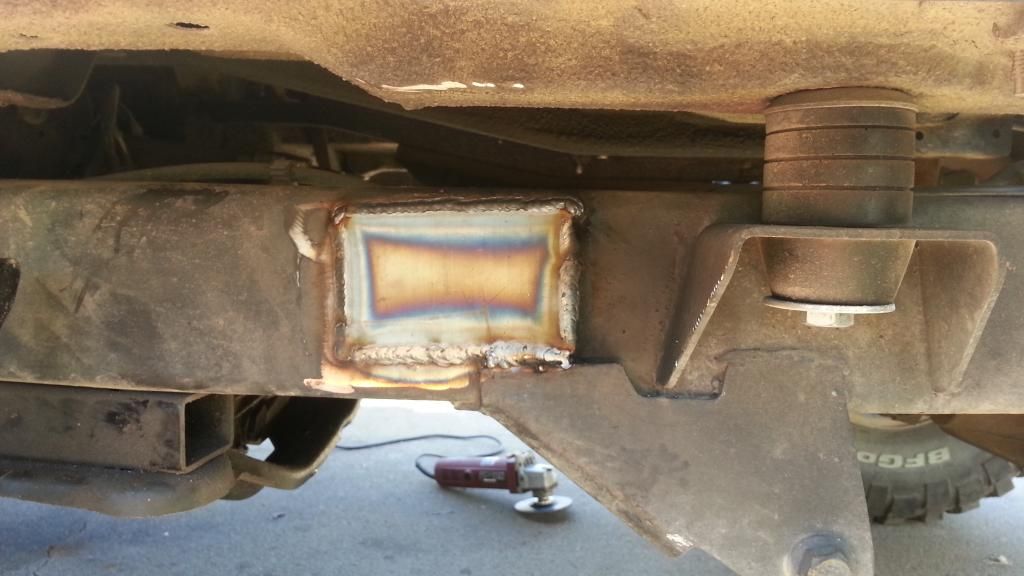

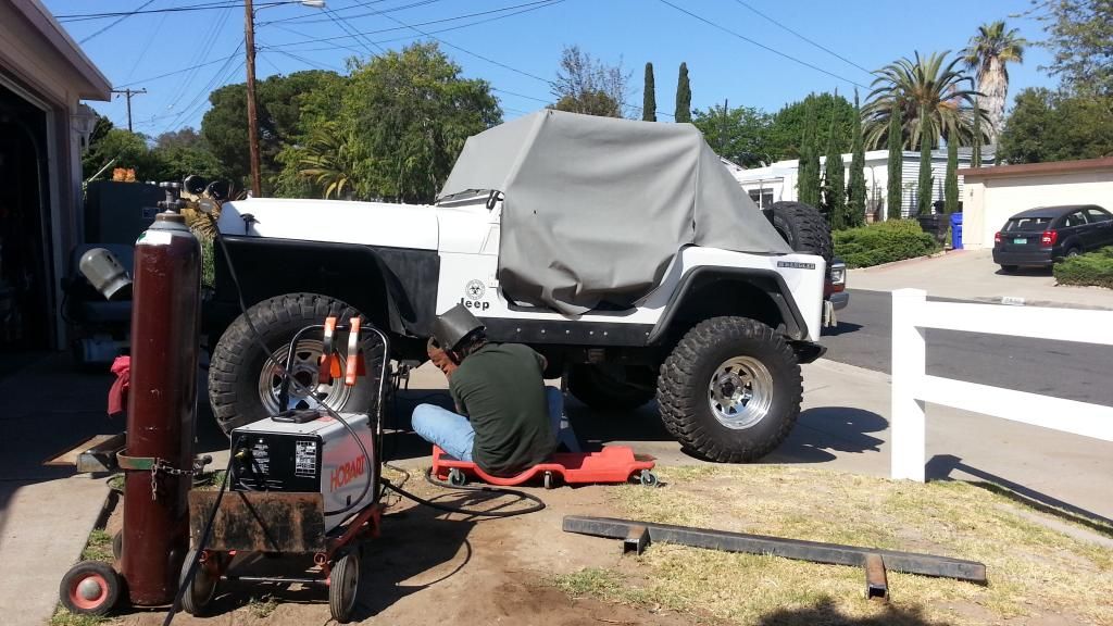

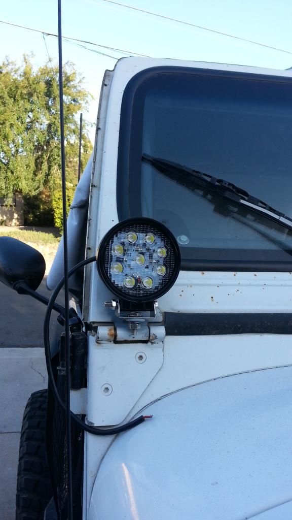

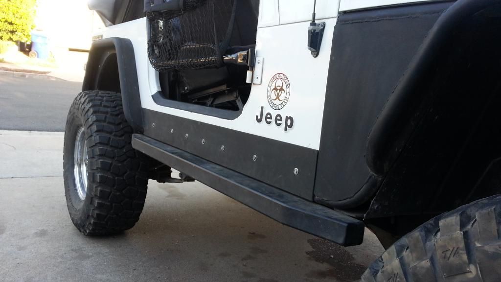

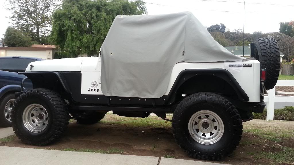

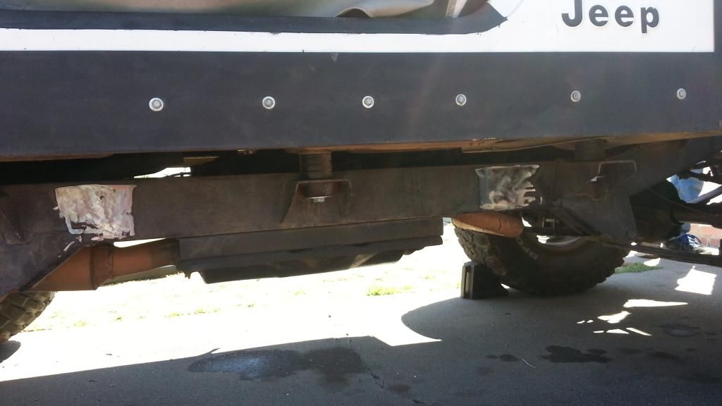

Some fabrication done on the Jeep today. We cut off the rock sliders and welded reinforcement plates onto the frame. Then we moved the rock sliders up 1" to fill in the exposed gap due to a recently installed body lift. We also welded light tabs onto the windshield mounts in order to run LED spot lights!
Chopped that thing right off:
Had to grind the frame clean:
Cutting up some reinforcement plates:
Much better:
My buddy came over to help out a bit:
She looks so naked without sides, also much higher too:
Using jack stands to get a perfect new fit:
All welded up:
Welding on the light tabs:
Test fitting LED spot lights:
All done! Much better raised up to where it needs be:

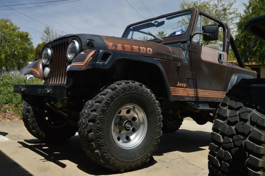

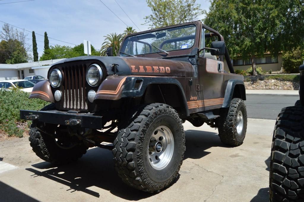

Just took her in on a trade, 1982 Jeep CJ7 Laredo with 2003 TJ 4.0 fuel injected engine, AX15 transmission and beefed up soft-locked AMC20. She's sitting on 4" Bilstein lift with full YJ suspension and steering conversion. Dana 300 transfer case turning Tom Woods CV drive-shaft and 4.54 gears!!!
Future plans include full frame resto
