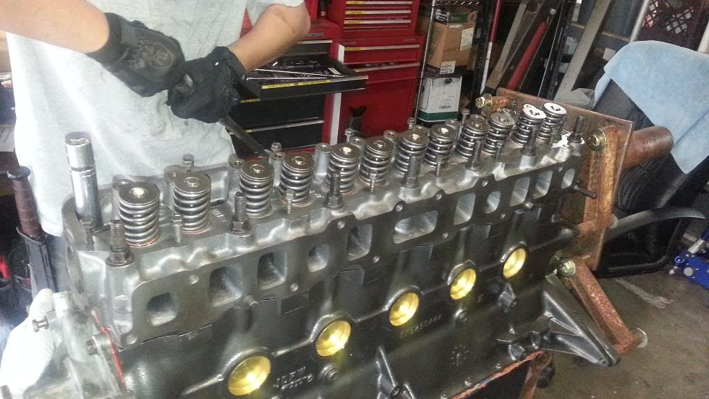

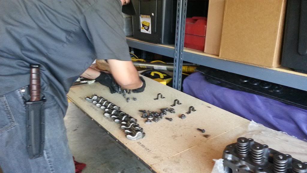

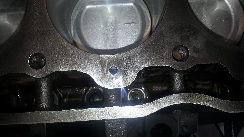

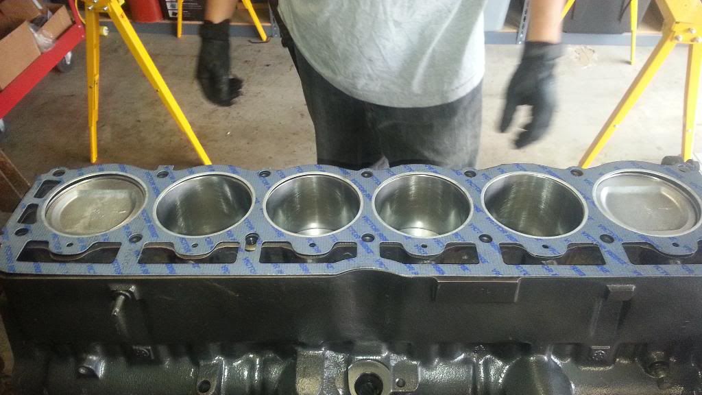

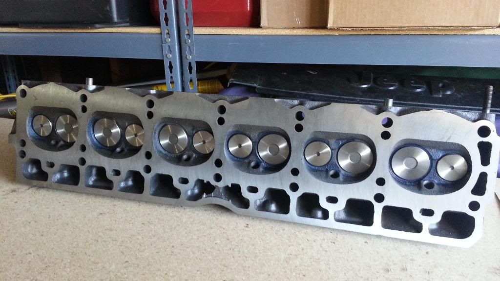

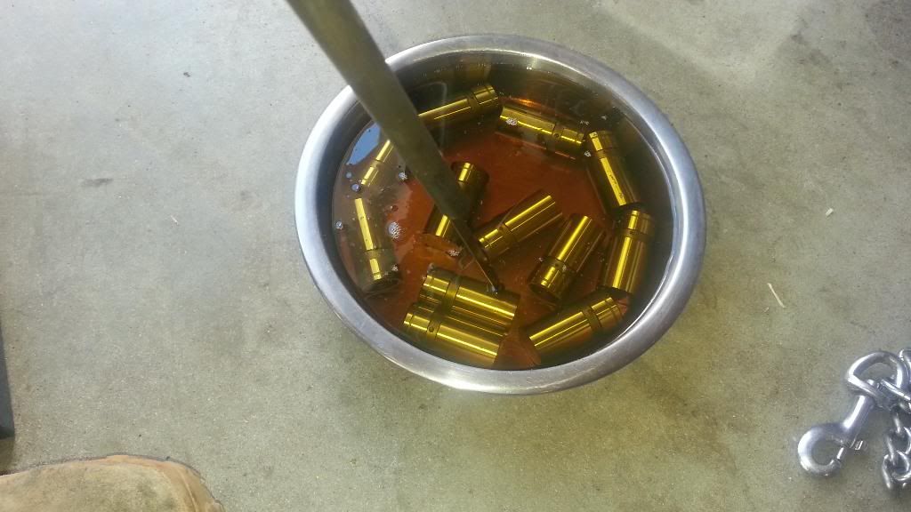

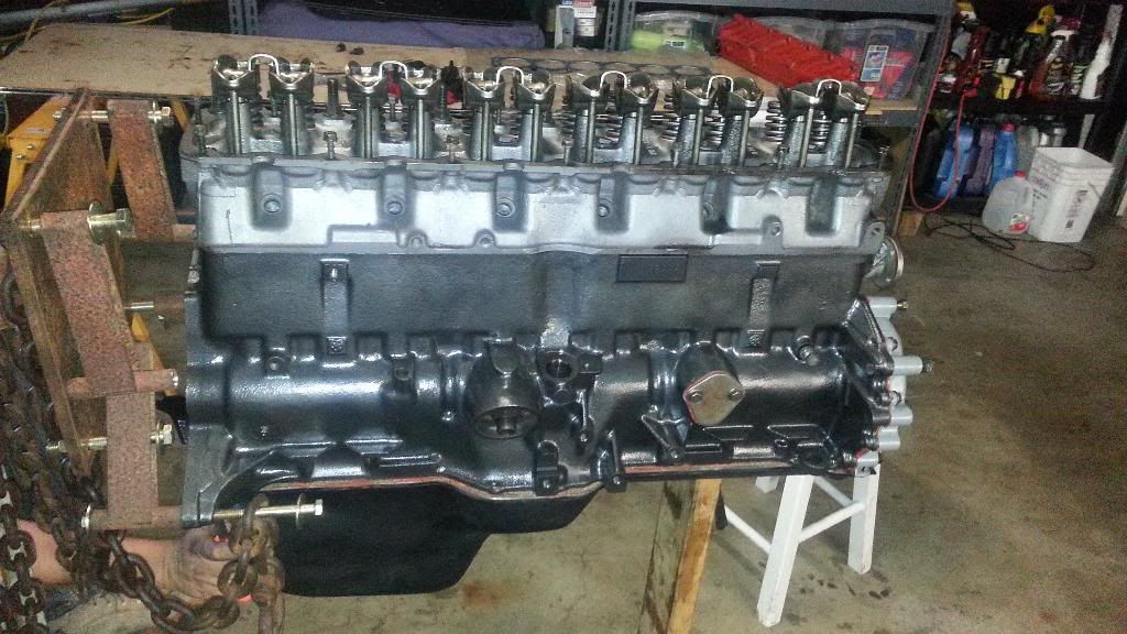

update: 12-16-13
Some more engine porn:
soaking the lifters for a good measure:
lifters dropped into place:
torque sequence along with proper numbers, bolt 11 thread-locked, etc, etc:

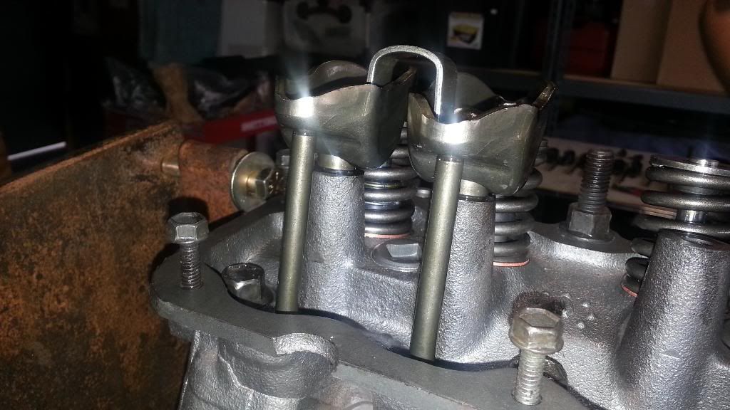

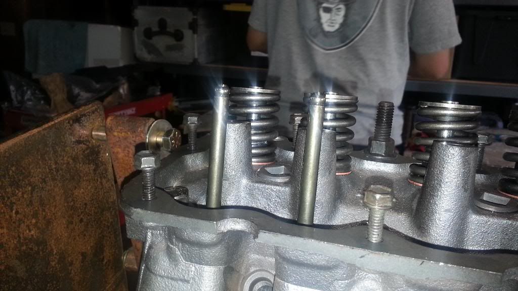

pushrods:
rocker arms and bridge:
head on:

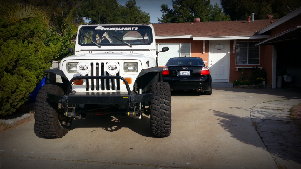

Location: Basalt, CO
Posts: 690

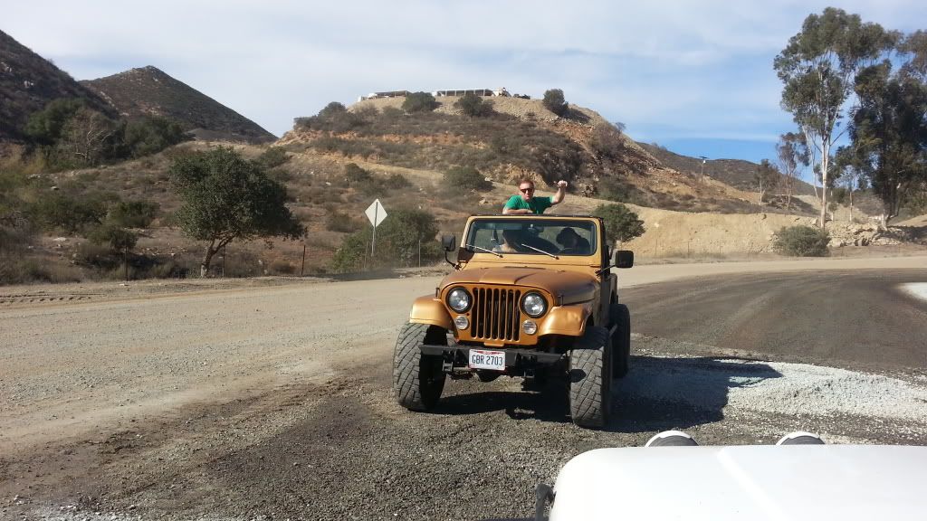

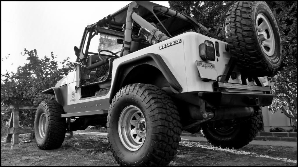

Is it just me or is your right front tire a lot wider than your left front? I can't tell if it just the angle of the way the picture was taken or if im going crazy, or both?

It's the angle lol

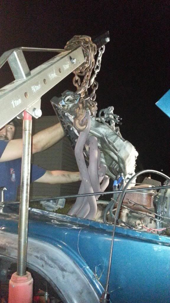

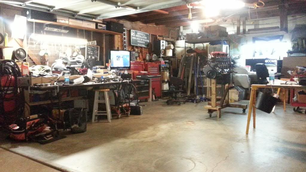

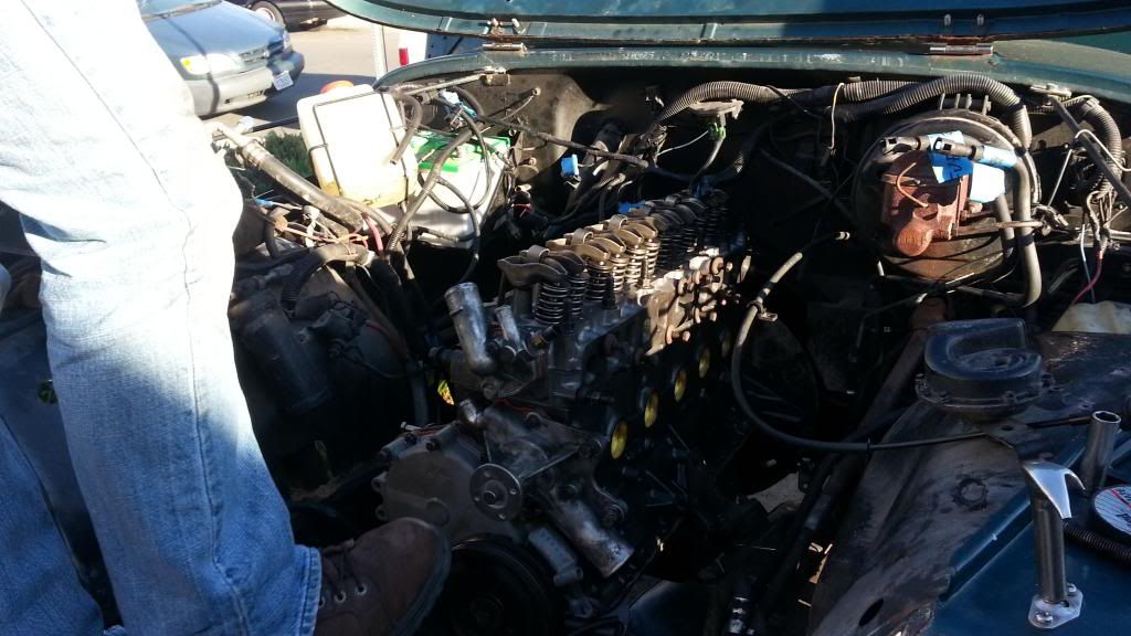

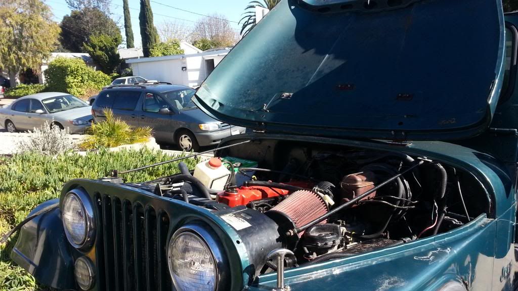

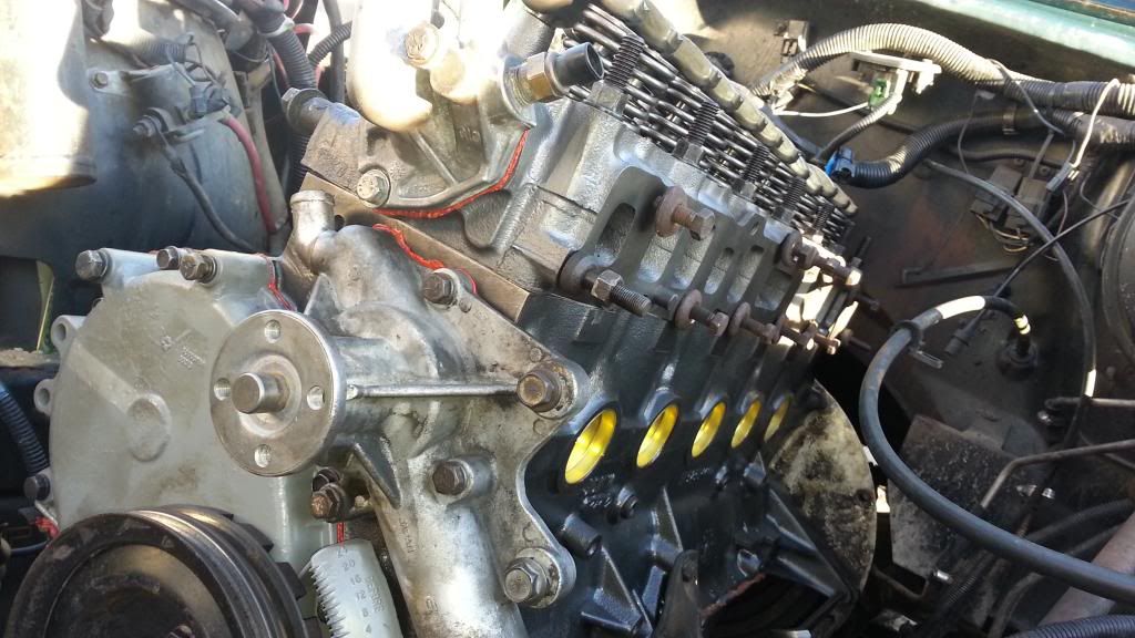

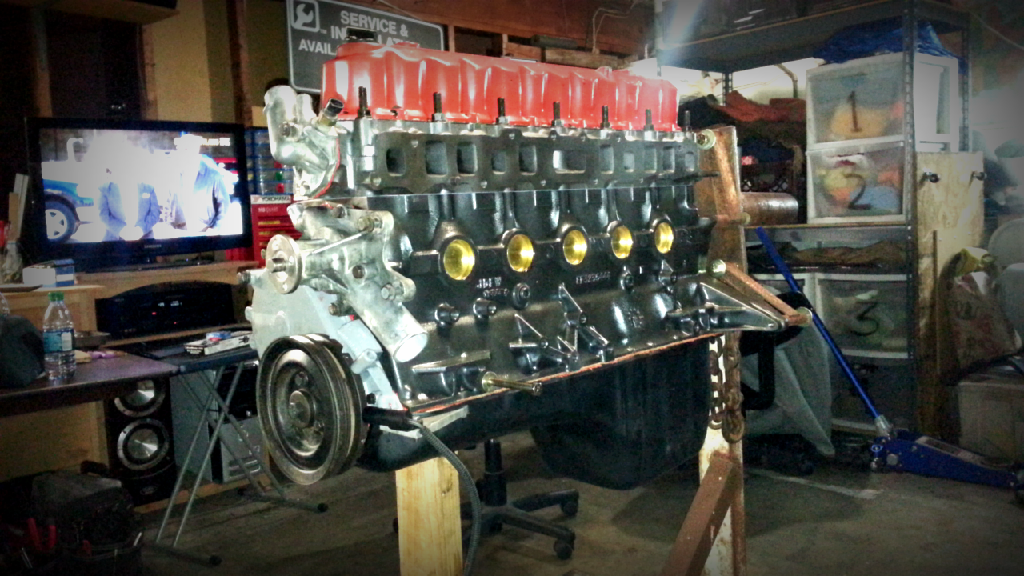

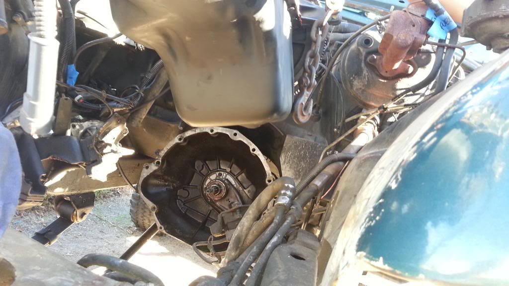

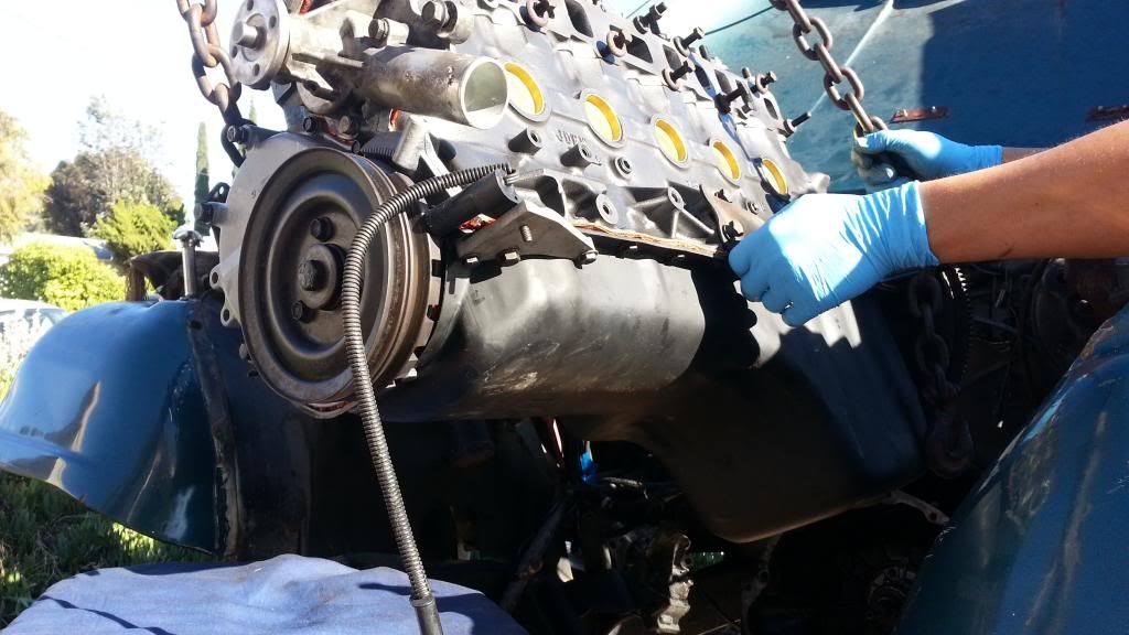

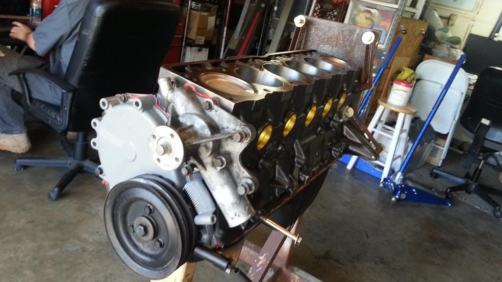

Update 01.01.14!
4.2 build completed, running great!
My messy garage shop:
Pulling the old motor out of the CJ:
Rebuilt one going in:
All done:
Sounds incredible with the mild cam and those headers

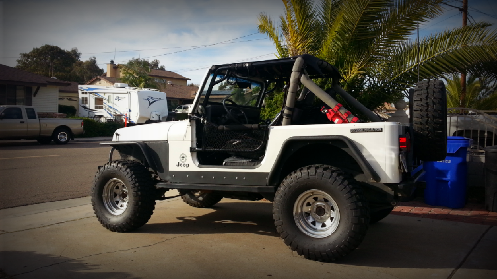

Hard top and fiberglass upper door sliders sold! No point in having it sit around. We have the XJ for those couple days of the year when it tries to rain here..
Had to clean her up today, will be getting her ready for a wheeling trip in a couple of weeks:

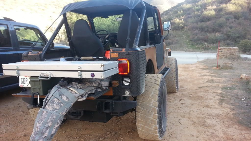

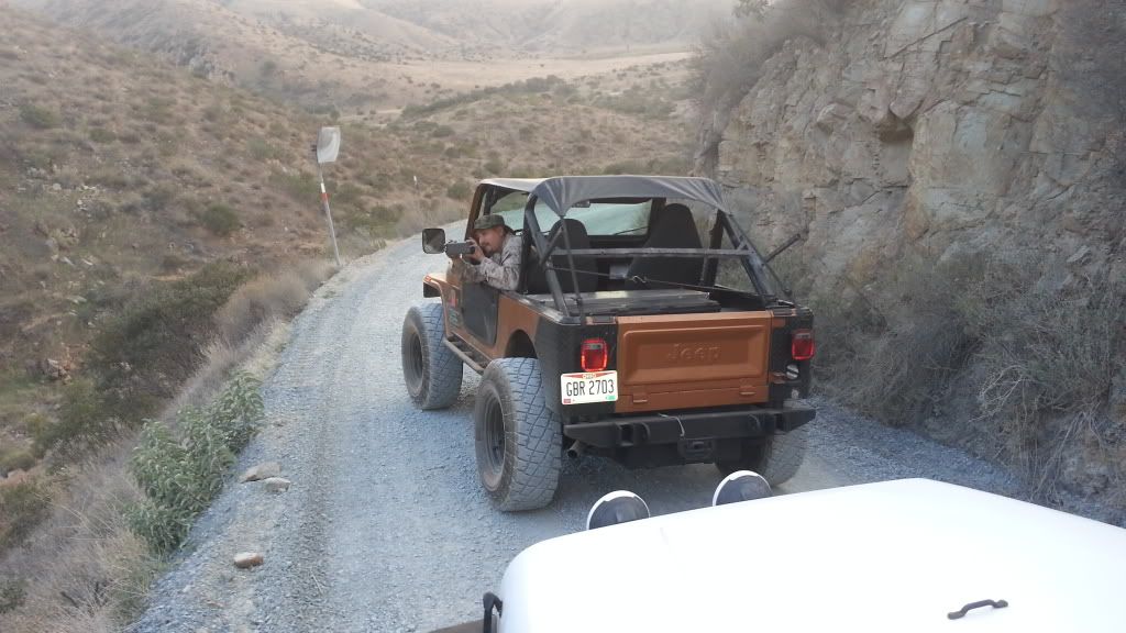

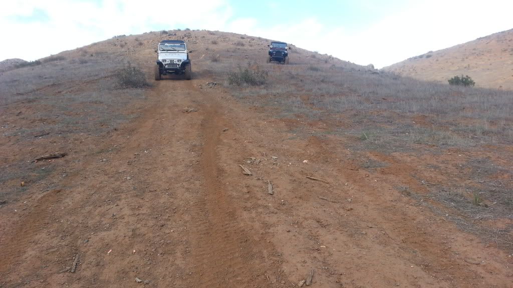

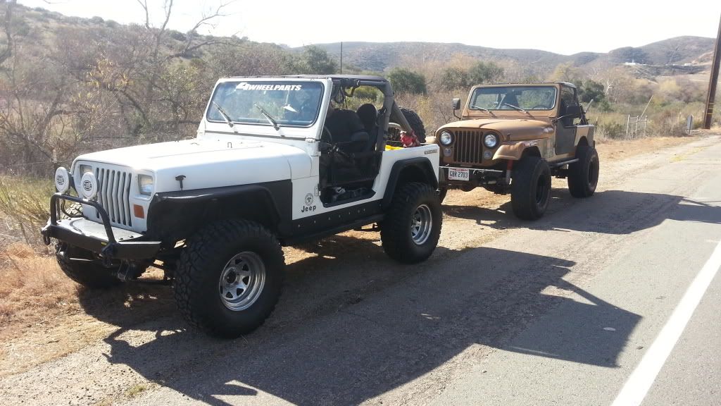

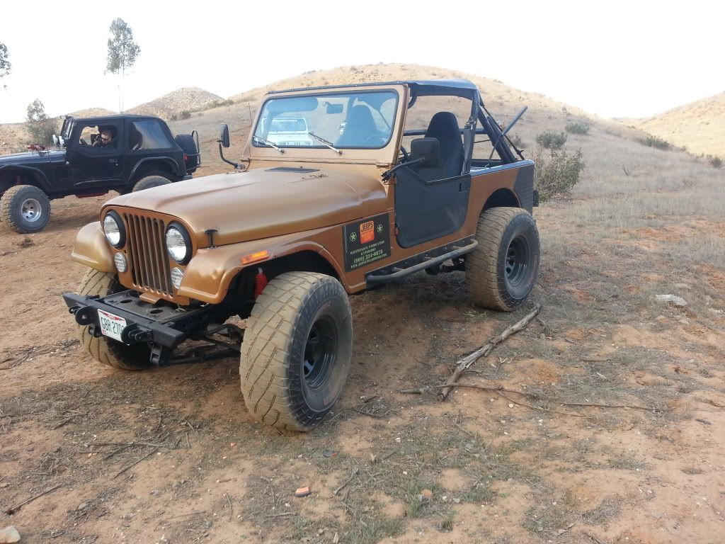

Meanwhile we went shooting and had a little fun breaking new to my friend 1983 CJ7:
He's hooked, we need to get a little more room under there for those 35s and go hit some real trails

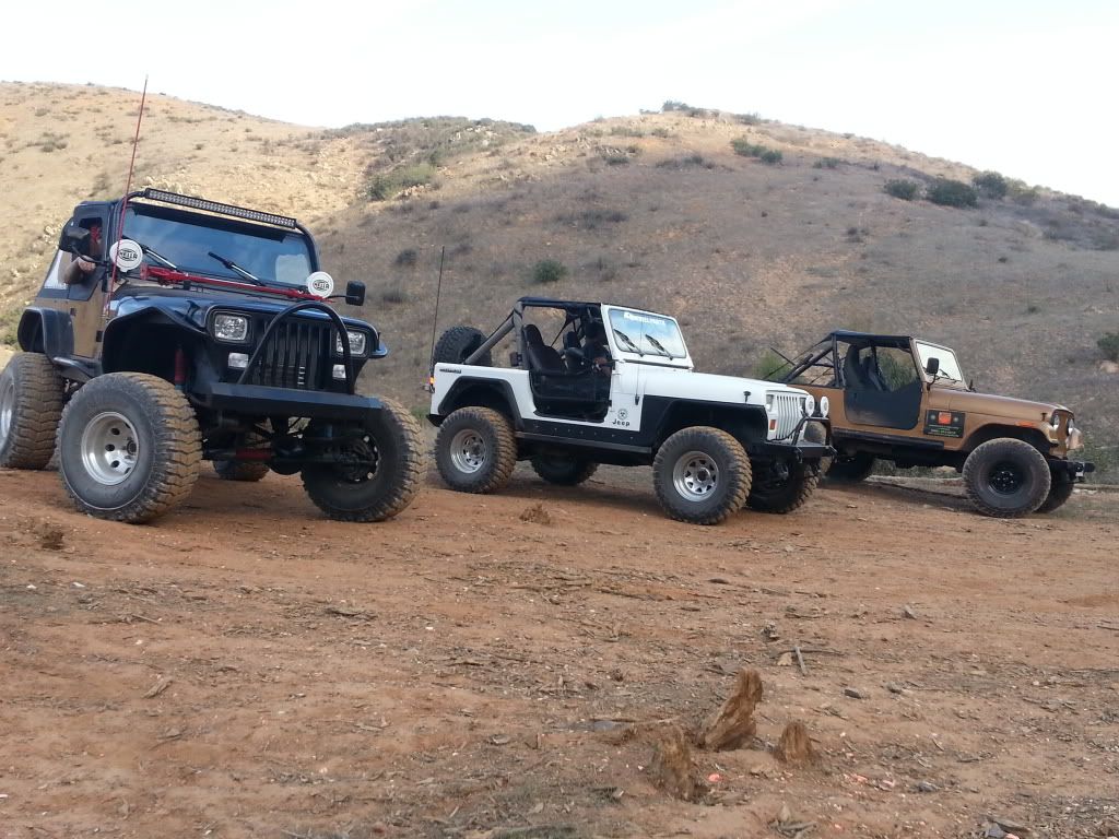

Who's black YJ is that? Did he fab those imitation 'cloaks himself? Not a bad job...
