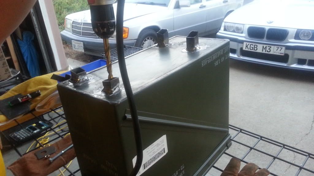

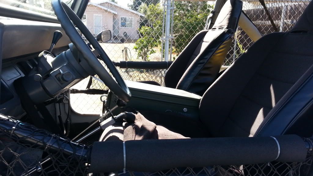

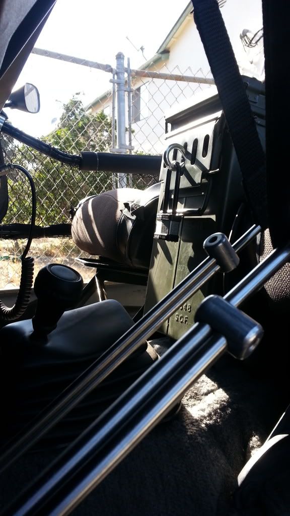

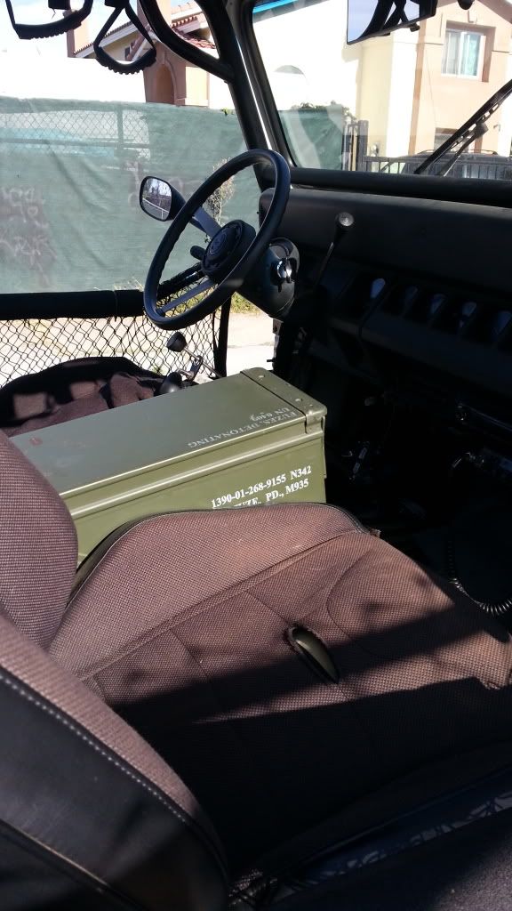

Taking advantage of free time, was able to finish the center console. Came out perfectly leveled and evenly centered. We cut 1x1 square pipe, shaped and sized onto the contour of the tub, leveled the army can, then ran 4 1/2" bolts through.
I would still like to add cup holders and a few other items, but for now it's great, secure and works as an arm rest. One of my favorite mods!
Holes for 1/2" bolts that go through the tub and secured from under Jeep:
Rear feet prior to spraying with primer:
Front feet shaped to fit the uneven floor:
Nice padlock I got with one of my rifles, better used here. I finally have a locking center console!!!
Random shots:
Very useful mod, holds a lot more stuff, works like an arm rest and looks bad ***. Total cost - $25

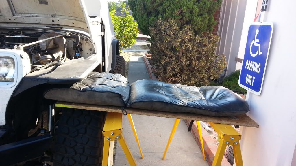

As the Jeep continues on going up higher, my life reaching anything under the hood gets more and more difficult To overcome, I threw together a little service "bed" for myself:

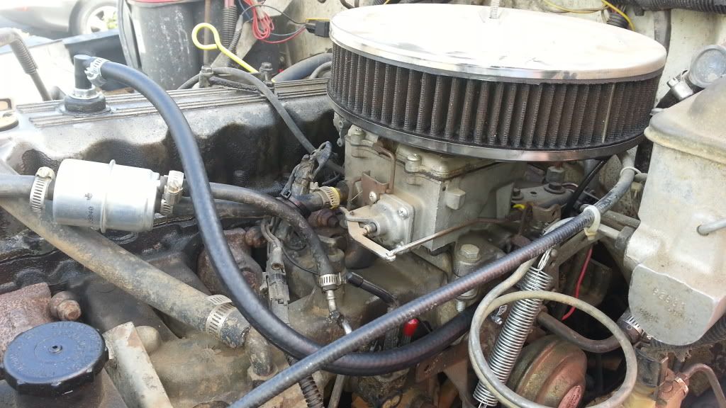

Discovered the vacuum lines to be a complete disaster. Charcoal canister was wired *** backwards, pcv valve tied into a wrong plug, etc, etc..
Fixed everything down to one vacuum line for the dizzy:
Threw in a new Fram along with fresh Mobil 1 10w40 full synthetic, tidied up some wires, installed my washer fluid reservoir:

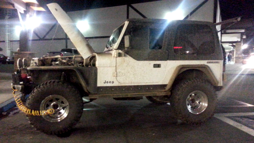

Aired back up at a local shopping center while GF was shopping:

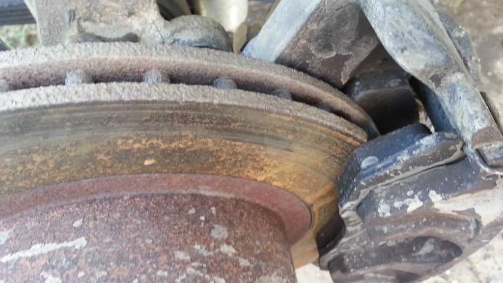

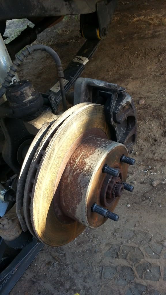

One can never be too careful or prep for too long. Lets just put it this way. GF and I are very lucky to be back home and alive.
Somehow a caliper bolt backed itself out and had us driving around like this:
We wheeled for hours and drove home down a windy road then freeway. All along I heard a little click and thought it was the sway bar disconnect making noise when brakes were hit. Got out several times to inspect it, nothing looked out of place. Till we got home and I took the wheel off..
Very lucky to be here... From now on, I'm looking over absolutely everything before leaving for a long trip
We wheeled for hours and drove home down a windy road then freeway. Very lucky to be here... From now on, I'm looking over absolutely everything before leaving for a long trip
Thanks bud!!
HOLLY SH^& thats just down right SCARY
Indeed lucky that did not end up leaving you in a Bad Spot
