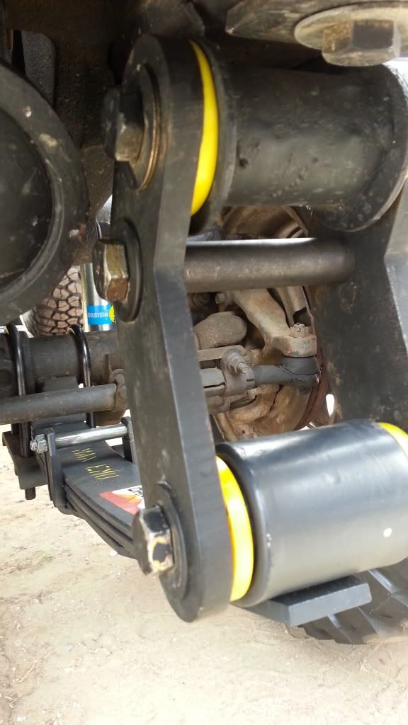

- installed shackles sleeves and retorqued all bolts

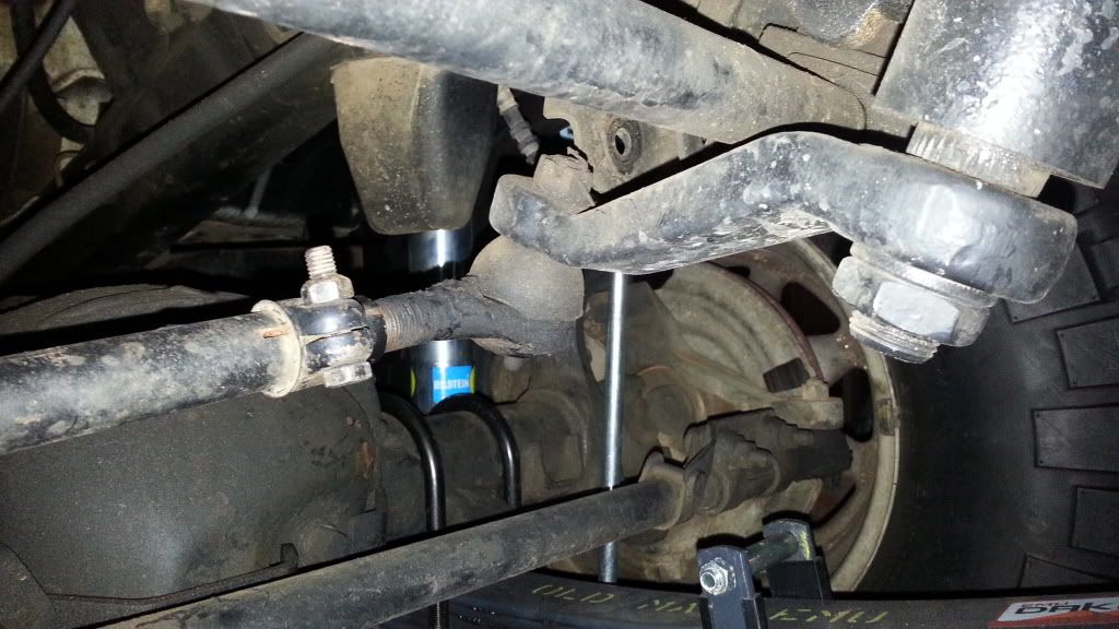

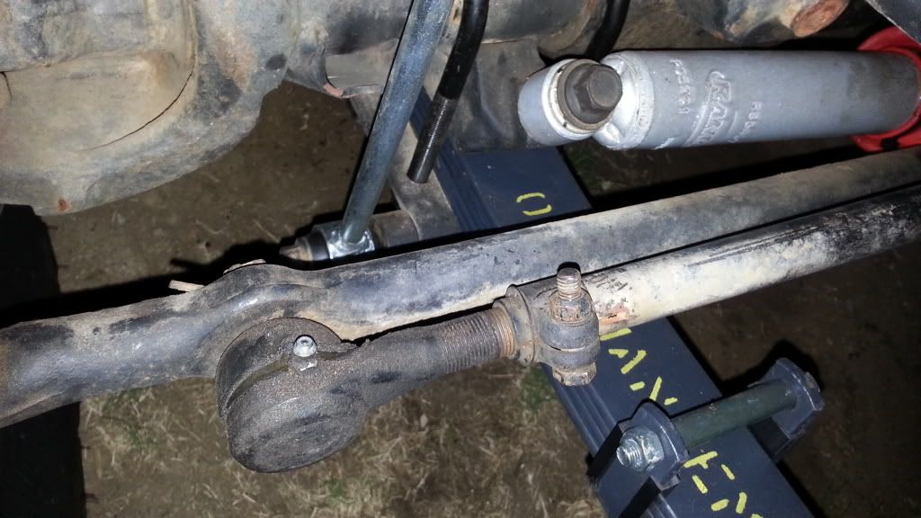

Haha, I drove that way for one day to work and couldn't take it!! Makes a world of difference when the steering is centered.
Your drag link has two stubborn 13mm bolts. Then you would rotate the bar toward the front of the jeep in order to lengthen it and toward the rear of the jeep to shorten. Your steering wheel will turn left when the total drag link distance is longer and right when it's shorter.
Here's mine after adjustment:
few dirty threads showing below is how much the bar needed to be lengthen from old 2" lift. Still no need for a longer drop pitman arm:
you can spray a bunch of liquid wrench on the bolts and end links, let it sit over night and give it another go in the morning

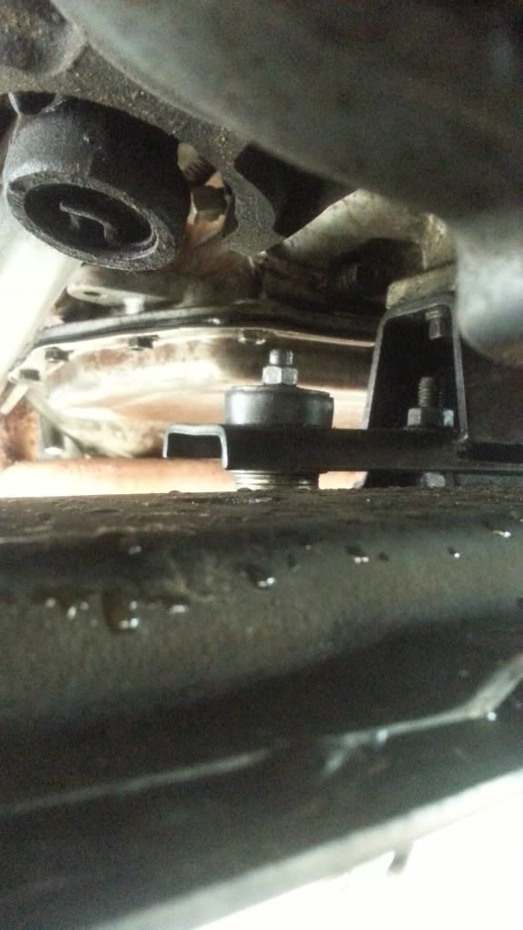

Installed the full T-case drop kit as the 1" wasn't enough to get rid of vibes:
Noticed my torque mount was completely lose, incorrectly installed as well. Fixed it and remounted:

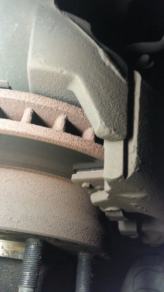

Deron who came to help out with my rear drums was doing brakes on his truck. Great opportunity for me to return the favor and take a Jeep on a test drive.
8 lug! His brakes were completely shot:

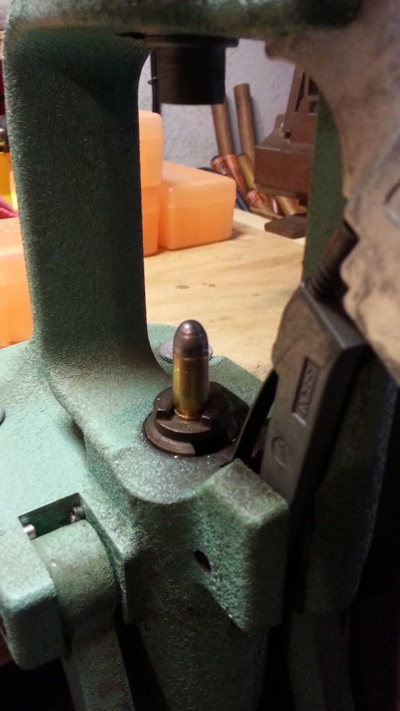

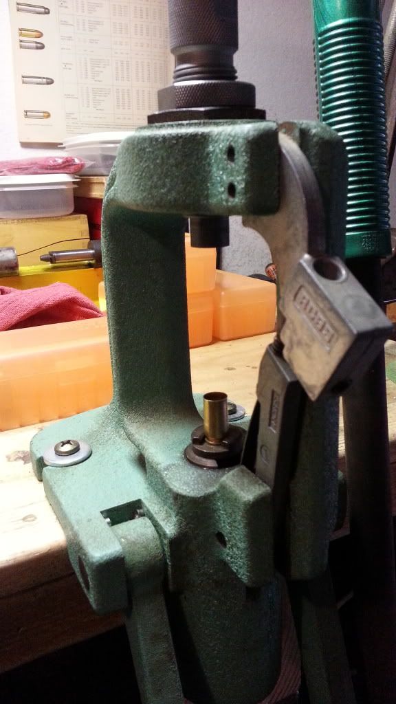

Not really Jeep related, but I learned how to reload today:
9mm done:
