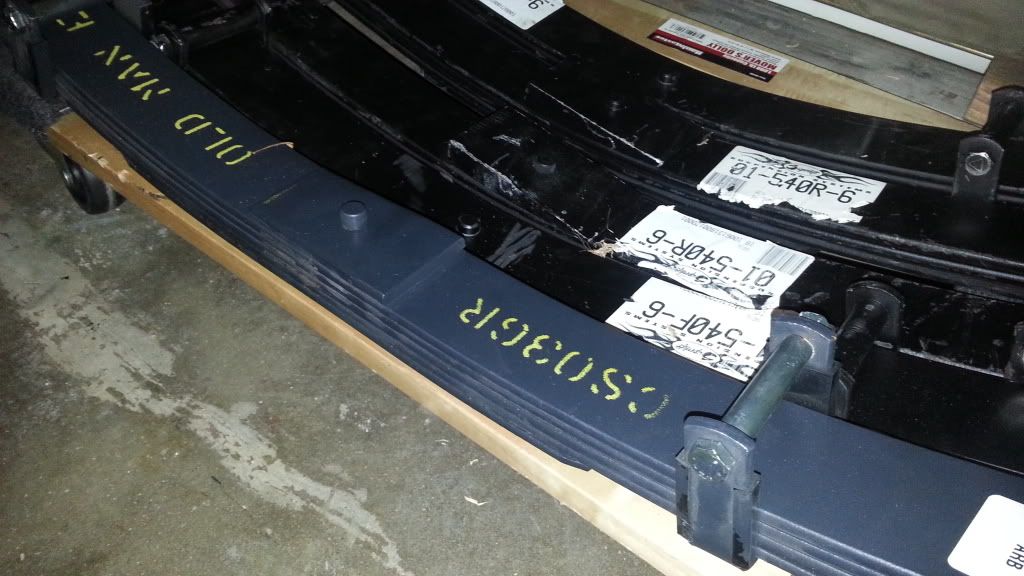

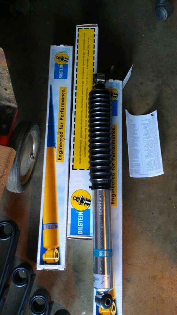

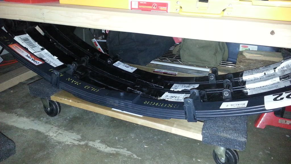

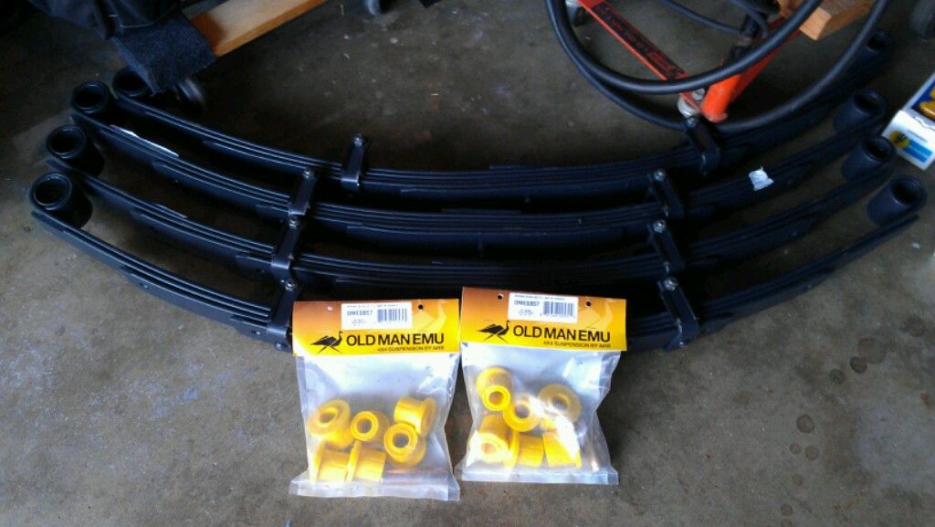

update 7/12:

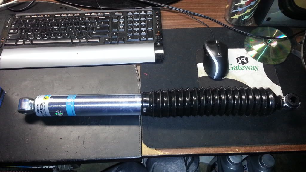

Got the OME springs along with Bilstein 5100s. I won't comment on the springs much as I'm digging Black Diamond one a heck of a lot better. As far as shocks go, I'm very impressed by build quality and overall look. Can't wait to see how they ride
Made in Germany, these things look badass:

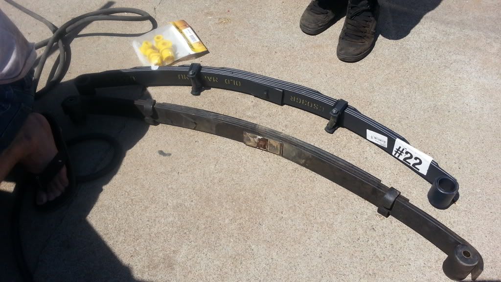

OME 36R springs:
Next to Black Diamond:
Looking a the how flat OME springs are in comparison to Black Diamond, makes me wonder if those are close to 4.5" of lift. Maybe way too much for my 33s with flat fenders. I see now why those of you running OME don't require a drop pitman arm.

The ome springs are deceptive. They offer more lift then they appear to at a first glance. The black diamond springs do look pretty beef, but they also look like they will be stiff. It's really great and respectable that you're honoring your superlift deal so I won't tell you which springs I know you would like better...
Either way, can't wait to see the new lift!
cheers
I'm thinking it's gotta be the 5 spring setup providing for extra height. The arc on Black diamonds though looks a lot more curved. Probably end up being closer to 5" without any weight. I'll run both and have fun with it, get Superlift their pics and videos and go from there...
Looking forward to this weekend and first chance I get to test out the new stuff. I'm thinking OME for now, Black diamond when 8.8 goes in and I trade someone my 33s for their 35s

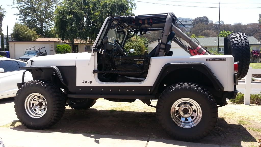

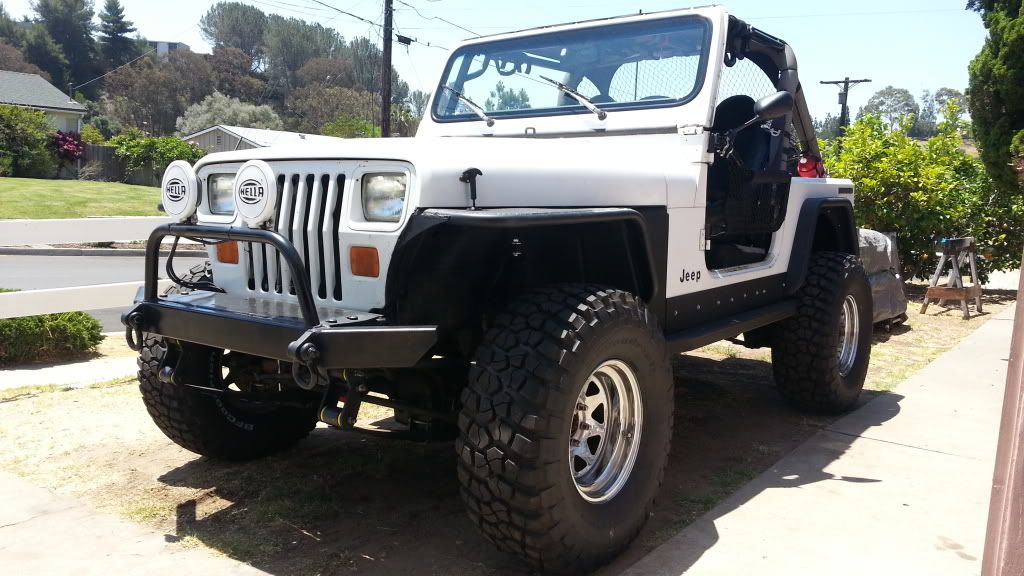

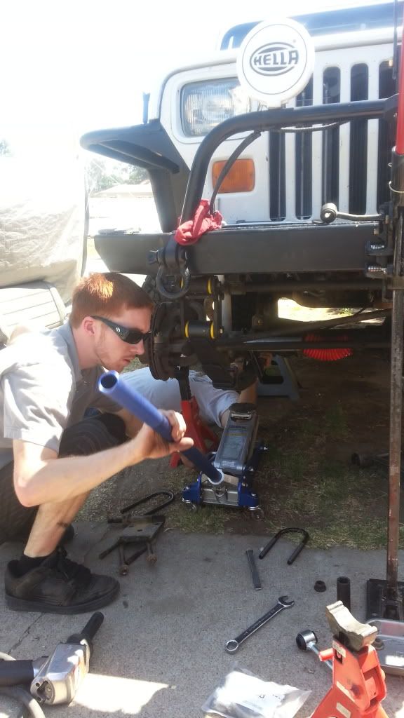

7/15 update:
Weekend well spent. Josh and I got a lot accomplished in two days on our Jeeps and even took our GFs out on a date!
Josh's Jeep:
- Replaced lose transfer case chain
- Drain/Fill transmission fluid
- Replaced transmission filter
- Installed new transmission mounts
- Installed transfer case drop kit
My Jeep:

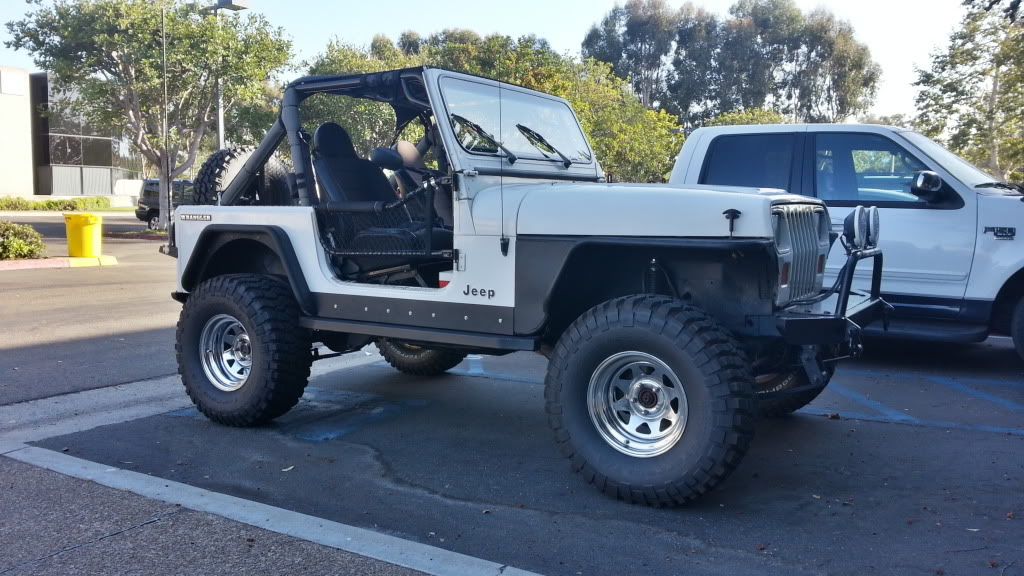

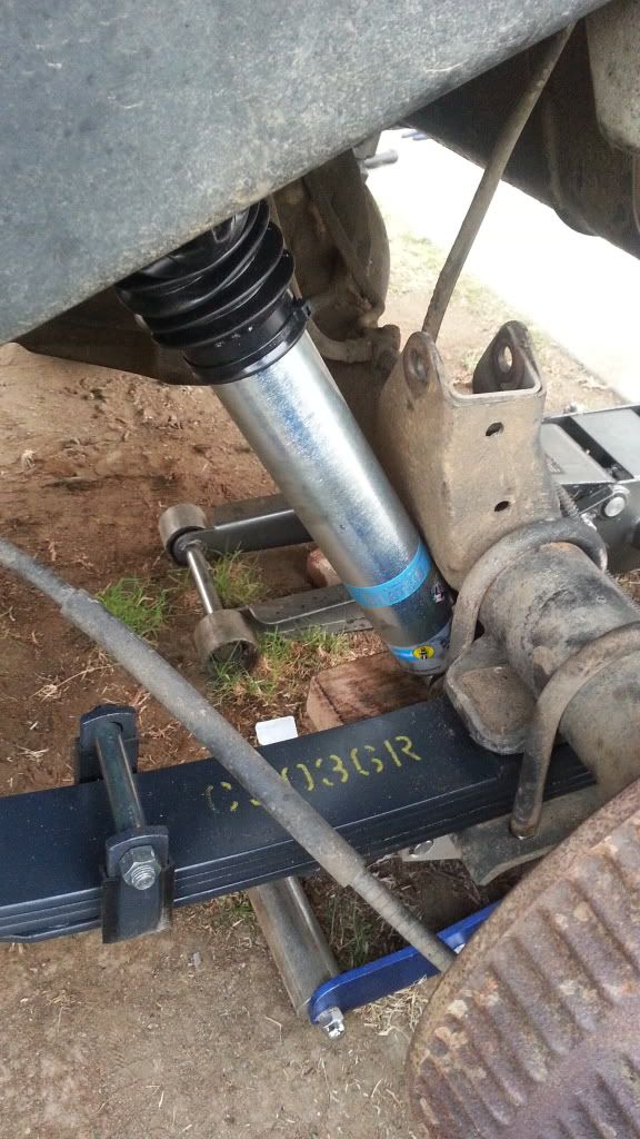

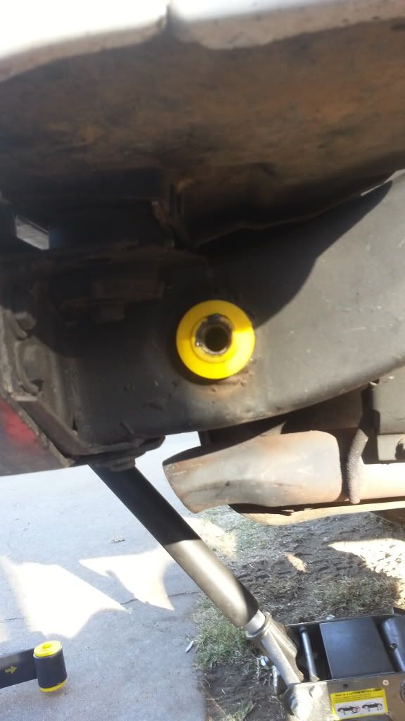

- Installed OME 36R springs and OME bushings all around
- Installed Bilstein 5100 shocks

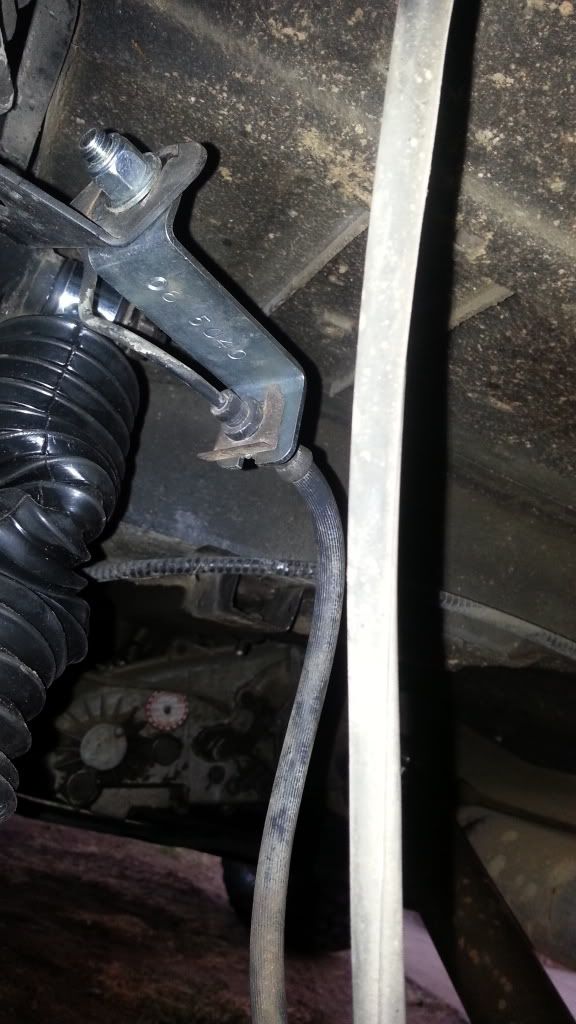

- Installed longer sway bar end links with new bushings
- Installed rear brake line relocation bracket
- Adjusted drag link
Best looking shocks I've seen in a long time:
OME 36R springs with OME bushings:

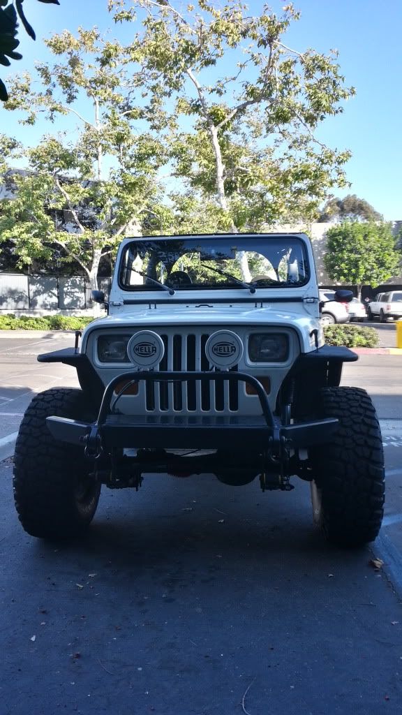

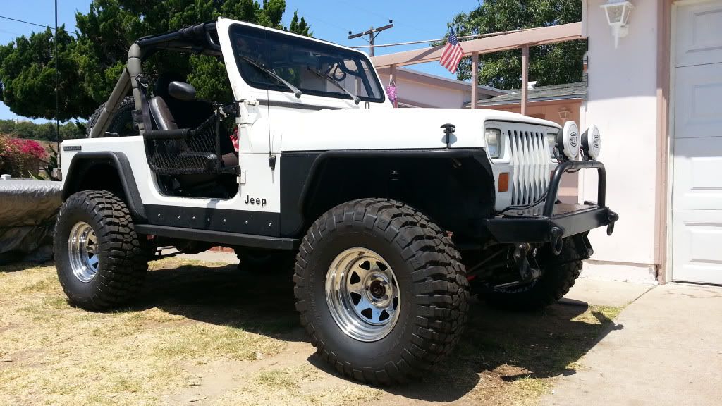

Last pic with 2" of lift:

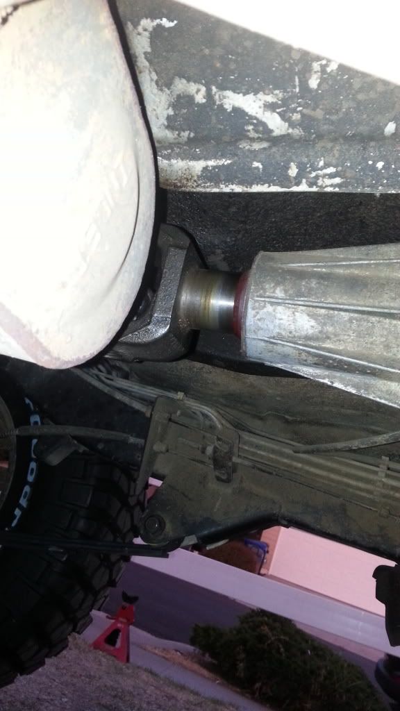

We decided to do Josh's Jeep first, figured mechanical is more important than mods. Dropped the pan to discover a broken transmission mount, awesome!:
Tried to drain the fluid, what fluid, maybe a whole shotglass full if that
Found the chain to be very lose as well:
Josh and I cleaning the T-case pieces:
Got the sucka out of there:
New chain installed:
Nice trans mount, split right in half:
New mounts in:
Draining ATF fluid:
New filter installed:
We got done pretty quick, about 6hrs in total on his Jeep!

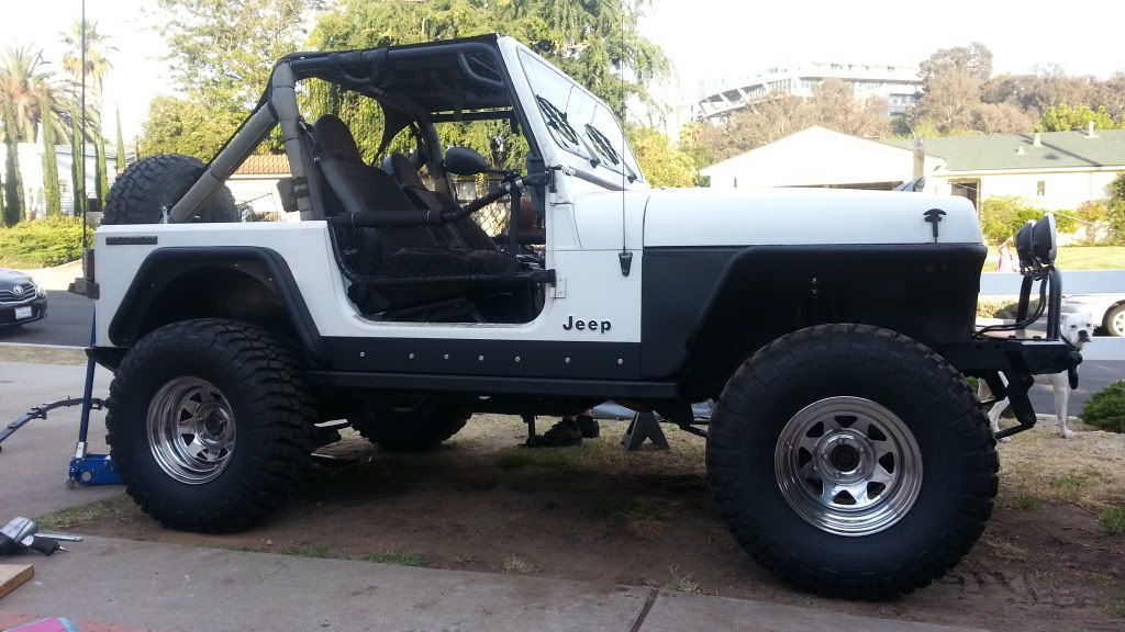

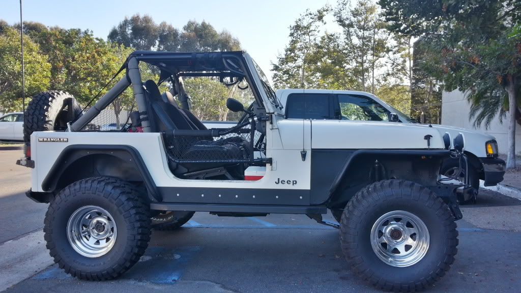

Comparing my 33s BFGs to his Procomp 35s. I was pretty surprised to see my 33s stand up very well to those 35s:
One down, one to go

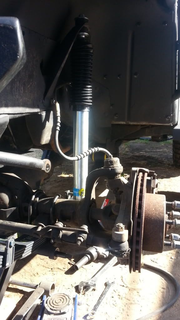

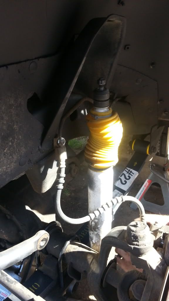

Sunday we moved onto my Jeep. Pulled one 1.5" spring, comparing to OME:

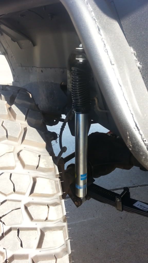

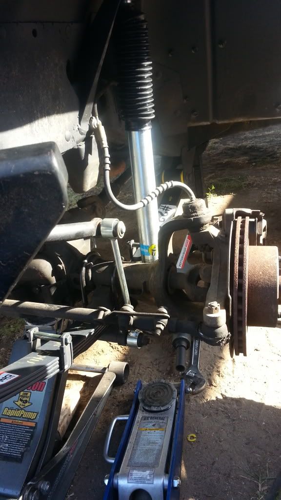

Discovered both front shocks have been blown. They didn't even last a year:
Replaced with new Bilsteins:
Passenger side done with new sway bar end links included with sponsored kit, new shocks, bushings and springs. I couldn't stop looking at it for the longest time
Finishing up the driver's side:
Onto the rear:

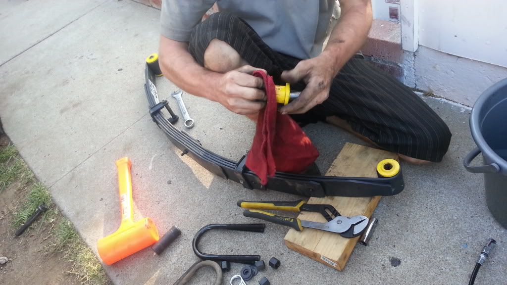

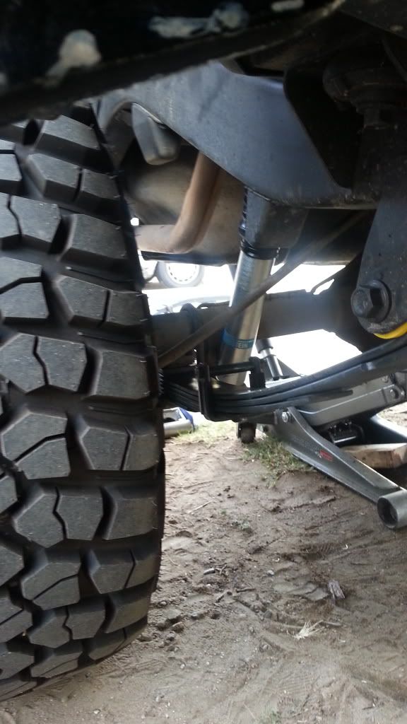

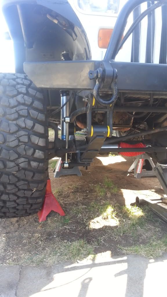

This was probably the most difficult part of the install, getting old bushings out and popping new ones in:
Some random shots during install:
Rear finished:
Rear brake line relocated using bracket supplied in sponsored kit:

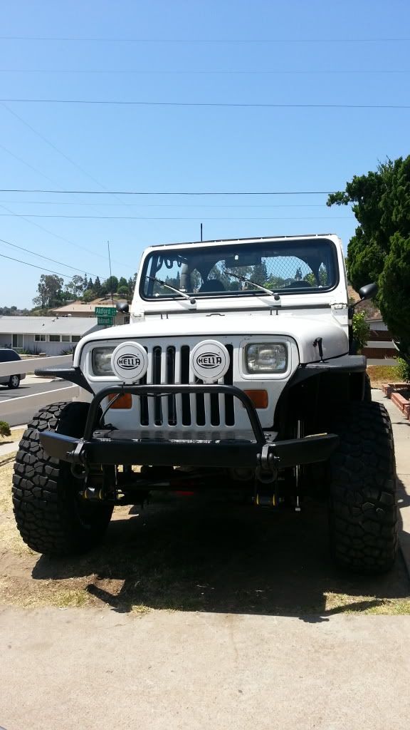

We were pretty much done with suspension install. I was contemplating on dropping the transfer case down a bit, but decided not to do it till I drove it. It came out another half inch:

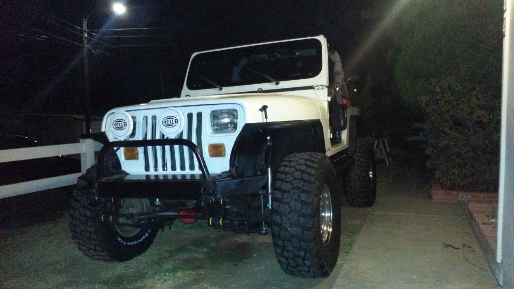

Finished:

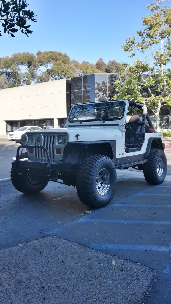

Some shots from this morning:
Some phone camera HDR shots at work:
I am very impressed by the OME/Bilstein combo. Jeep rides so much better with working shocks and softer springs. I'm getting slight vibration out of the rear shaft, going to temporarily drop it a little bit more. Once the 8.8 gets installed with CV shaft, I'll put it back up.

Man your Jeep is looking way cool. I got two questions what are your front fenders? and your buddy's Jeep in the tire comparing shot who makes that rear fender. Keep up the good work.
Thank you sir! I got two answers Front fenders are by C&C fabrication out of AZ. I ordered a DIY kit, welding required. Took a few hrs to weld up and install. My buddy's rear fender is custom made by previous owner. He used corner guards and welded tubes in shape of fender flares right onto them, then cut to fit 35s.
