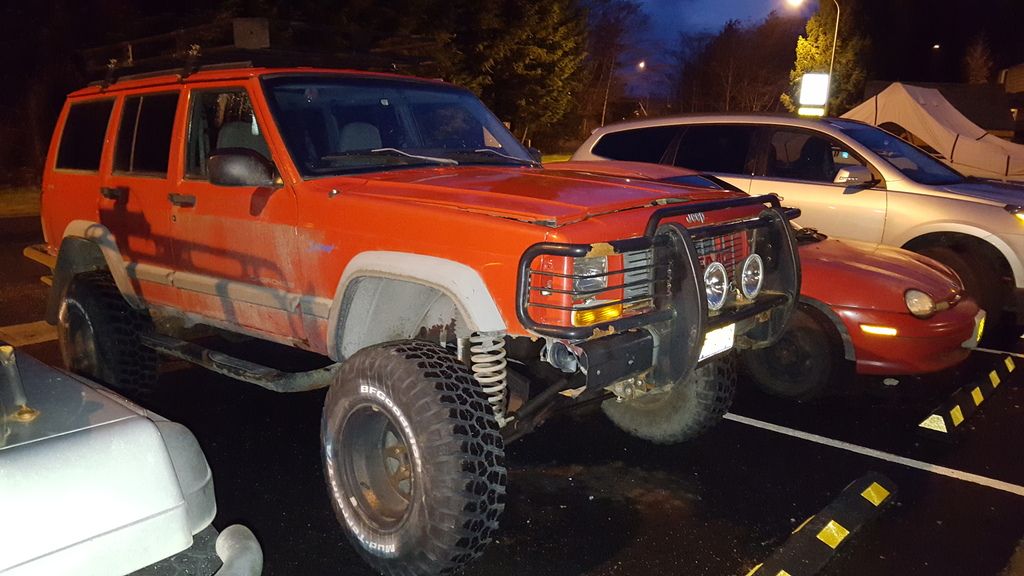

Figured I'd start a build to document the "new to me" '98 Cherokee I just picked up. I got it for FREE because the previous owner is transferring off the island and it's too expensive for him to transport. Plus, there's a few things that need to be looked at and replaced that he just didn't have the time for.
The engine isn't firing on all cylinders at current and has a dead battery. There's a loud "clicking" noise coming from the front axle, mostly from the right side. Has weak brakes, new steering components, and a few other things. From what I can see of the lift it's a BDS 6.5 " lift that's in really good condition still. No rot found anywhere but there is a leak coming into the interior somewhere I have to track down and stop.

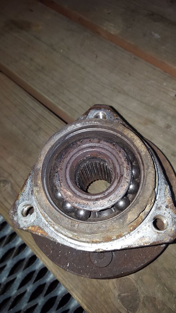

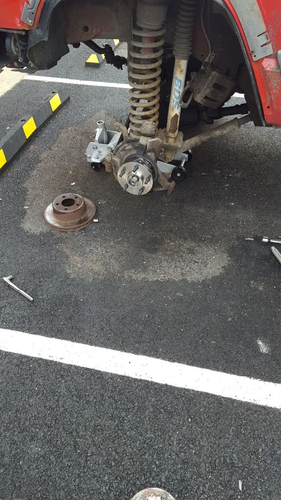

Since I'm waiting on parts I figured I'd move on to the next big issue, aka the "clicking" on the axle. I'd call it banging, personally. Either way, I jacked it up and started my usual checks with the components. The left side was nice, no issue really noted. I got to the right side and accidentally bumped the tire sitting down and the whole thing shifted sideways. That hub was toast!!!! I could move the whole thing sideways like the lugnuts were loose. Got it all apart and replaced the hubs fairly quickly. I did have to break out the blowtorch for the 36mm nut holding the axle shaft assembly to the hub. Fastest hub change I've personally ever had though. I have a video, but not sure how to post that yet.

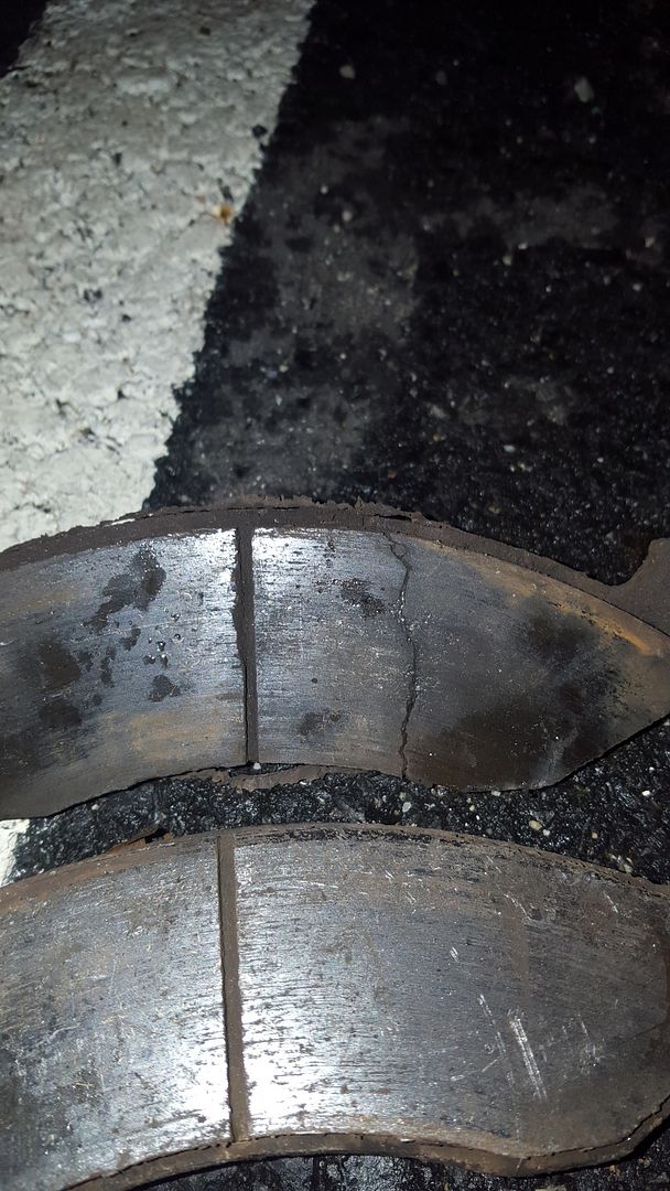

Good thing I got those free brake pads from Napa because the ones on there were worn out and cracked though, most likely since the brake pads were taking all the strain of keeping the tire upright.

Got the left hub replaced even faster than the right side. I had the boy do the all of the work this time. He did quite well. There was a casualty of war today though, my clamp, god rest it's soul, didn't make it through the day. It was snapped in half by the callus and heinous acts of the right brake caliper. I went to put the new brake pads on and the caliper would not budge. Naturally, I opened the brake line and attempted to use a clamp to open the caliper piston further and snap went the clamp. The caliper is completely seized in place. This obviously explains part of the sketchy braking on the way to the house while we flat towing it. New parts on the way....

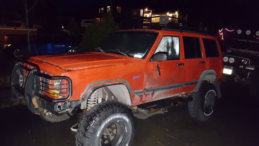

So I was looking at other XJ's with a 6.5" lift and mine seemed much bigger. Did some looking and measuring and it appears that while a 6.5" kit was put on so was a 2.5" spacer lift, its actually at 9" of lift not including the tires. I guess I just skipped over seeing the spacers on there. The rear shackles are some homemade looking garbage so those are coming off as soon as I figure out how much of a shackle lift was added..... This thing is coming back down to a 6.5" lift. There is also not a SYE kit on here; still the slip yoke...not good. So SYE and new rear DS to come. I'm sure this thing has got to have driveline vibes but was never driven fast enough to know or care. Definitely going to take some time to straighten all this out. It'll be good experience for the boy though. Time to gut the interior and clean it up, as well as measure those Home Depot shackles.

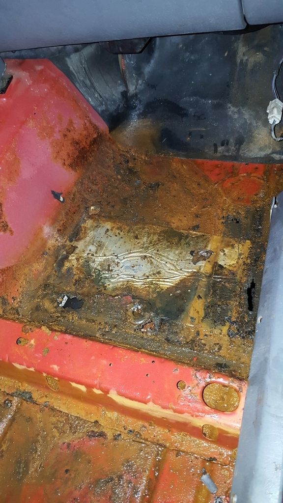

So I was pulling the carpet up to get all the water out of the inside and clean it all up and found the water coming from somewhere around the heater box. I also found that the forward floor pans on both sides require replacement. The boy is gonna get the total package in this learning process. He'll definitely understand why we take care of things sooner rather than later and was corrosion prevention is so important.
