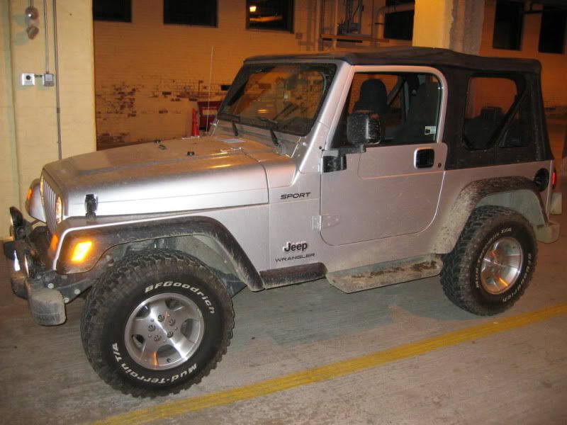

For reference, here's almost what I started with back in May of 2003 - Silver TJ "Sport", pretty much zero miles on the odomoter... minus the BFG mud terrains...

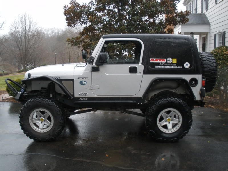

Didn't really have any plans to do anything with it... lucky for me, it had a D44 rear... And here is where it is now - 5.5" Clayton long arm with a 1" body lift, 35's, and lots of goodies... check out below for more.

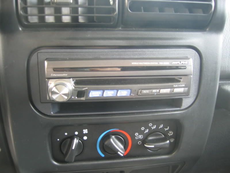

So.... stages of the build... First off, had to have an awesome stereo. The stock setup just wasn't going to cut it. Went to Tweeter up in Boston and got myself a nice setup. Read: obnoxious. Yup, I was that guy.

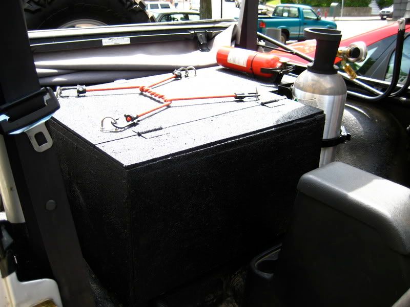

Decided a box was needed for all my tools, recovery / safety gear, etc, so built this one afternoon...

5.5” Clayton long arm
MetalCloak Bumper w/ Crawler Caps, Mid Stinger & Upper Shackles
MetalCloak Arched Tubes in the Front w/ 4" flare
MetalCloak Tubes in the Rear w/ 4" flare
1” body lift
35x12.5x17 Nitto Mudgrapplers
17” Silver AEV Pintlers with Beadlocks - my second set of AEVs, since I crack two of the non-beadlock versions
Superwinch EPi9.0
12VoltGuy in-cab winch control
Teraflex SS SYE
Tom Woods driveshaft
4.56’s
OX in the rear
Herculined tub
Clayton Engine & Tranny skids
Kilby Gas Tank Skid
AtoZ Fab rear bumper with swing out tire carrier
AEV Third Brake Light
Chromoly Shafts front and rear
Currie Heavy Duty Steering
Warn Steering Skid
Rubicon Express Hand Throttle
JKS Motor Mounts
Custom box
Tree saver, tow rope, shackles, jumping cables, tie downs etc...
First Aid kit
Fire extinguisher
CO2
K&N FIPK
Raingler netting - keeps the dog in the back
PIAA 520s Driving & Fog
BDS Rockers
Cobra 75 WX ST
Alpine IVA300 w/GPS, Ipod hookup, and DVD bypass
... and painted black headlight bezels

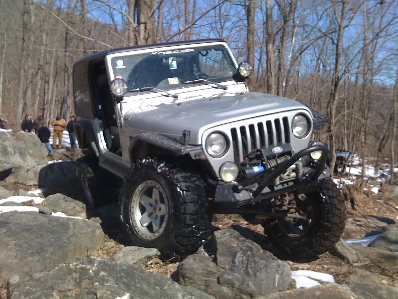

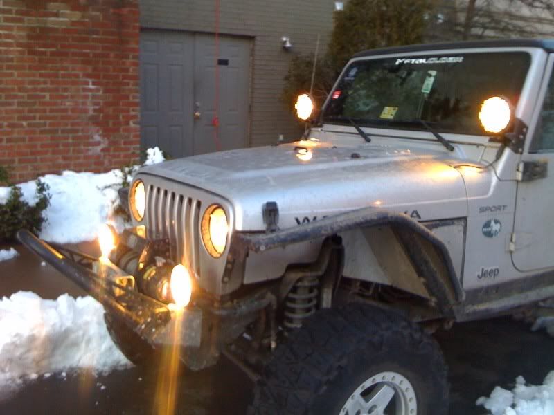

The goal was always to build this as strong as possible... I've thrown a good amount of stuff at it so far...

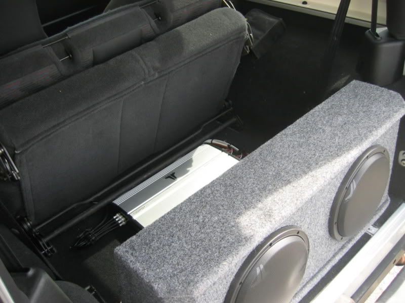

Did the amp get enough air flow while the seat was folded down over it??
Surprisingly it's fine... it does get pretty hot with extended use, but airflow is relatively good - better with the box over it. I keep toying with the idea of running a tube from the passenger side floor vent to the back, but haven't had any issues yet. Top and doors off for some of the spring / fall and all of the summer make it unnecessary.

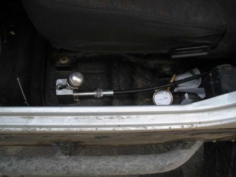

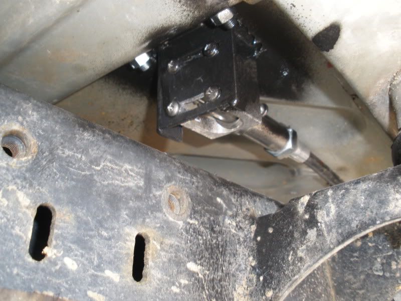

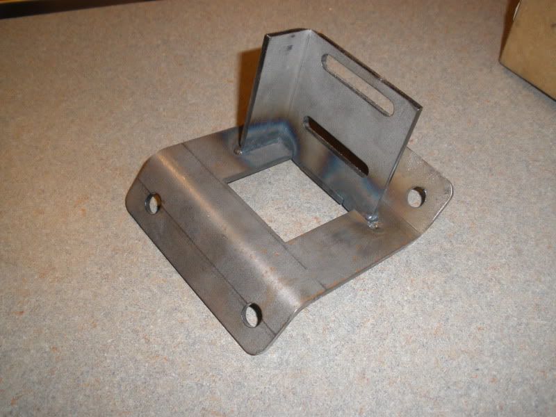

I love coming home to packages from brown santa. Got my new OX mounting plate from Searchers today. It seems pretty well machined, and definitely sturdier than my old mount.
I never liked the original location of my shifter - when i was wheeling with the doors on, I would have to open the door to engage / disengage it.
So, I started looking for other options and this seemed like a great solution. The first pic is of the mount upside down in it's future location, and the second is how the shifter will look when installed.
Overall first impressions - looks really clean, and I think install should be fairly straightforward with a little cutting into the tub. My only concern, at the moment, is water getting into the shifter housing, as the housing is exposed at the bottom and on the side. Any suggestions are welcome... I can get some of the way with an RTV type product, but may end up looking for something a little more substantial. Here's a pic from their site that shows what I'm talking about...
Plan is to prime, paint, cut & install this Friday... more pics to come.
Also got a Currie EZ deflator... go tired of fully removing the valvestem each time I hit the trail to get down to 10. Like this, I'll never lose one again!

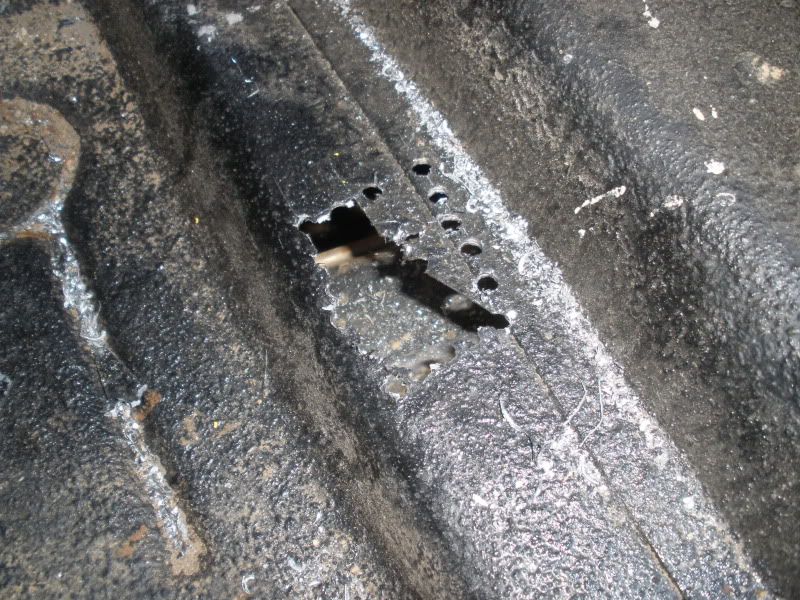

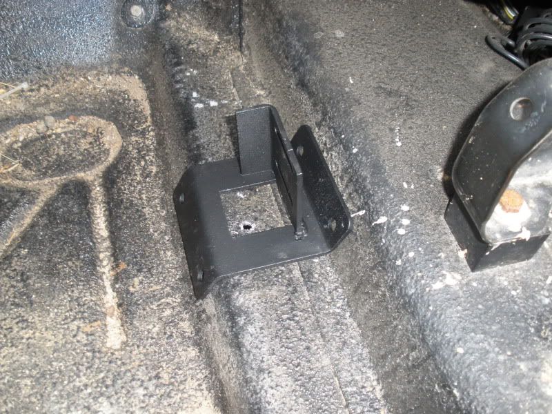

Spent a couple of hours this morning re-routing my ox cable / mounting the shifter in a new location. I think it turned out pretty well!
Getting the right placement...
Drilling / cutting... not pretty, but it worked!
Mounted! Nice and clean!
Underside...

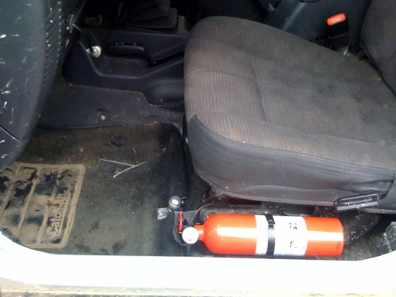

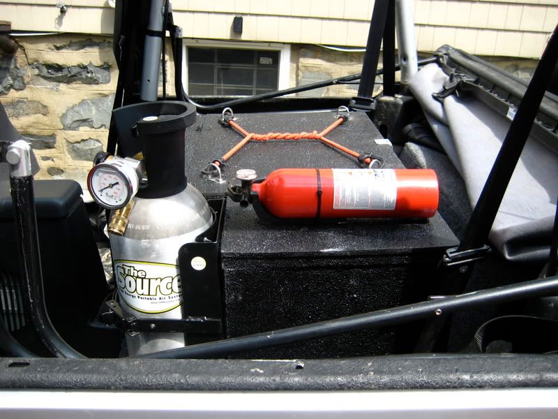

Now that the shifter is moved, time to put the fire extinguisher where I wanted to have it in the first place. Much easier access... just in case, right?

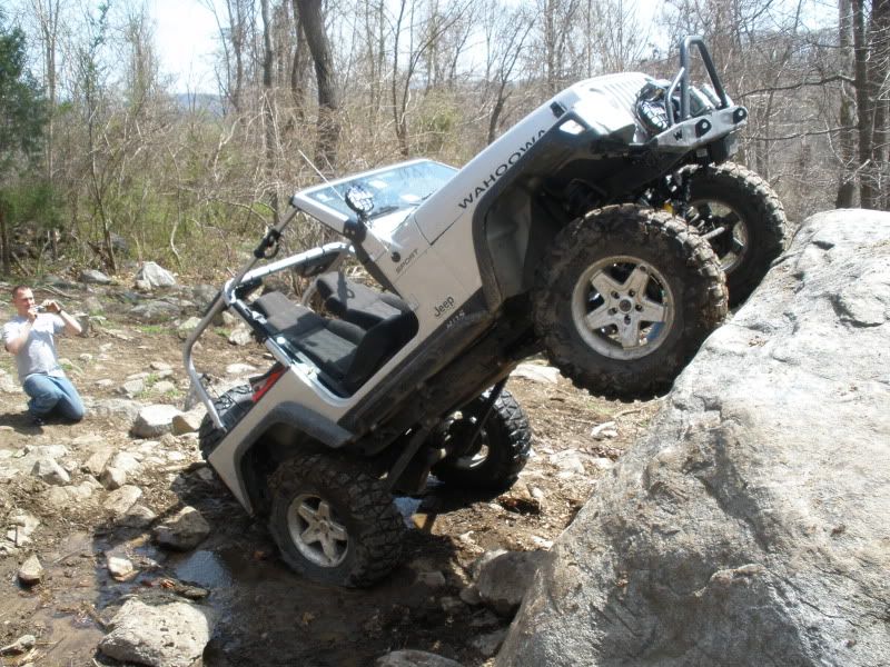

I put these pics up in my MetalCloak build thread, but thought they fit here too... amazing articulation / clearance with this setup.
I think this is about it for mods... for now. I'll keep on adding to this as things get put on / I get out on the trail more
