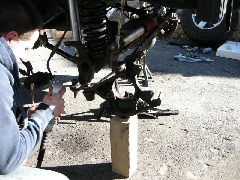

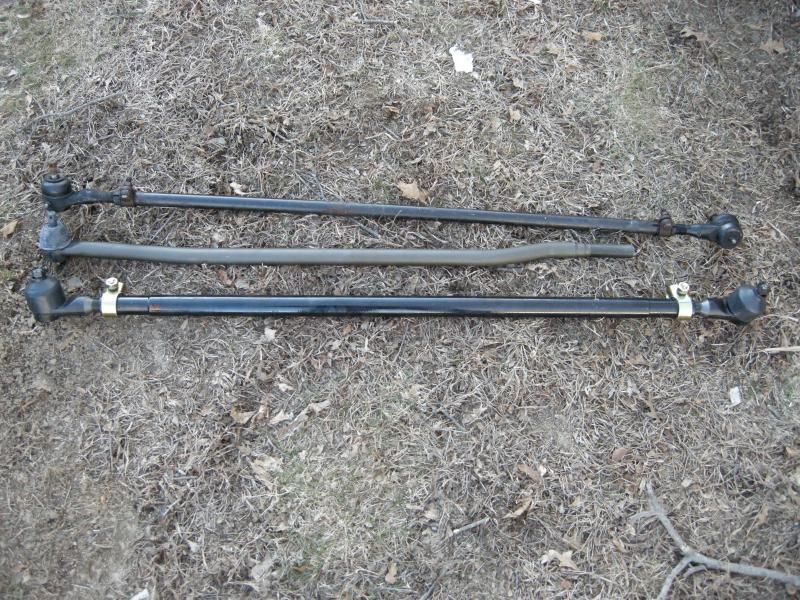

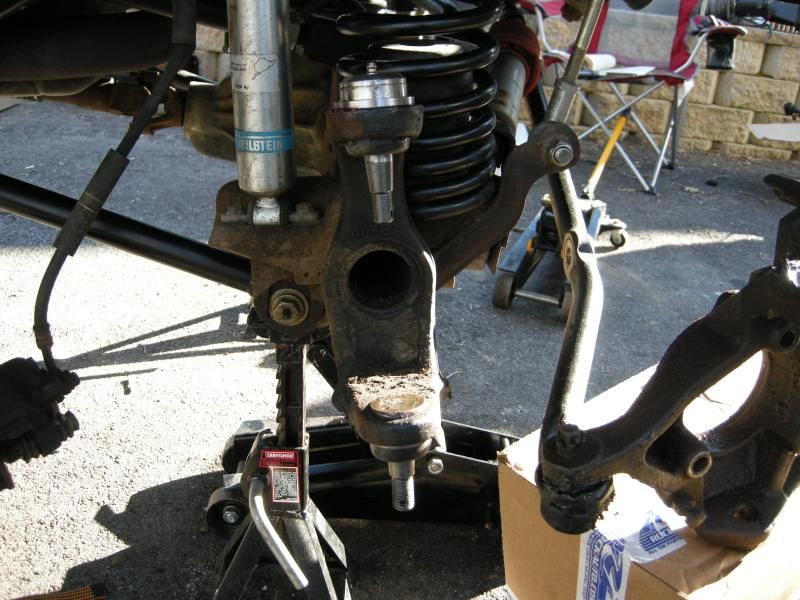

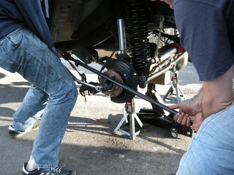

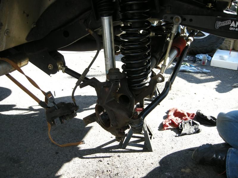

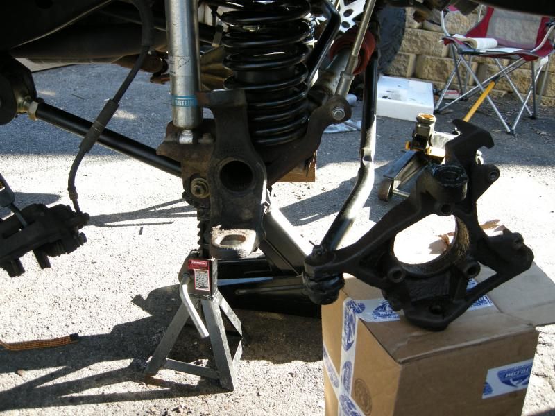

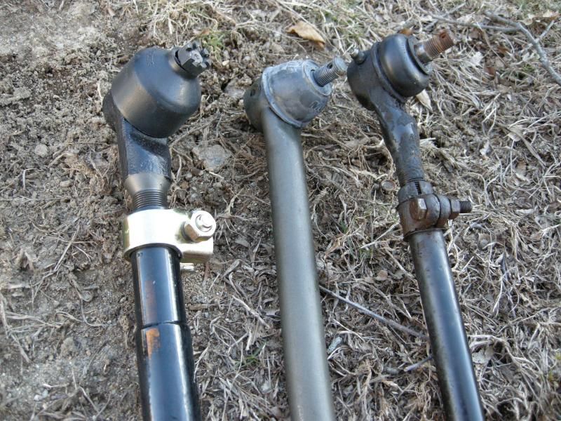

Some more shots of Alice under the knife.
Our solution to hold the hub while breaking the axle nut.
Comparing stock with the ZJ and Currie tie rods.

No Omen, just a slight hang up. I can't tell you how many time's I've been working on something, or just spent a ton of cash on something, only to have something else completely unrelated pop up immediately afterward. It just happens. Just in recent memory.... pulling out of the garage late at night after finishing up my lift install....radiator blows, no warning. Put my new wheels on... test drive, HUGE exhaust leak, a manifold stud broke off in the head requiring me to pull off the head to extract it! So anyways.... I only share that stuff to make you feel better. **** happens.
I know. Seems like every time I spend all of my extra cash on jeep stuff- something breaks. Good news is even with the soft top purchase... I should still have barely enough to get an entirely new clutch assembly. And a tranny jack. Ill be going out to the hardware store today or tomorrow and picking up the basics so I can at least check my rear brakes and hopefully figure out whats going wrong there.
As far as the tie rod- well I haven't figured that one out yet. I am thinking solution is to just buy a new draglink and stick that on there. Then- hopefully... fingers crossed I will be all set.
Unfortunately- this pushes out the bumper powdercoating until at least next week. I don't think I could handle driving that far with that rattling/knocking sound even if it is safe to drive.
As for the tie rod, you may want to look into getting a nut splitter as well. Split that nut off so we can get it back out and then just maybe get a new TJ drag link and see if we can stuff it in the hole. That's what she said.
Hah. Now- i have no idea how this would work to get the new tie rod our of the stock draglink with the threads intact. Just no freakin' clue - so I'm relying on you guys in hopes that I don't have to buy a new tie rod.

Originally Posted by AndyE View Post
Just let me know the when and where and I'll be there.
Well- I will order the parts today. I will hold off on the ebrake stuff until I am sure that it doesnt just need an adjustment.
Whats your take on getting the new tie rod off?
If my luck holds- wanna take a trip up to the lovely northwestern CT saturday? The drive isn't too bad- I took 95 to 9 to 66 to 691 to 84 to 8. Pretty much straight highway. Ill make some room in the garage- and we will see what we can do.
Before you buy a clutch get someone to diagnose the noise. Doing the clutch is going to be an all day job in itself or more and is not one you want to do if you don't have to. We don't wanna get Andy in over his head here!!! In your situation where you need this vehicle for work, it might be worth it to pay a clutch shop to knock it out in a few hours, so you can focus on the steering.
To get the tie rod off, take off the entire assembly, and use a sacrificial nut on the end of the TRE so you can hit it with a BFH and not damage the threads... that would be my approach at least. There may be a more graceful way to do it.
