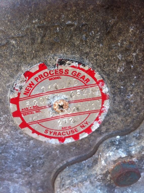

someone has 242 hd
il have to put a pic of the finish swap under neath
247 swap 242 hd
242 hd came out of a 2003 4.7 fit right in

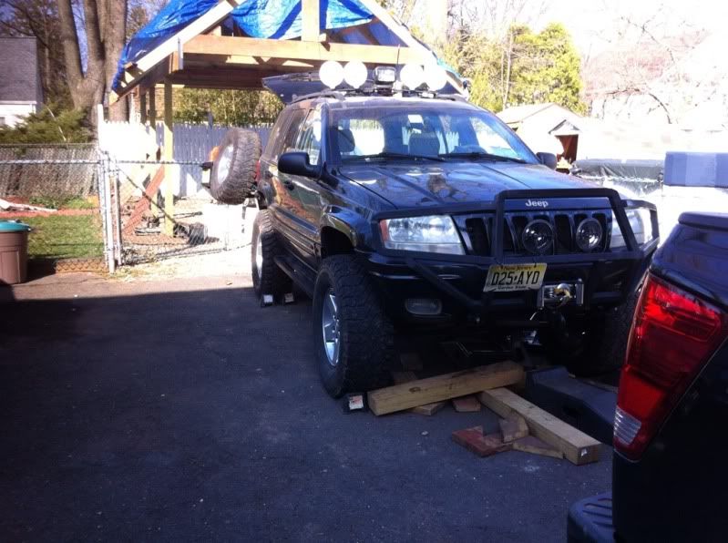

front gears and hd transfer case finally install and working right finish doing front yoke so it fit right i took a yoke from a d35 and mill it down to fit the d30
front high lift jack holder added to my front grill guard

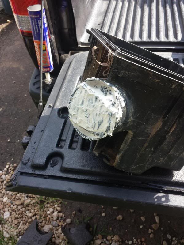

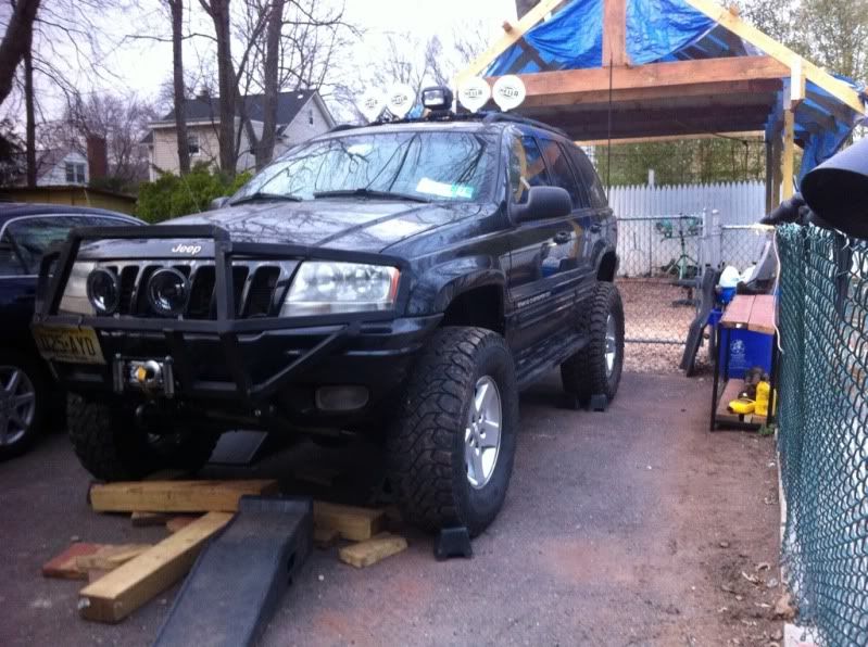

completed snorkle i bought the fiber glass kit from another jeep owner that he bought from a friend so no way to trace where to buy this all i know is that its the same style snorkel as the ones use in europe for the diesel wj i believe this is the web site where to order them i think http://www.rocasilva.com/snorkel-con....php?rubrique1
well here is the pictures
i always to take more pictures but im getting better at it

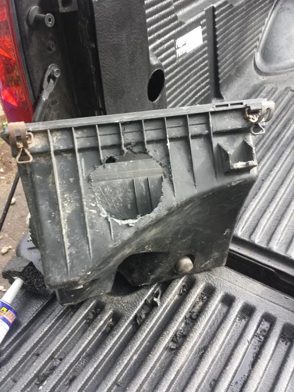

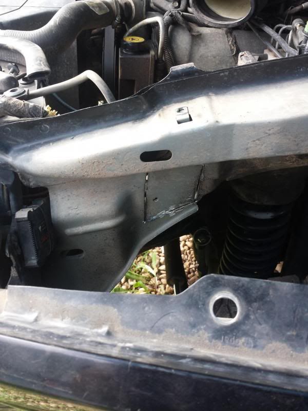

had to take the fender off to cut the hole for the house that goes to the inside part of the snorkel to the air box

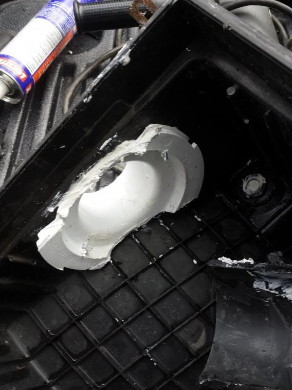

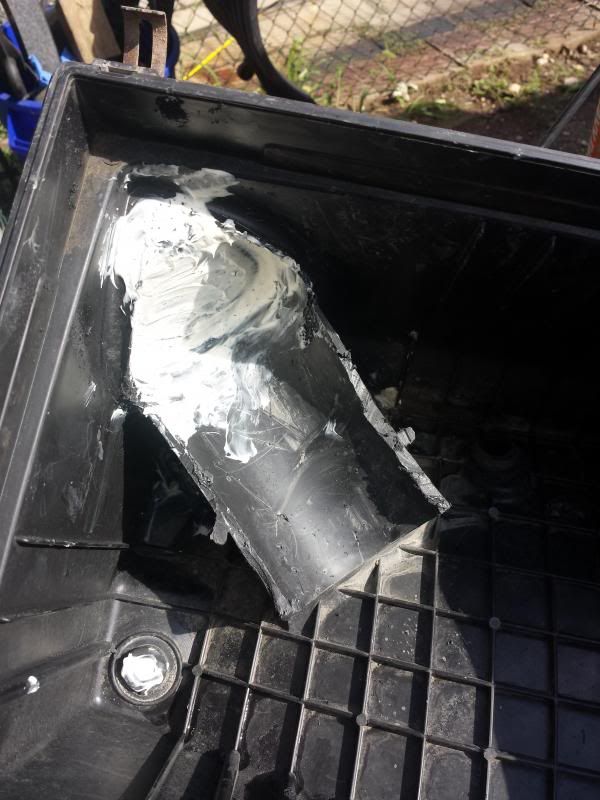

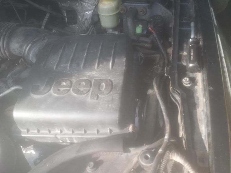

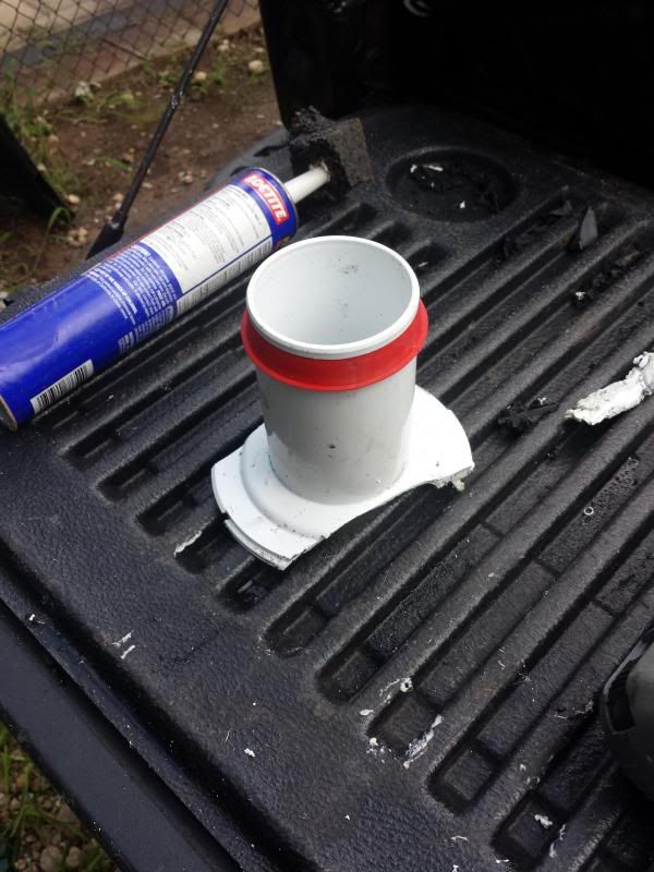

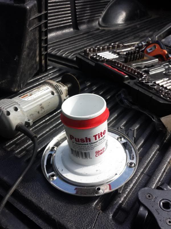

next i plug the hole on the air box with the front bumper foam i still had laying around and i put water proof appoxy all over it every heal crack and all over the foam also cut a side hole on the inside of the air box i purchase a push tight pvc adapter that is use for a toilet and cut it up to fit the hole and seal it and screw it in tight for the air hose to connect to

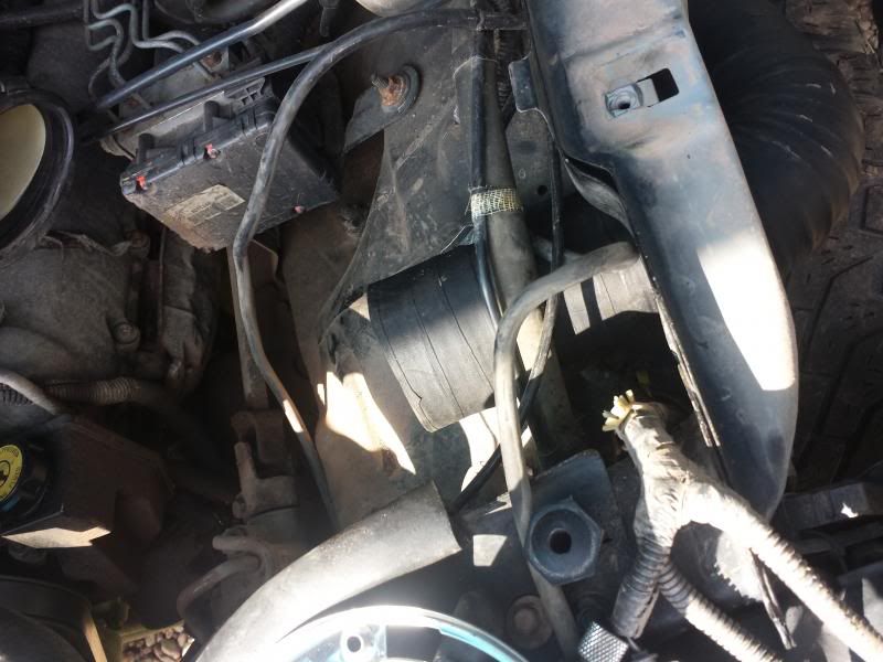

here is the air box install and connected
completed snorkel
