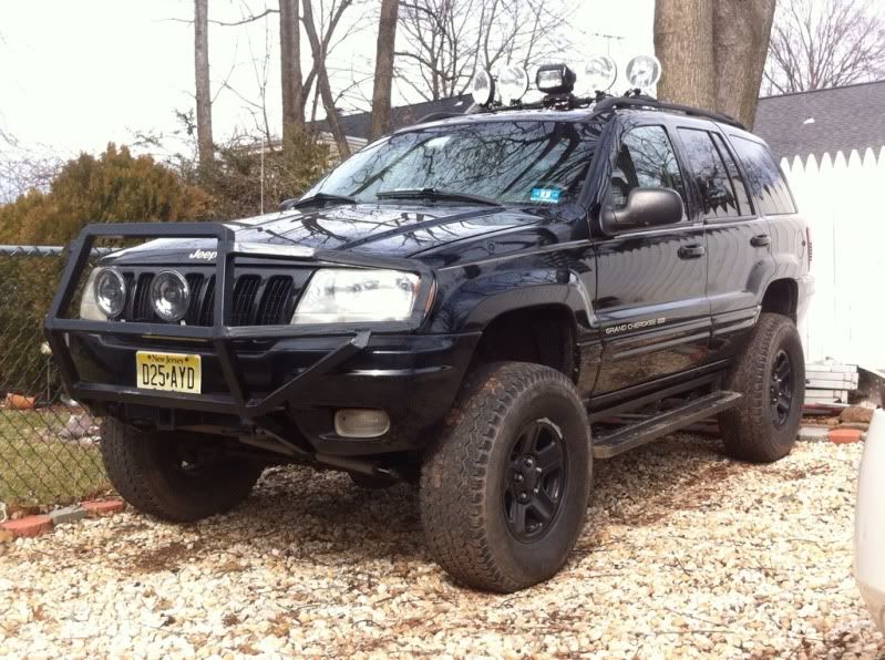

Side rails and brush guard
Added rock rails removable steps, front brush guard , hig Hellas 700 and 500 black magic, golight Stryker, dual stabilizer, wheel spacers 2"
how bright are my lights u ask ?
only head lights
all of my roof lights lights
did i mention that wheeling my rear sway bar mount on the frame rotted away ? well a few months after i fix it the other side went
broken
i didnt see a good place to weld at the time and didnt and still dont have a good enough welder so i put a very thick c channel inside the frame that is very long and welded nuts to it and a think l braket on the outside secure with bolts i performed same surgery on both sides and i been wheeling with it hard and it still holding up strong

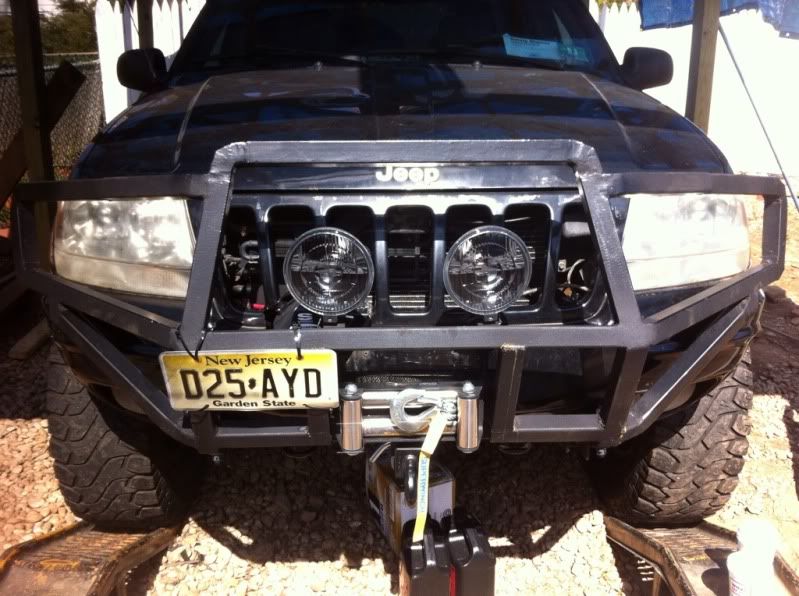

How did u build the front brush guard?
Wj168900 is offline
post #8 of 42 Old 03-28-2013, 07:06 PM Thread Starter
Mjaime_007
Location: North Plainfield
Posts: 61

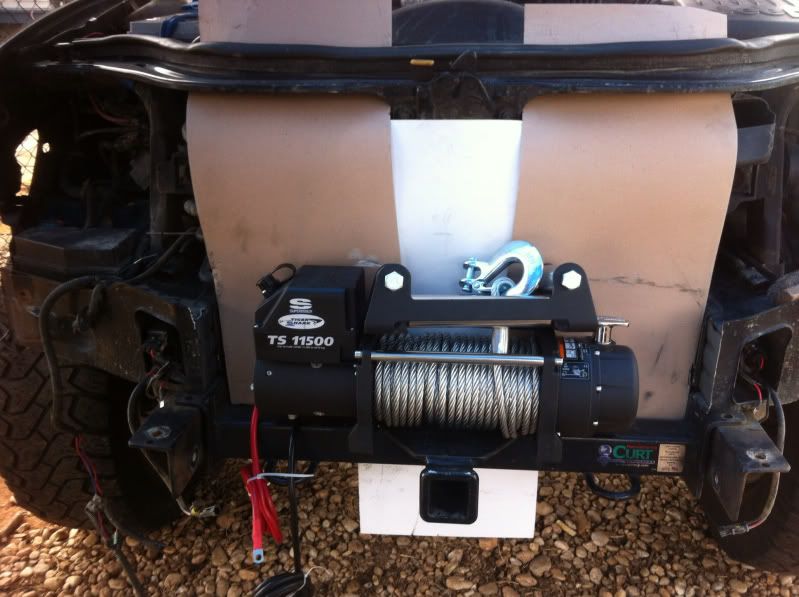

i forgot to take pictures but i preaty much started with an idea of putting a front hitch so in the future i would have a hitch winch but insted i ended using the hitch as brakets and c clamp some steel beams and started cutting til i came up with something i like new project for this week is an actual hidden front hitch mount pictures to come later
before cutting the frame out for the hidden winch
after cutting it

Can you out up pictures of the brush guard I want to see how it was builded

Is there any chance you can send me specs of the brush guard
Wj168900 is offline
post #12 of 42 Old 04-03-2013, 08:45 AM Thread Starter
Mjaime_007
Posts: 61
I could take measurements il take up lose pictures of it later, I pretty much install a front hitch one day a week later it look empty to med so I took cople c clamps and some square tubing I had laying around and started welding stuff together

Ok thank man I really like how it look i cant wait to start building mine and why instead of putting the hitch u put a sheet of metal and use it at a skid plate?
