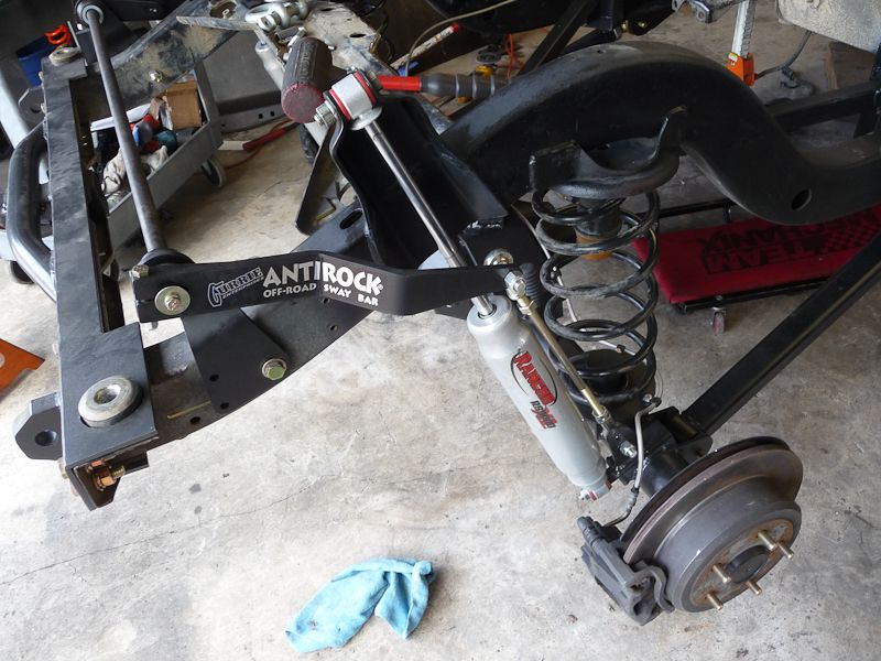

No need to split it. Just taper the frame cut and shape the tower to the taper. It fits my giant Rancho shocks fine so it should fit any. I got a little carried away with the taper, but here's a picture to show what I'm talking about.
That looks good , really good in fact . Did you heat the flanges to roll them over ?
No, just welded the top and the bottom and bent it over with a BFH. It's only 3/16" steel, so not very hard.

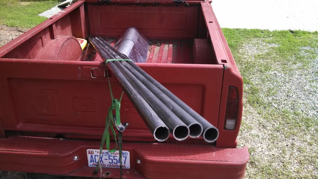

I finished scrapping all the old tub parts and scrap steel this morning . The proceeds from the scrap yard almost covered the cost of the 1.5" tubing . If you look closely there is a set of 1/8" rolled aluminum corners , and out of sight is the tailgate filler panel . Busy morning/afternoon loading and unloading , but I am wiped out from the heat . For now I am going to stay inside and cool off. Tonight when the temps drop I will head back out to do some more body work .

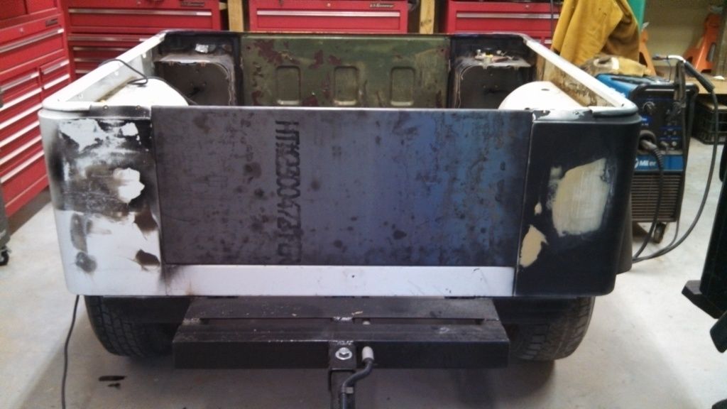

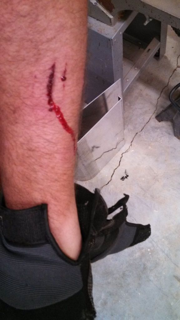

Every once in a while the metal bites back . Doesnt look like much , but it was enough to throw Kimbo into the official nurse in training mode .
The filler panel is in place and ready for the final bending and fitment .

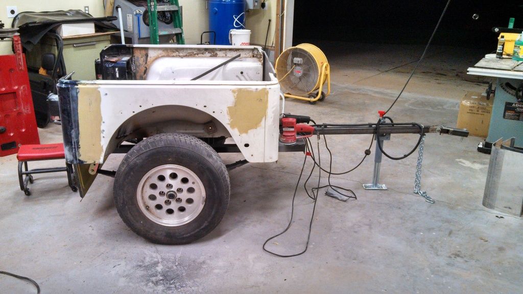

Skim coat is on and drying for the night . Tomorrow I have more sanding and primer to spray . I still need to finish welding the floor corners in , but they are currently halfway welded in . From here on out is all finish work , and if I dont make it Friday to get it inspected , I will take it to the State Highway Patrol early next week .
