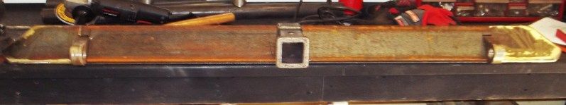

I just finished welding the rear bumper and much to my dismay it has pulled . I ran too much bead at one time and the result is a slightly warped bumper . I am going to put it in the 40 ton press and see if I can get it close to true ... pics to follow .

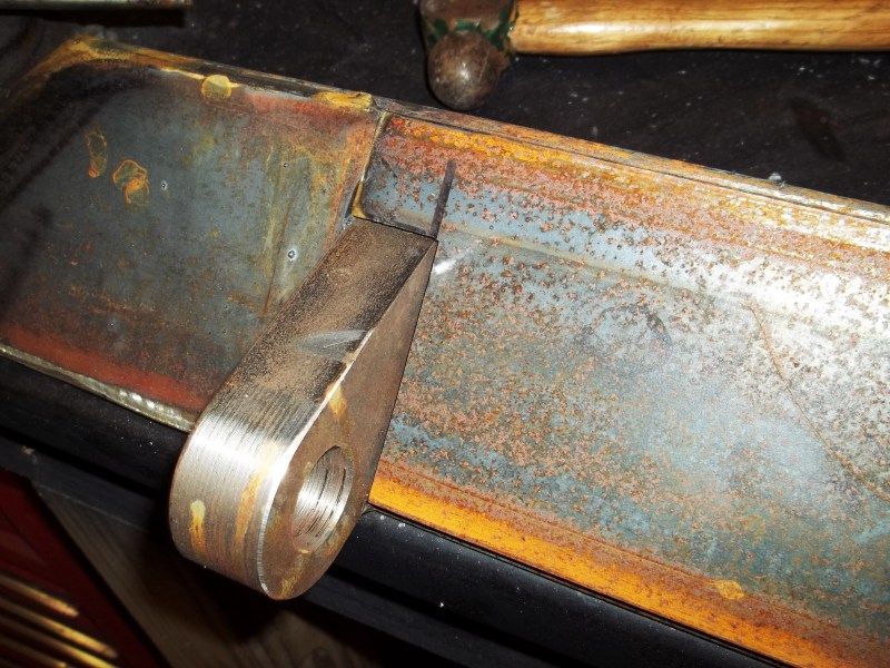

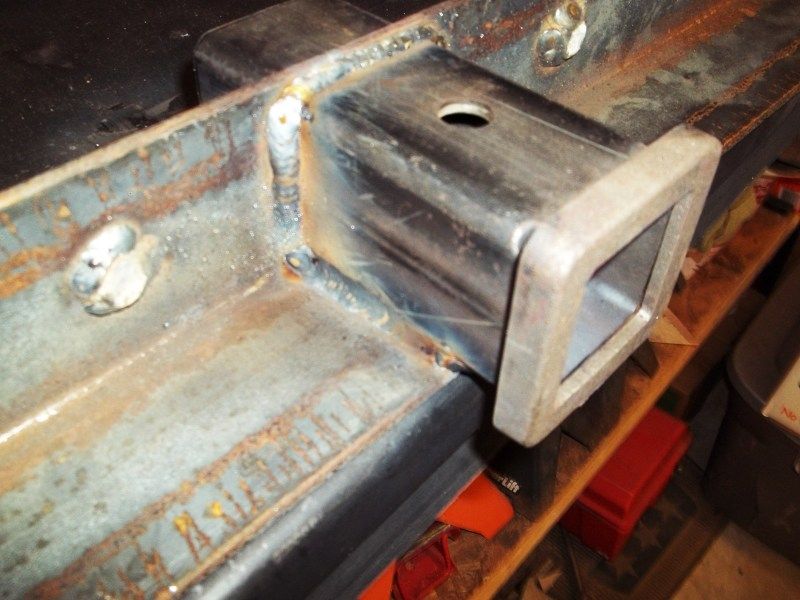

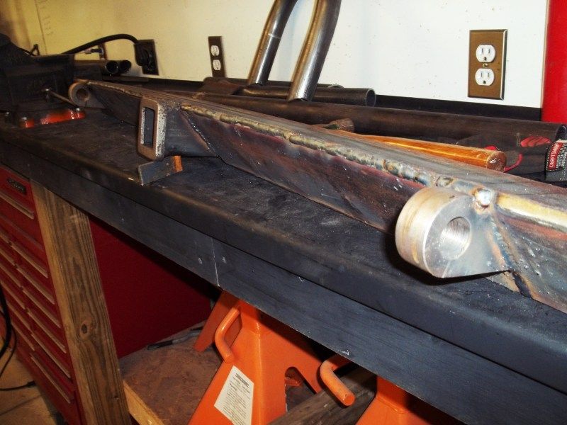

Receiver in and welded up .

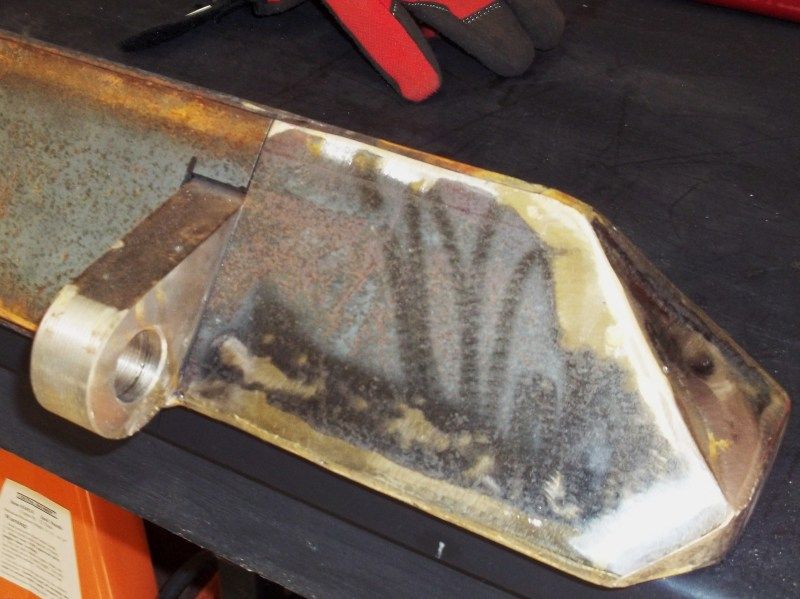

Metal plate all cut and fitted .
It took two passes to fill the gap , sure made for a lot of grinding .
Installed ! It took 30 tons of well applied pressure and I was able to spring the bumper back into place .

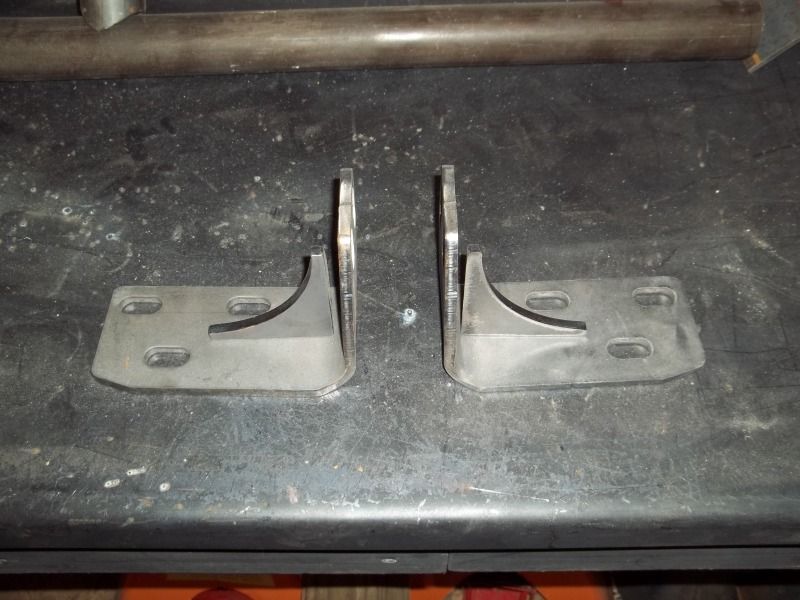

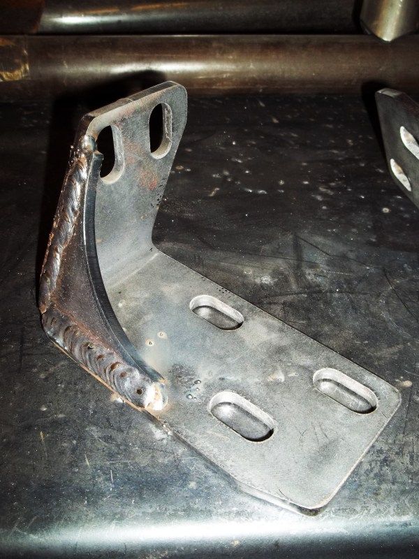

Tie in brackets fitted and welded . I will get them installed when I get back home at the end of the week .

Wish I could take credit for the brackets, but all I did was weld them up. They are A to Z tie ins, and they fit perfectly. I am going to make the inner ones myself, and they will be similar.

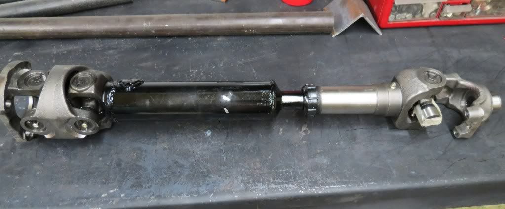

New rear 1350 CV with long splines from Carolina Driveline out of Spartanburg S.C. I was working in the area and I called them on Wednesday and this was ready for me Friday morning . Harry was awesome to deal with and even rebuilt my stock shaft while I was there .
Rebuilt now fully serviceable front . It also got a new slip and splines as the old one was worn out . I have been having an odd whirling noise for a while and I hadnt figured it out . Harry pulled the front and I went off to BoJangles for a biscuit . As soon as I got to speed there was no more whirling noise. By the time I pulled into BoJangles Harry was calling me to tell me the shaft needed more than a new CV center . In 45 minutes he had it completley rebuilt and ready for me to go . Fantastic service , great price and a fellow Jeeper .

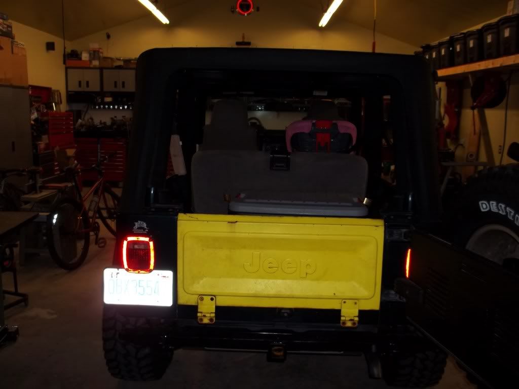

More retro for the LJ ...

I got the new front driveshaft in with no issues , so I decided to move on to the rear . The new u bolt style yoke went on with no problem , so far so good .
