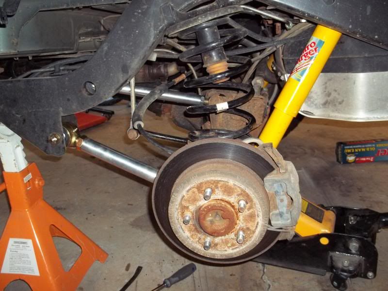

Rear control arms are all in and torqued to spec . Its 60lbs for the uppers and 90 for the lowers according to Currie .

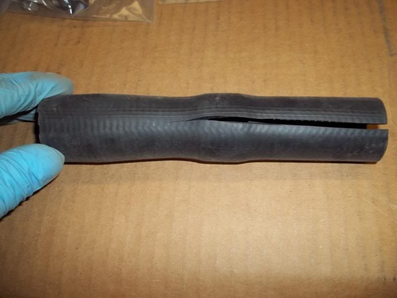

Went ahead and did the SHoppe mod on the gas filler . I found it easier to remove the check valve and install it in the Jeep rubber hose .

Originally Posted by AndyE View Post
Holy rust Batman!
Brake rotors always rust ? And the axles have some surface rust , but thats all thats on it .
Originally Posted by dayriesw View Post
Time for por15 and to move to the south
Rust Oleum and a wire brush will make quick work of it , just ran short of time . And theres no way I could live that far south , its just too hot for me .
