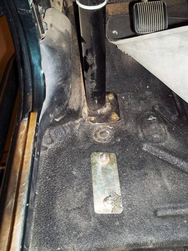

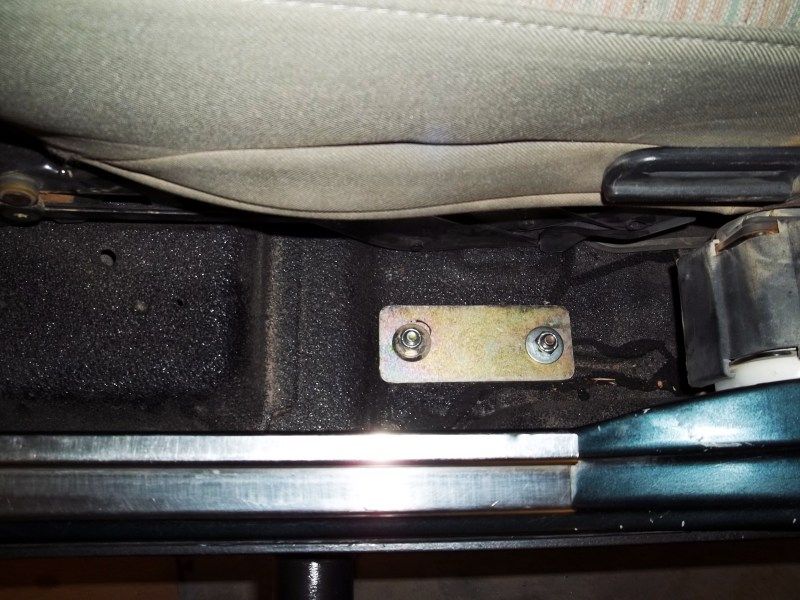

I got the first slider installed today . I ended up spending most of the day dis assembling and prepping for the sliders . The pictures will show you why .
This is what was behind the stock slider . No rust , but a lot of dirt .
A little garden hose action and it was all cleaned up .
Once the hammerite was dry and the gaskets were applied it was time for a test fit .
Most of the install was pretty straight forward . Get the center where it needs to be and then work your way out . The part that has me stumped is the blind access for holes 2 and 6 . I cant find where to access them , so I am going to email Rokmen and see if I can get some instructions. Theres also a lot of backers that dont seem to have a home .I am sure they will make more sense when I look at it tommorow morning and the heat stroke has cleared

post #253 of 4130 Old 07-28-2012, 08:50 PM
Hendrix
TJOTY 2013
Hendrix's Avatar
Location: FT Myers
Posts: 4,868
You have to drill through the inner, add a backer plate and long bolt to the holes tthat you cannot access .

post #254 of 4130 Old 07-28-2012, 09:13 PM Thread Starter
G Beasley
Join Date: Nov 2001
Location: Eden
Posts: 5,707
Ahh that makes sense as I couldnt find anywhere to access the back . I think I will make a drill guide to keep the bit square as it goes through . Thankfully I have some 12" bits that should be perfect for this .

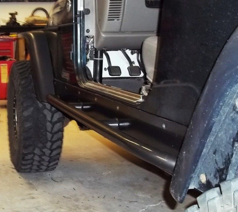

post #255 of 4130 Old 07-30-2012, 09:29 PM Thread Starter
G Beasley
Join Date: Nov 2001
Location: Eden
Posts: 5,707
I had emailed Rokmen Sunday night asking if I could get a copy of the install directions . Jeff from Rokmen emailed me back and said to call him on Monday morning . I called him up explained that I had bought the sliders used and didnt receive any instructions . He treated me like I had just bought them from him , talked me through the install and then emailed me a pdf to check out . All in all I was shocked to receive that type of service considering that I bought them used .
Enough talking heres the last of the install pictures .
Both sliders are on and Hannah Monkey approved . Theres a lot of drilling during the install . All of the attaching points make for a solid connection.
