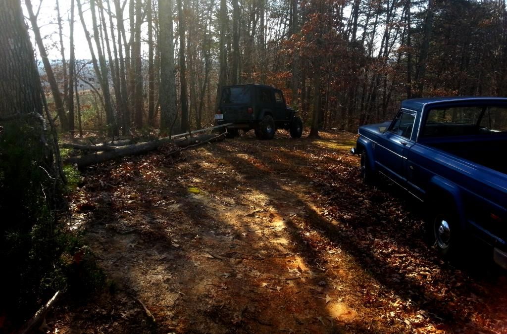

Got the yard cleaned up today and I picked up the new to me break ...
