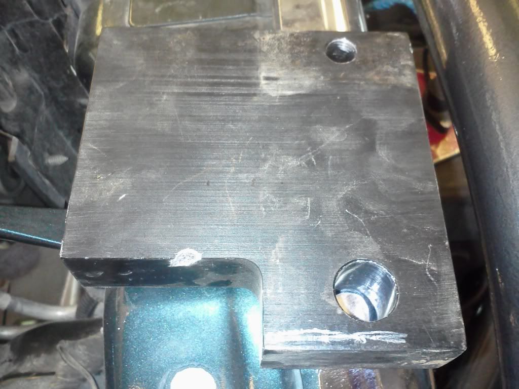

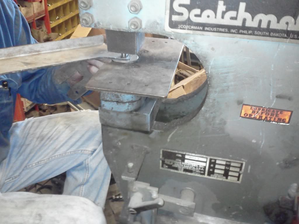

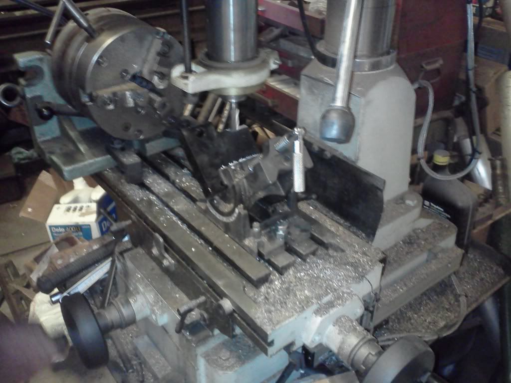

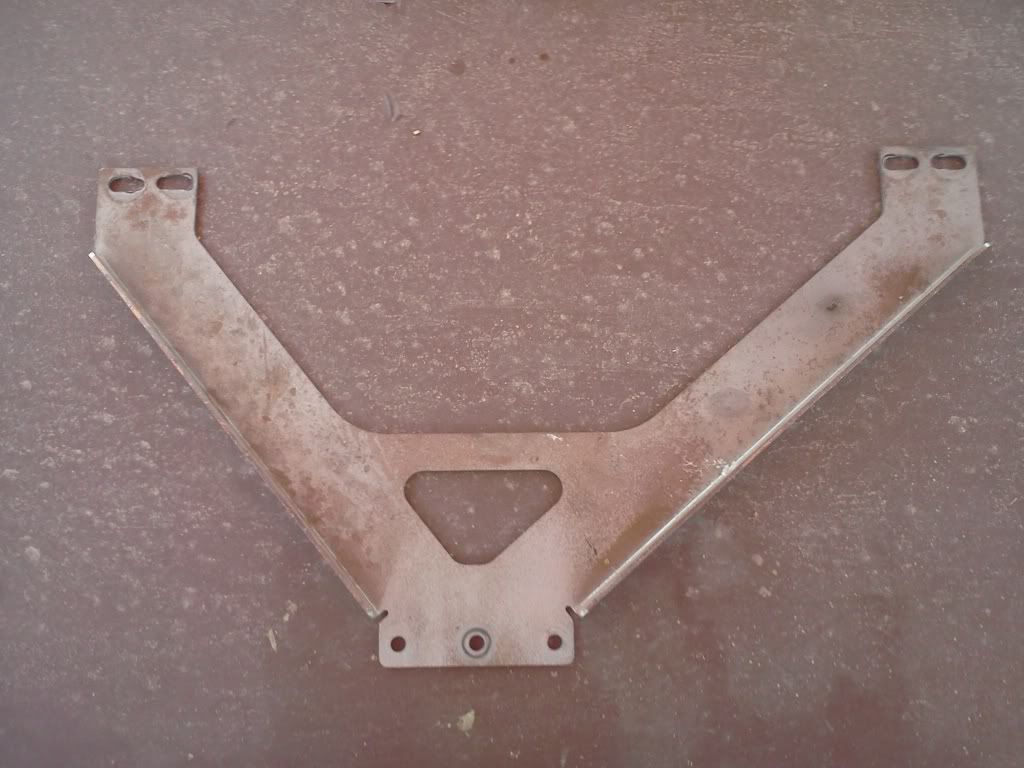

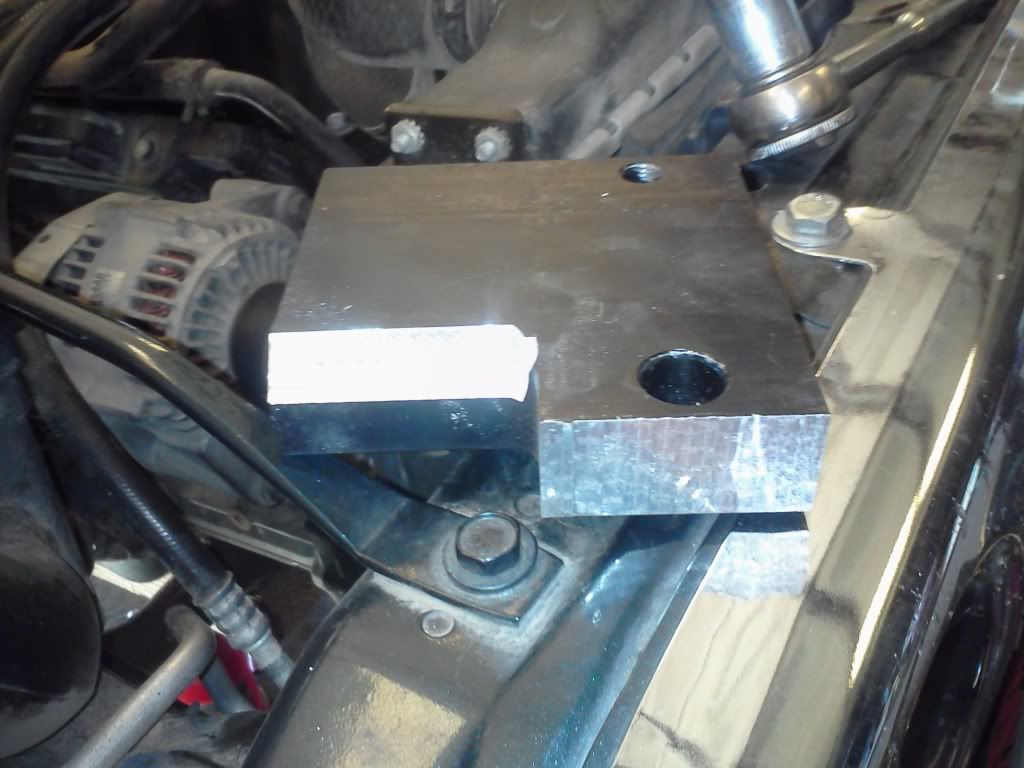

And this is how I fixed the Savvy Under Armor buzz . It was lots of fun to drop it at the cabin on the gravel driveway . I will say it is easy to remove and all you need is a philips screwdriver and a 9/16th wrench .
First off was to find a jeep friendly machine shop in Blanding Utah . Luckily I knew Jack Montella and his son from previous visits to Blanding . If you are in the area and need work done I highly recomend them . Fair pricing and they are durn nice people too .
Next up was to remove the offending motor mount lift plate . If you look at it you can see the bright spot where it was hitting .
A little mill magic ...
Voila ! One part of the puzzle fixed .
Next up was to elongate the holes on the front brace . The iron worker made quick work of this !
And with this my vibrations have ended and I no longer have to fight putting the front brace on . We removed a lot of material on the lift block , I dont know if anyone else is having this problem or if my Jeep just doesnt fit the mold . Either way it is a LOT quieter and the vibes are back to what I had from the factory .
