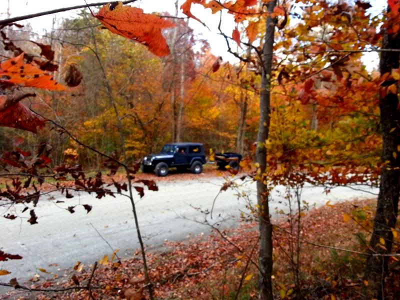

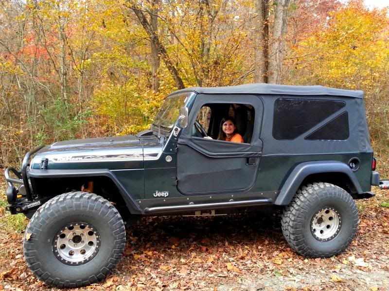

Today we took the trailer all over the county , even on the interstate so that I could get up to higher speeds . I am relieved to say that the trailer has no quirks at any speed now ! Heres some pics from the day .
It was a great day of towing around and running errands with nary a wiggle from the trailer .

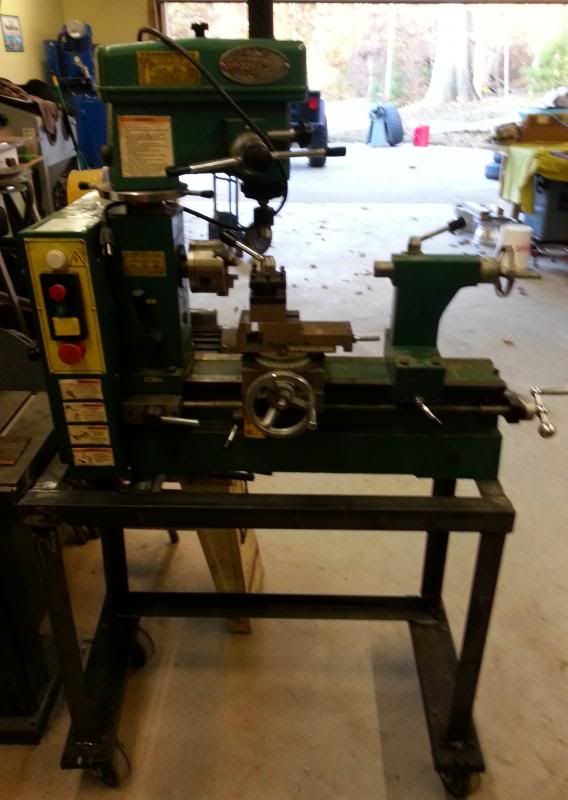

And the garage got cleaned up so this could get moved into its home .
