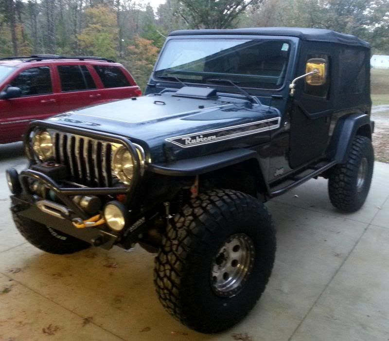

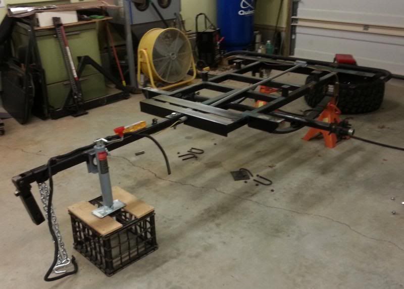

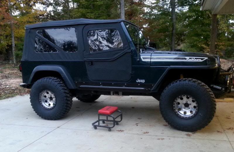

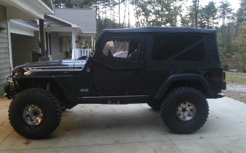

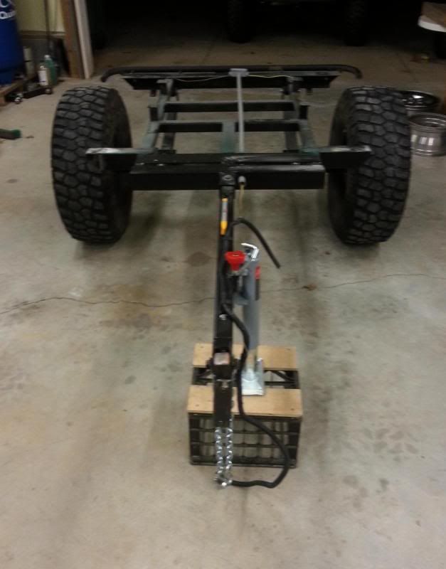

Made some good progress today on the LJ and the angry trailer . I am sure you are wondering what is an angry trailer ... well follow the pictures and you will see .

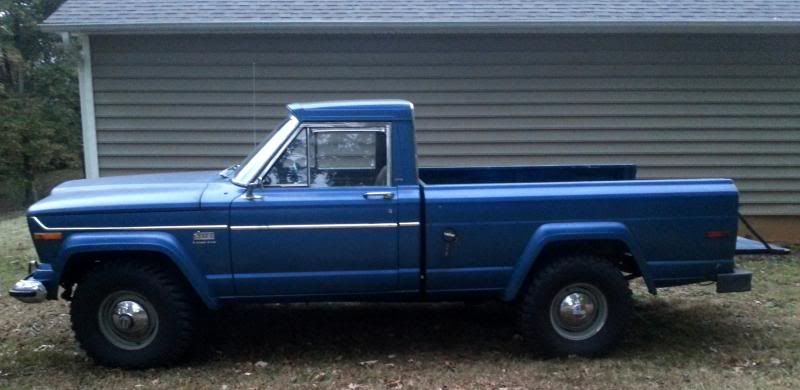

First up I finally got the hubcaps for blue picked up and installed . I am off to the junkyard tomorrow for some various stuff and I will hunting for a set of beauty bands to finish out the wheels .
Heres the wheels polished and the new tires all mounted up. I refinished a set of chrome center caps , but Kimbo said it was too much ... I think I may have a problem .

post #1980 of 4141 Old 10-28-2013, 08:57 PM Thread Starter
G Beasley
Join Date: Nov 2001
Location: Eden
Posts: 5,717

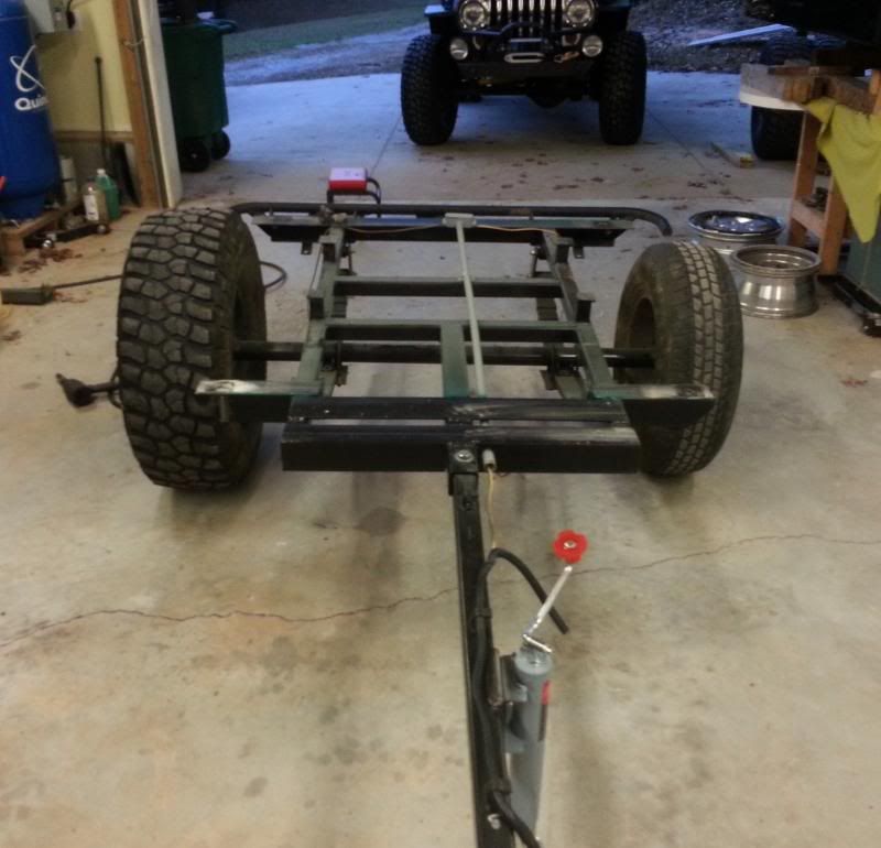

Spring under with one 35 and one 235/75
Spring under with both 35s installed . At this point I was 3" low from sitting even with the LJ .
Torn down and ready for the axle flip . I had the axle built with no crown for this very reason .
Spring over with the 35s left me a 1/2 " to high with the shackles in the shortest position .
The plan is to make new shackle mounts and weld them to the top of the frame . This will allow for longer shackles and a better angle . The other bonus is that it will allow for more height adjustment and this will allow the trailer to be dead level with the LJ . There ya have it the little trailer has grown up to be the Angry trailer on 35s .
